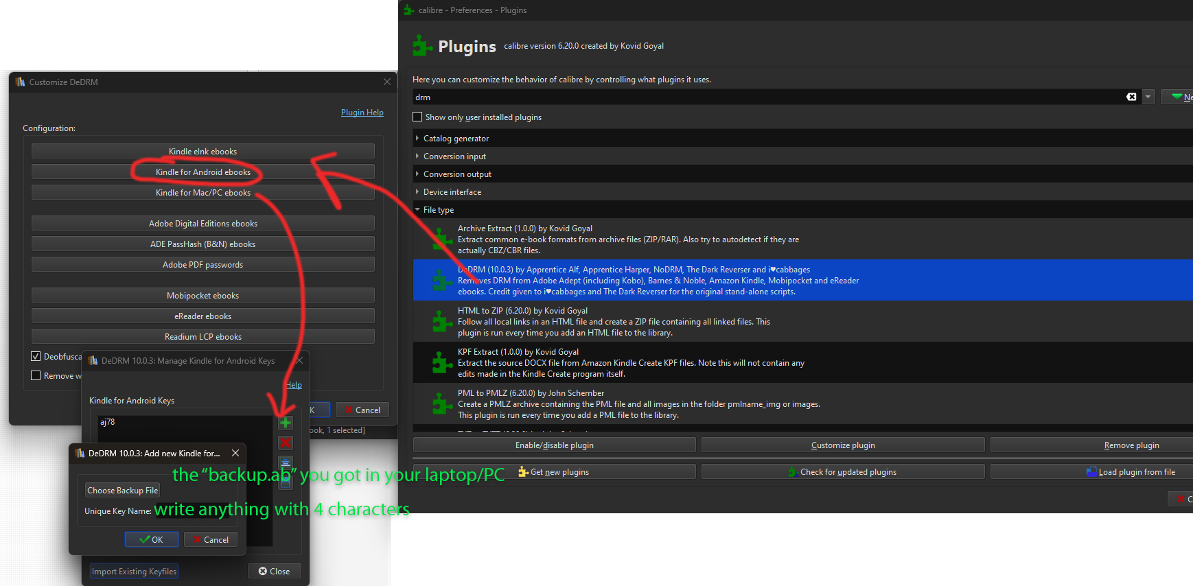

Originally Posted by archz2 View Post
Fantastic! This method really worked well! I found it little intimidating at first. Sharing a quick and dirty illustrated guide for using the 'backup.ab' file to make the process seem less intimidating and difficult.
The image is not showing up somehow
This is the image.
Can't see my posted pos as it has gone for approval. @admins and @moderators, I am enclosing the screenshot as an attachment in this instead of image url. Delete the one which is not working or the duplicate one.

2. Follow these instructions to extract your Kindle key and import to DeDRM.
Hi..I hope you or some of you can help me. I have followed all the points you described. I have a windows 10 pc; I installed Bluestacks; I installed and connected ADB to Bluestacks. I think the connection succeeded because when I go to the Media Menager folder I find the downloaded ebook folders and I can then transfer them to windows. Only the files with DRM protection I can't open them, all the others can. The problem is that I couldn't extract the Kindle key. I installed Calibre, then the 7.2.1 plugin. In the plugins window I opened to the popup window and selected "Kindle for Android Ebooks," then clicked on the green + button and select "Choose backup file." Here I selected the file backup.ab. When I got to this point, however, nothing happens; it doesn't see anything. The backup.ab file is placed on a folder on the desktop where the adb-setup file is located. Yet in /data/data/com.amazon.kindle/ I found the key with "adbkey" and downloaded it to the pc. I tried to select "adbkey" directly from Calibre but it does not see it. Do you have any suggestions? Where could I have gone wrong?
Thanks
