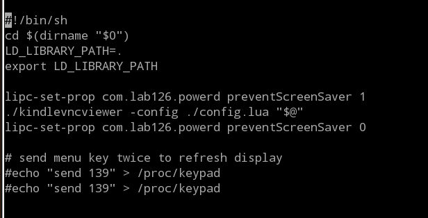

Okay I just tested the script - mine is :0
is yours???? (on my kindle dev = 192.168.1.1 but I unrolled the first call to show this)
[root@kindle kindlevncviewer]# ./kvncviewer.sh 192.168.1.1:2
24/03/2013 11:09:14 ConnectToTcpAddr: connect
24/03/2013 11:09:14 Unable to connect to VNC server
[root@kindle kindlevncviewer]# ./kvncviewer.sh -password yadayad dev:1
24/03/2013 11:11:21 ConnectToTcpAddr: connect
24/03/2013 11:11:21 Unable to connect to VNC server
[root@kindle kindlevncviewer]# ./kvncviewer.sh -password yadayad dev:0
24/03/2013 11:11:32 VNC server supports protocol version 3.8 (viewer 3.8)
24/03/2013 11:11:37 We have 1 security types to read
24/03/2013 11:11:37 0) Received security type 2
24/03/2013 11:11:37 Selecting security type 2 (0/1 in the list)
24/03/2013 11:11:37 Selected Security Scheme 2
24/03/2013 11:11:37 VNC authentication succeeded
24/03/2013 11:11:37 Desktop name "dev:0"
24/03/2013 11:11:37 Connected to VNC server, using protocol version 3.8
24/03/2013 11:11:37 VNC server default format:
24/03/2013 11:11:37 32 bits per pixel.
24/03/2013 11:11:37 Least significant byte first in each pixel.
24/03/2013 11:11:37 TRUE colour: max red 255 green 255 blue 255, shift red 16 green 8 blue 0
.... yada yada yada

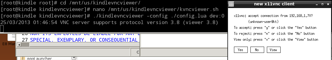

Alright, I've tried the other suggestions and am getting the following output:
[root@kindle root]# ./kvncviewer.sh 192.168.1.1:2
-sh: ./kvncviewer.sh: not found
[root@kindle root]# ./kvncviewer.sh 192.168.1.1:1
[root@kindle root]# ./kvncviewer.sh 192.168.1.1:0
[root@kindle root]#
I get the same messages for the commands related to passwords too.
Also, here are my current VNC settings:
I have a question. Have downloaded the correct kindlevncviewer folder to the correct place on my kindle? When one unzips the vnc hack, one sees a folder named kindlevncviewer. INSIDE that folder is yet another folder named kindlevncviewer. I have the second folder downloaded to the usb root directory of my DX. (I previously had the other one in my root directory and was getting a "...mnt/us..." something error.)

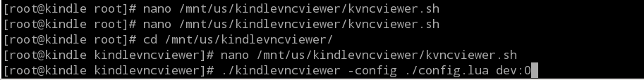

Like I said before.
Stop trying to run the script
And look inside it
run the commands individually.
you are basically "operating blind" at this point - and so are we.
I already typed what the various command in that script "do"
so Ill just show me doing them...
so just turn OFF your password protection for now.
(it's not like anyone is gonna connect without your knowledge inside your internal network, add that later then)
and be CERTAIN from the kindle that 192.168.1.1 IS your PC
port 5901 implies :1 IIRC
so you would
[root@kindle root]# cd /mnt/us/kindlevncviewer/
[root@kindle kindlevncviewer]# ./kindlevncviewer -config ./config.lua 192.168.1.1:1
no script, just that.
if that fails then your FIREWALL is stopping the connection. or the IP is wrong. or you have the port setup incorrectly...
did you try 5900 and :0 like I suggested?
at which point you would
[root@kindle kindlevncviewer]# ./kindlevncviewer -config ./config.lua 192.168.1.1:0

Like I said before.
And look inside it
so you would
