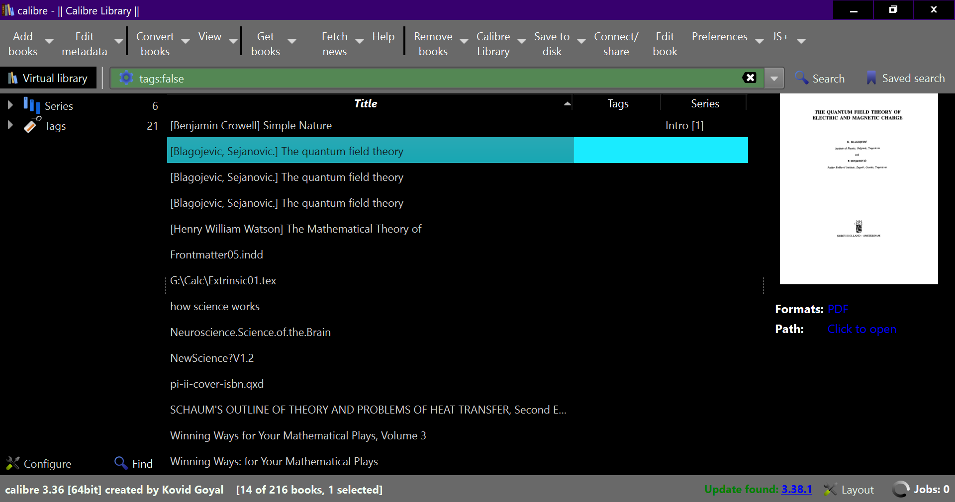

Old 01-21-2019, 03:45 PM   #350
LAPIII
LAPIII began at the beginning.
Posts: 15
Device: PC
Can I change the blue highlighting whatever line I click on in the book list, and the color of the detail's text in the Book details?

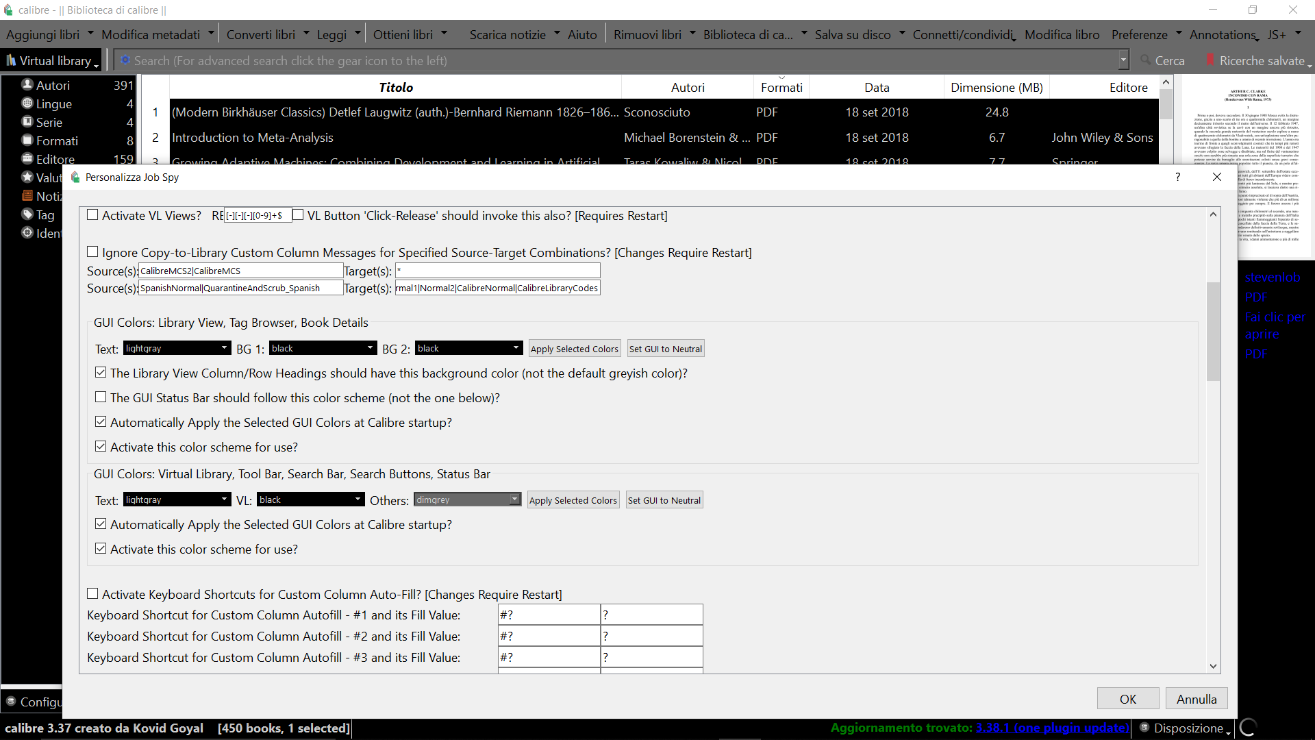

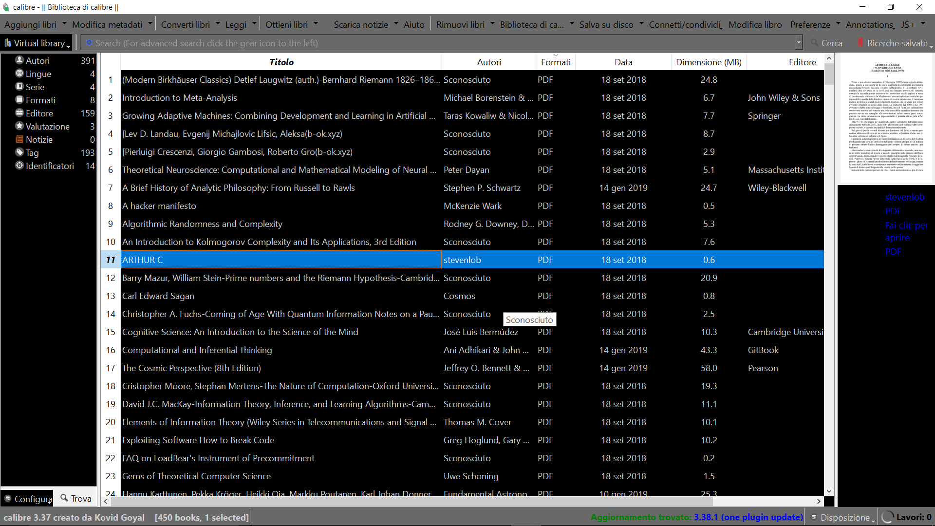

Old 01-24-2019, 10:41 PM   #351
calp
calp began at the beginning.
Join Date: Jan 2019
Device: Tolino Shine 4 HD
Dark Mode
Hello there! I've started using your plugin since I needed a dark theme. The perfect look for me would be like the one from the user above, yet, when I tried replicating his settings (calibre-settings.png), here is what I got (calibre.png)
Any advice?
Thanks!

If the difference is not due to different JS settings, then likely it is due to differences in the Calibre > Preferences > Look & Feel settings for "User Interface Style" and/or the Operating System (Qt works differently in Windows than OSX). If you both are in Windows, then it could be due to how each of you has personally customized Windows for colors, display settings, etc. That is all I can offer.

First of all, thank you so much for taking the time to answer me.
I agree with you. In fact, knowing that Calibre's developer said quite a few times that Calibre's dark mode should be present when Windows 10 is set on the dark theme and that, whatever I did, I could not get it to work, I now guess it is related to Qt. Unfortunately, the advice given (compiling from source) by Calibre's developer is, I am afraid, beyond my capabilities. I will just leave her a few of my settings, in case Advice Pro sees this post and can (if he has time) to provide his.
OS - Windows 10 1809 dark theme (it is working, explorer has black background).
Calibre main interface setting - System predefined.
JobSpy settings as above.
If anyone else has any advice I would really appreciate it. In case more detail are needed just let me know.
Update: I've finally found a solution. It turns out one needs to enable the high contrast mode in the Windows theme settings. Once you do that, you setup custom colors for text background etc. For those that have the same problem, with Job Spy, custom High Contrast colors and the dark theme, I was able to get a result very similar to the one posted by AdvicePro.
