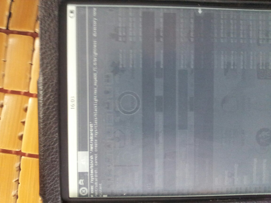

Hi All.
Fist thanks to every one make this real. My kobo glo now run dual boot perfect.
I try to Kill the Screen LEDS
by Code:
#!/system/bin/sh
echo 0 > /sys/class/backlight/mxc_msp430_fl.0/brightness
But it say: " directory none existent"
What is wrong??? How can i do?
EDIT: NOW I CAN DO IT BY COPY CODE AND SAVE it to XXX.SH in Windows (notepad ++)
BUT HOW I CAN MAKE A SHORTCUT TO TURN OFF WHEN I NEED?
AND WHAT IS "DISPLAY BRIGHTNESS" APP?, WHAT IS "MOUNT SD CARD" APP? ANYONE CAN UPLOAD THESE APPS? BECAUSE I CANT FIND THESE APP.
THANKS
Which code :
#!/system/bin/sh
ioctl -d /dev/ntx_io 127 0
Now I can turn off the led blinking

How i can replace these files? Because in the Kobo Android, when i replace, it denied.

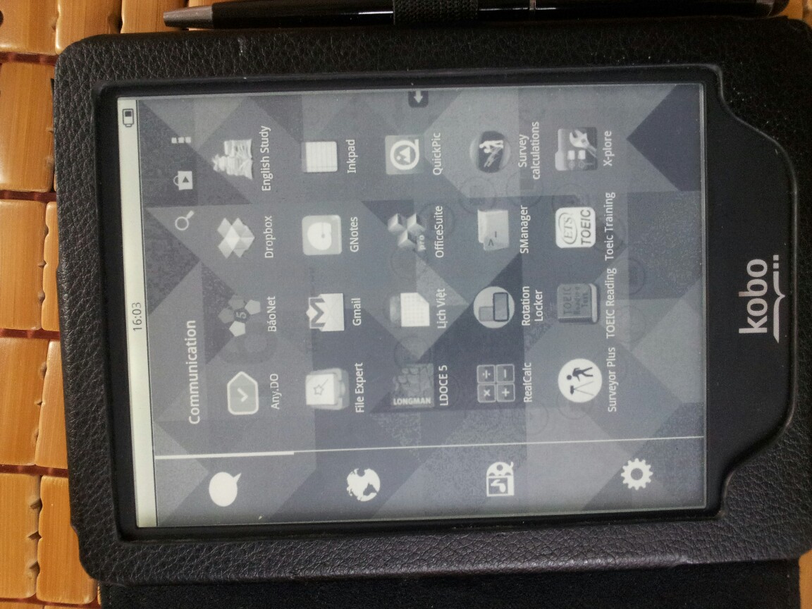

oh, Thanks Embryo.
With me, minimum Brightness is enough. ��. I want a app can turn off "Back light" like the script.Or can i creat a shortcut to run the script?
And have you try Adfree app? I run it but it cant replace host file. ��
I use "X plore" for File manager.
I can use Office suite (ver 6.), InkPad..etc ( You can see the pics, Any do is old version)
PS: I have found the app i need. That is Gscript, it is open source, and can made shortcut to desktop for run the script.
link
https://bitbucket.org/Equidamoid/gsc...pt-android.apk
Thanks everyone, thank Android, Kobo Android perpect now ��
I attached the scripts here, if anyone want use, Un zip it and copy to sdcard, brower by Smanager.
I suggest use Gscript, it more easy than Smanager, but it don't have an option to make the script auto run on start.
File Type: zip SCRIPT.zip (439 Bytes, 255 views)
