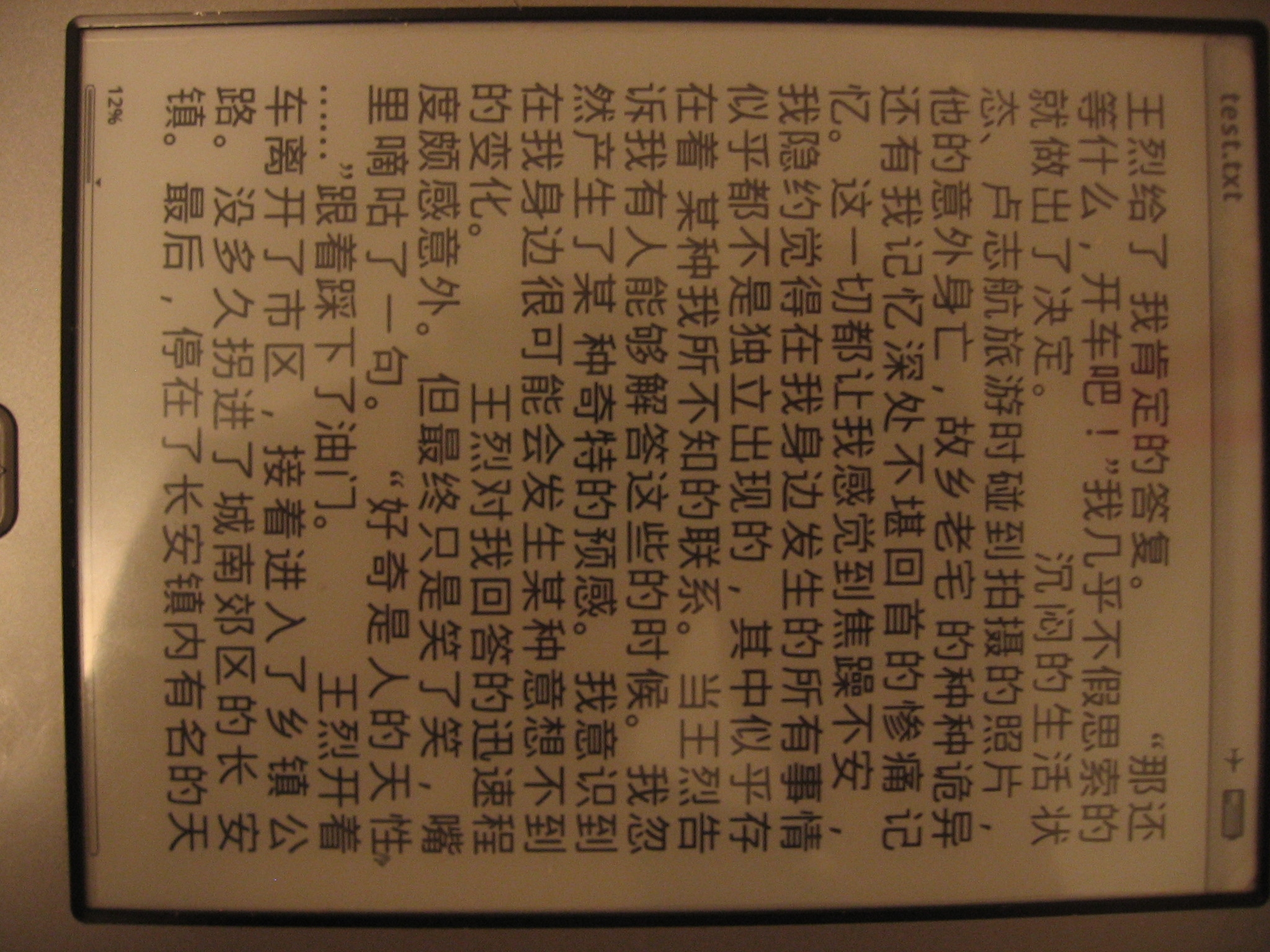

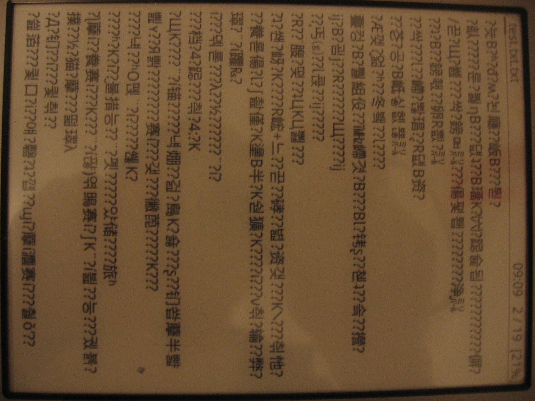

Can you give more specific details than 'broke' please.
htm/chm documents don't display chinese characters properly. it's limited to Librerator only: if i change the extenstion from .htm to .txt. Kindle native reader can read it without problem, while in librerator, it's still the same garbage characters.
first shot from librerator
second from kindle reader
ID:	144529   Click image for larger version

Different font files.
See if you can get Librerator to use the same font file as the native reader.
From the first post of this thread:
You can set not only document font as default (like in KPV), but also font size and line spacing.
