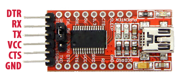

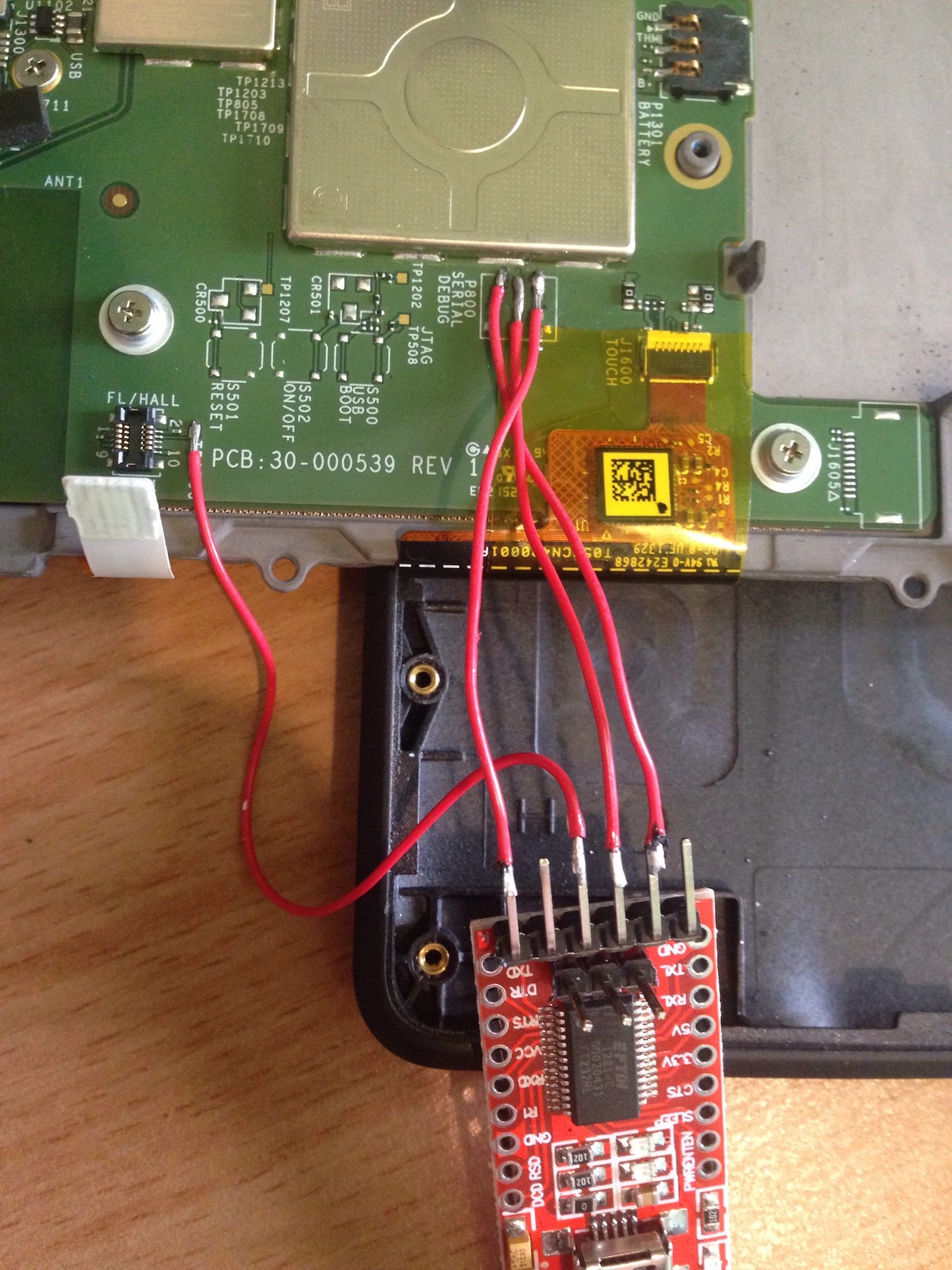

Originally Posted by datanoise View Post
Jim's Board doesn't seem to be available currently, is there another recommended option?
Would something based on FT232RL work fine? I assume it would, as long as it's possible to set it to 1.8v...
You can also use a FT232RL which costs only 1.5$ (shipping included ) from eBay or Aliexpress.
This one:
To make it use 1.8v you will have to remove the jumper completely.
I have done my PW2 with it, and also in >this< thread I recommended it to another guy, which also done it successfully.
