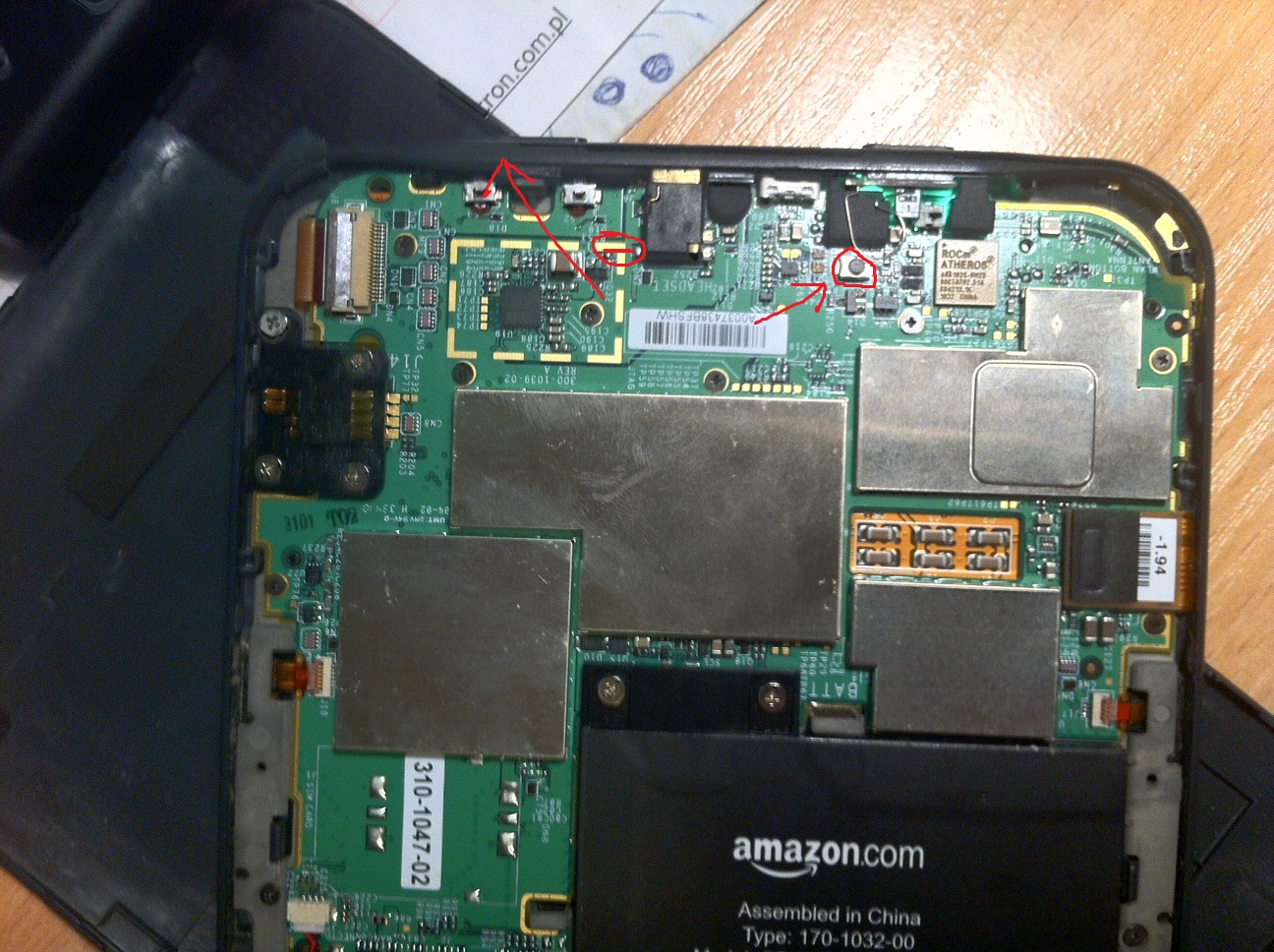

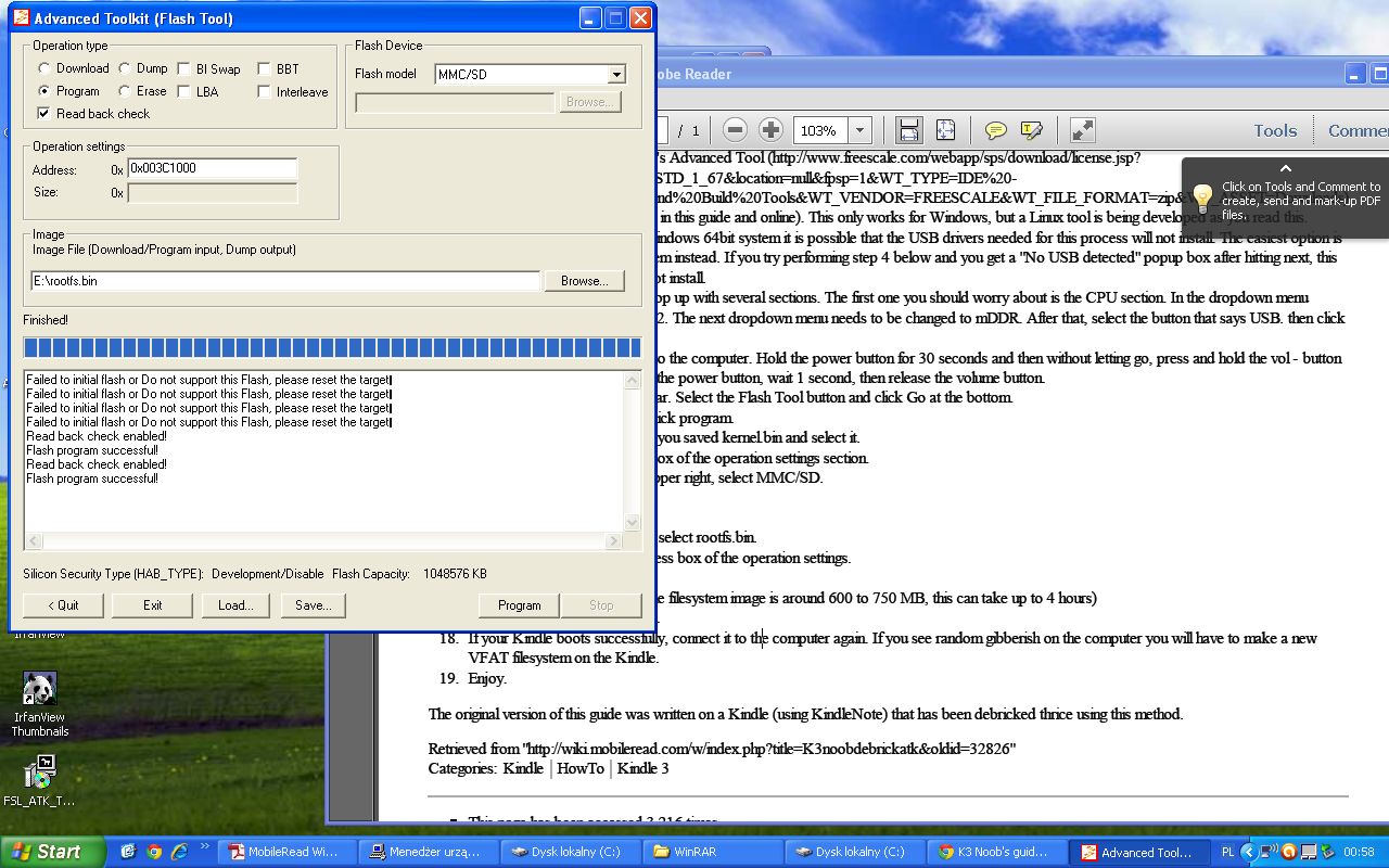

Hi after reading the whole thread I almost lost hope to pass by this error.
It turned out that once you open the back cover of the kindle, theres a small secondary reset/power button beneath the original power button on the board.
What to do?
1) open your kindle and plug it in to the pc
2) set everything in ATK as you would to flash the kernel
3) press the little bugger while holding the vol - button (in my case 3rd press worked the charm)
4) press program in ATK
After few tries it should start working (the rest is like in the original tutorial)
one pic shows where is the magic button
second is a proof that in my case it worked ewentualy
ps. Thanks for the tutorial it got me my Kindle back from the dead !

What model Kindle is that?
Once I stood on my head, I recognized it - that is a K3
My K3 does not have the button but the circuit board has the pads for it and the silk screen has the legend: "reset" at that part position.

Sorry forgot to mention, yes it is a K3 Wifi B008 from 2010. Wonder if short circuit this place on board would have the same effect. With mine unit the problem was as other have mentioned earlier, 90 seconds reset, no reaction on screen, and that ATK (winxp32bit) would recognise it as MX35 from the moment it was pluged in the usb, but refusing to flash and no reaction to holding power button for 30 sec and vol-, even removing the battery didnt have any effect on the process, it worked the moment I started playing with this reset button.
Yup, I would expect it to still work and that Amazon just saved the cost of buying a few million push buttons.
(When buying in lots of a million parts, even 0.1 cent adds up to real money in a hurry.)
Note: It will take a very steady pair of hands and some needle sized probes to connect to these pads - they are not very big.
Maybe someone with an open K3 can test if the reset pads still work (there might be a few other parts involved that are missing from the reset circuit - not just the missing button).
