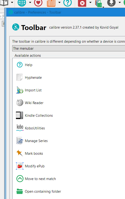

No "KindleUnpack" icon shows up in calibre
I have setup a completely new calibre environment after installing Win 10. The "KindleUnpack" plugin had been installed on my previous computer and ran flawlessly for some years.
When installing the "KindleUnpack" plugin in my new calibre environment several things happen:
- Installation via preferences places <KindleUnpack - The Plugin.zip> in "C:\Users\myname\AppData\Roaming\calibre\plugi ns"
- there is no icon in the main toolbar nor is the icon available at all for choice

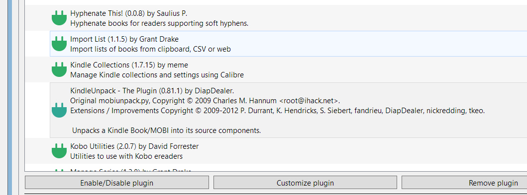

- trying to customize the plugin (yes - it is visible in the list of installed plugins) results in the request to restart calibre first etc. After this the same request pops up every time I try to customize.
All other plugins for calibre installed without problems.
Is there any prerequisite which I overlooked?

Sure - even after restart of my laptop it does not appear in the icon list of calibre. Here some snapshots.
I believe that there is something fundamentally wrong in my setup - but what?
Klaus

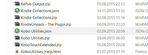

P.S. Just found out that the corresponding java file (json) is missing in the "C:\Users\MyName\AppData\Roaming\calibre\plugi ns" directory. I have no clue with Java scripts ...
That's not a java file it's a JSON file. That's where the preferences for plugins are stored/retained. It's normal for it not to exist until the plugin is run/configured for the first time (which yours hasn't).
