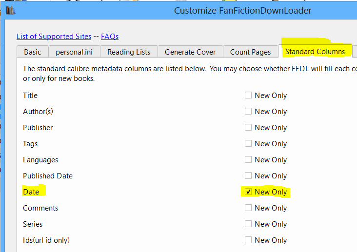

it will sound stupid but i still don't know how to add a simple column like "added"
i have normal 2 : "modified" and "published" both help me
published = original publish date from the epub
modified = as i read fanfiction i can see when i updated something
but i lack simple "added" that will show me when i added the story to calibre,
"date" has the same date as "modified"for me
should be:
"modified">"date" for updated story
"modified"="date" for new story
should be:
By default, FFDL updates calibre's 'date' column (internally 'timestamp') when ever the book is updated.
However, it's very easy for you to configure FFDL to not update the Date field. Go into FFDL config, on the Standard Columns tab and check 'New Only' for Date. See attached image.
I believe that will make it work the way you want.
thanks, i will see if it will solve the issue
but should it be the default option to avoid the problem in the first place
there shouldn't be a reason for DATE to be updated on updating a file that is in calibre
iakovl is offline
