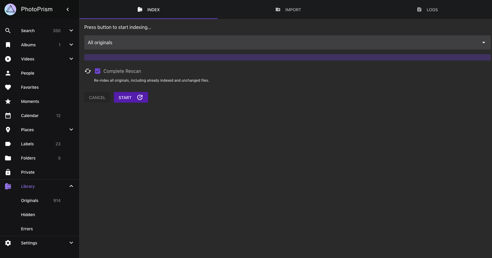

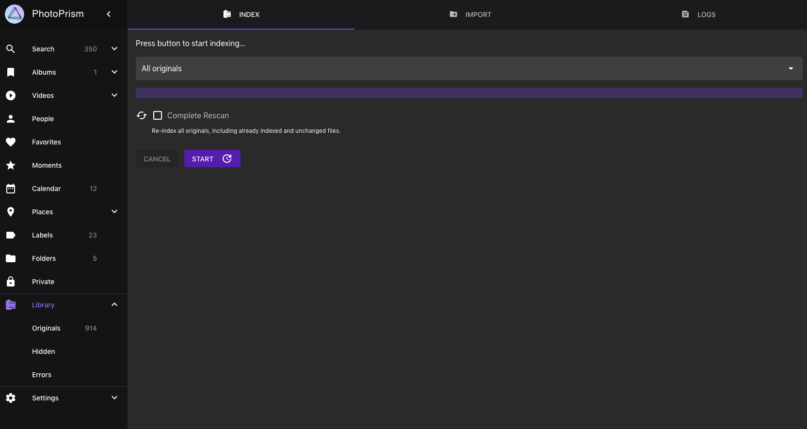

@huber70
Photoprism worked and then it did not.
- What went wrong?
- As what user (pi/root) did you type sudo docker-compose up -d ?
This means your "Originals" directory is probably under /root. (not pi).
You must now also have a mysql docker image/container. Is it running?
What is the output of: docker ps -a and docker ps ?
The line
- "~/Pictures:/photoprism/originals"
in the docker-compose.yml file points to where you should put the photo directories. Check if they are there (/home/pi/Pictures or /root/Pictures)and then see attachment.
To test put only a small test directory in /home/pi/Pictures
then press the button to start indexing........... (takes forever, that's what I hate)
Name:	Screenshot 2023-07-10 at 23.22.07.png

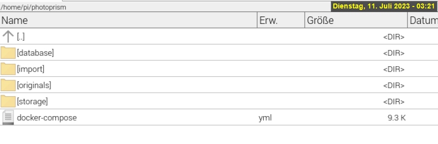

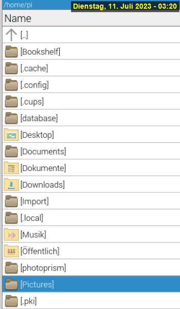

"what went wrong"? Good question: after 2-3 days of correct working I wanted to add 2 new folders within the "Pictures" directory that photoprism did not indexed, then I made some trials that went wrong and I observed that my library suddenly became less and less and less ...
The Pictures are not under /root, but /pi/Pictures (as it was when it worked, did not move it)
For now, I left the "Pictures" directory with its full content, for trials I added directory "Pictures2" with just one folder, changed the docker-compose.yml accordingly: nothing
I use still SD-card (+USB-SSD), no problem so far

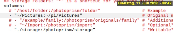

@huber70
1 - the pictures come from the new install of photoprism (NOT of the older)?
2 - there are 2 containers running mariadb; there should only be one (1). I would docker stop pi-mariadb-1.
3 - the line in docker-compose.yml should be:
- "/home/pi/Pictures:/photoprism/originals"
not
- "~/Pictures:~/pi/pictures"
that can never work.
4 - the line in docker-compose.yml could be:
- "/home/pi/photoprism/storage:/photoprism/storage"

3) 4): confuses me: "should be" / "could be"
volumes:
# "/host/folder:/photoprism/folder" # Example
- "/home/pi/Pictures:/photoprism/original" # Original media files (DO NOT REMOVE)
# - "/example/family:/photoprism/originals/family" # *Additional* media folders can be mounted like this
# - "~/Import:/photoprism/import" # *Optional* base folder from which files can be imported to originals
- "./storage:/photoprism/storage"
is this correct?

@huber70
1) OK
2a) sudo usermod -aG docker pi etc.
2b) try sudo docker stop pi-mariadb-1
3a) should > - "~/Pictures:~/pi/pictures" = can never work.
3b) could > - "/home/pi/photoprism/storage:/photoprism/storage" = my suggestion
I would do:
- "home/pi/photoprism/storage:/photoprism/storage"
Before you do docker-compose.yml up -d
docker ps -a should be empty!
mariosipad is offline   Reply With Quote
