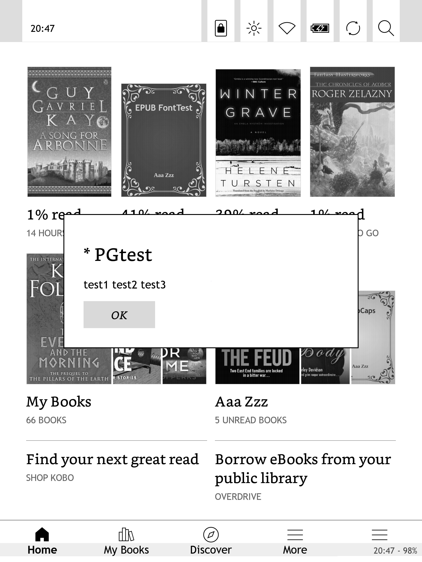

I think I may have figured out what you meant. The following menu item results in a pop-up display shown in the screenshot.
menu_item : main : * PGtest : cmd_output : 500:echo test1; echo test2; echo test3
OK, thanks. I guess it's an issue in the way the output is shown. I'll look into that as soon as I have time (feel free to open an issue on GitHub).
