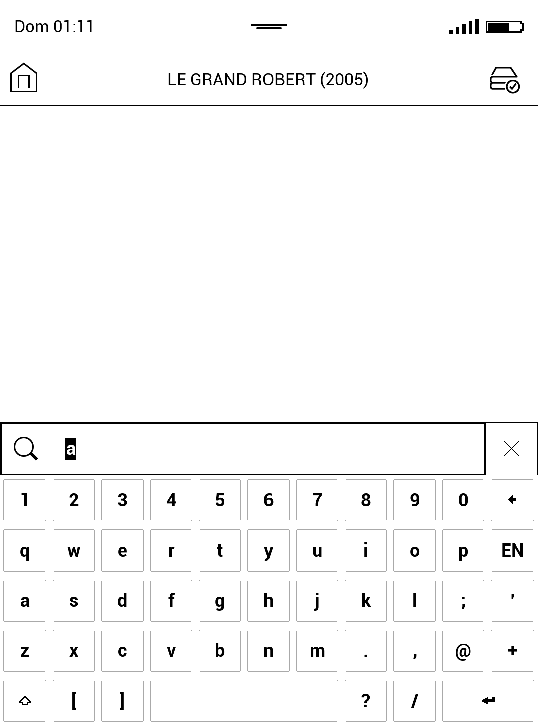

Originally Posted by Markismus View Post

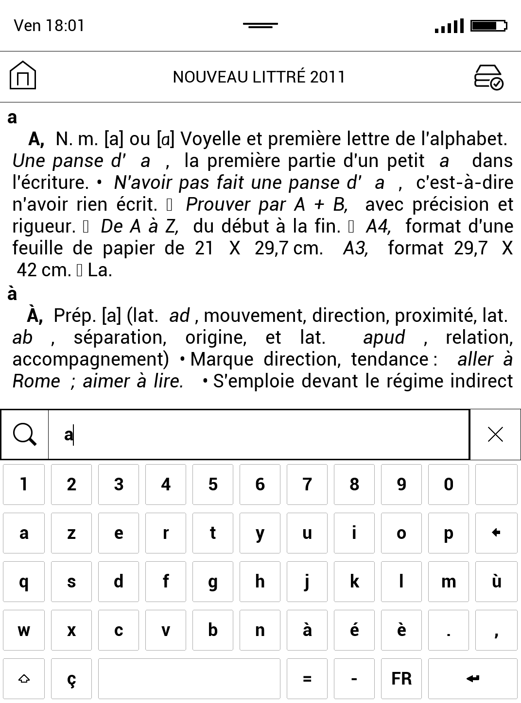

Could someone else test the Le Grande Robert dic-file?
They are both nonfunctional for me in the dictionary application. With the .fr I can get a keyboard and can type, but get blank screens as search results. With the .fre, I only see some oddity instead of the keyboard, can't input characters and can't search; the only interaction I allowed with the app is about changing dictionary. Attached a screenshot of the latter, and for comparison the Littré which is ok.
In KOreader, the .dict looks fine.
ID:	215102   Click image for larger version

Ditto for me, no juice. I've tried with the big one alone installed,with the three of them together, with both halves and with the first half alone on the SD.
I wouldn't rush to blame the size. I see that I have on the SD the "old" Littré, littre_pocketbook.dic (probably the one coming from ebookgratuits), which is 33.7MB and works.

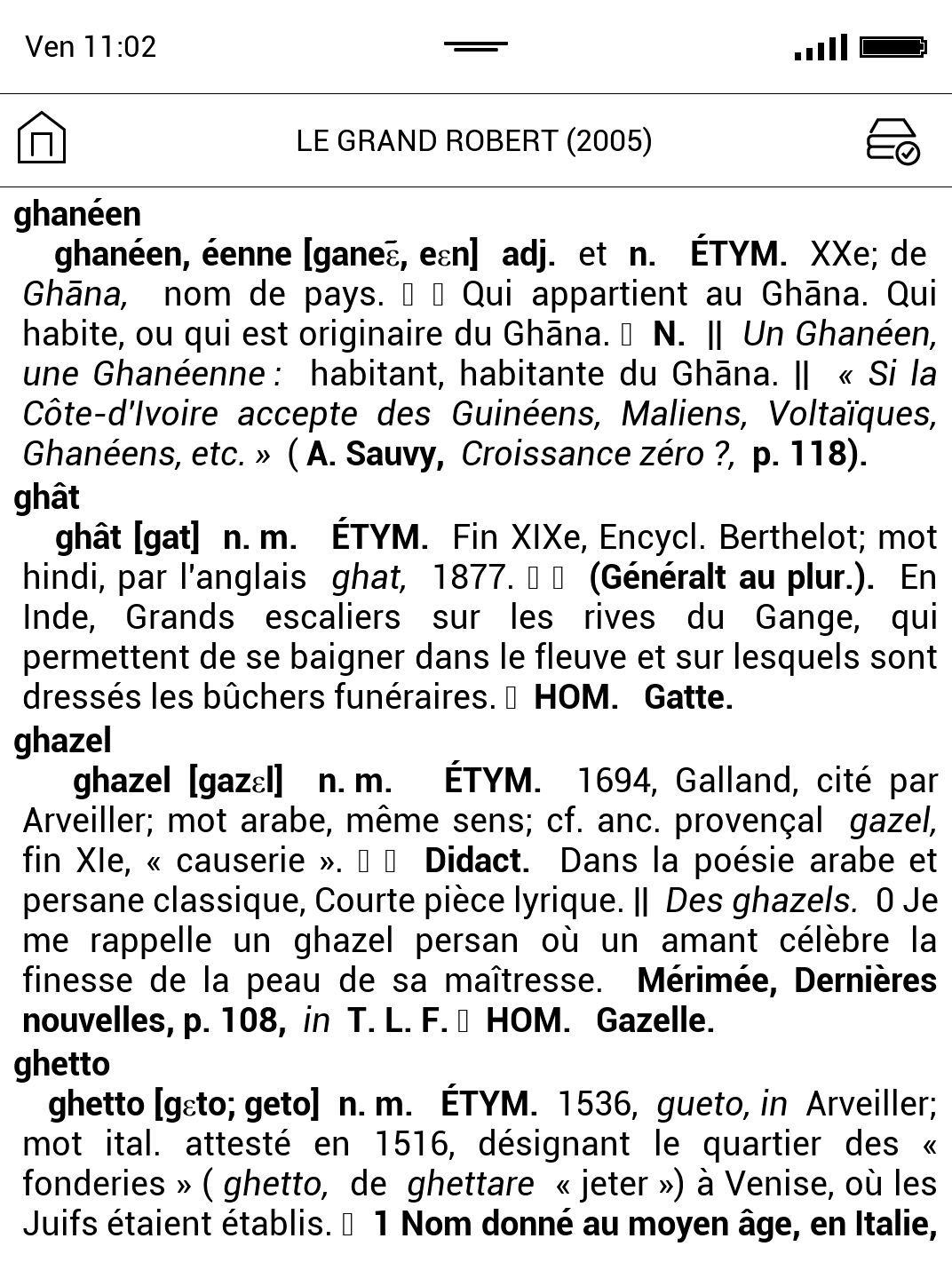

I've tried the first one (i.e. the not strippedtags), and it appears to work perfectly in the dict app and in the reader. Great. Any reason I should look also at the other one?

Also the stripped works for me. The unstripped renders a bit more spaced, see the shots (the first one is strippedtags); I can't say whether this is because the conversion added spaces, or because of missing font support. I note the annoying [] in this and other dictionaries; I never bothered to search whether with my old firmware the font used by the dictionary app is configurable somewhere, so to choose one with additional dingbats, whatever they could be.
ID:	215256   Click image for larger version

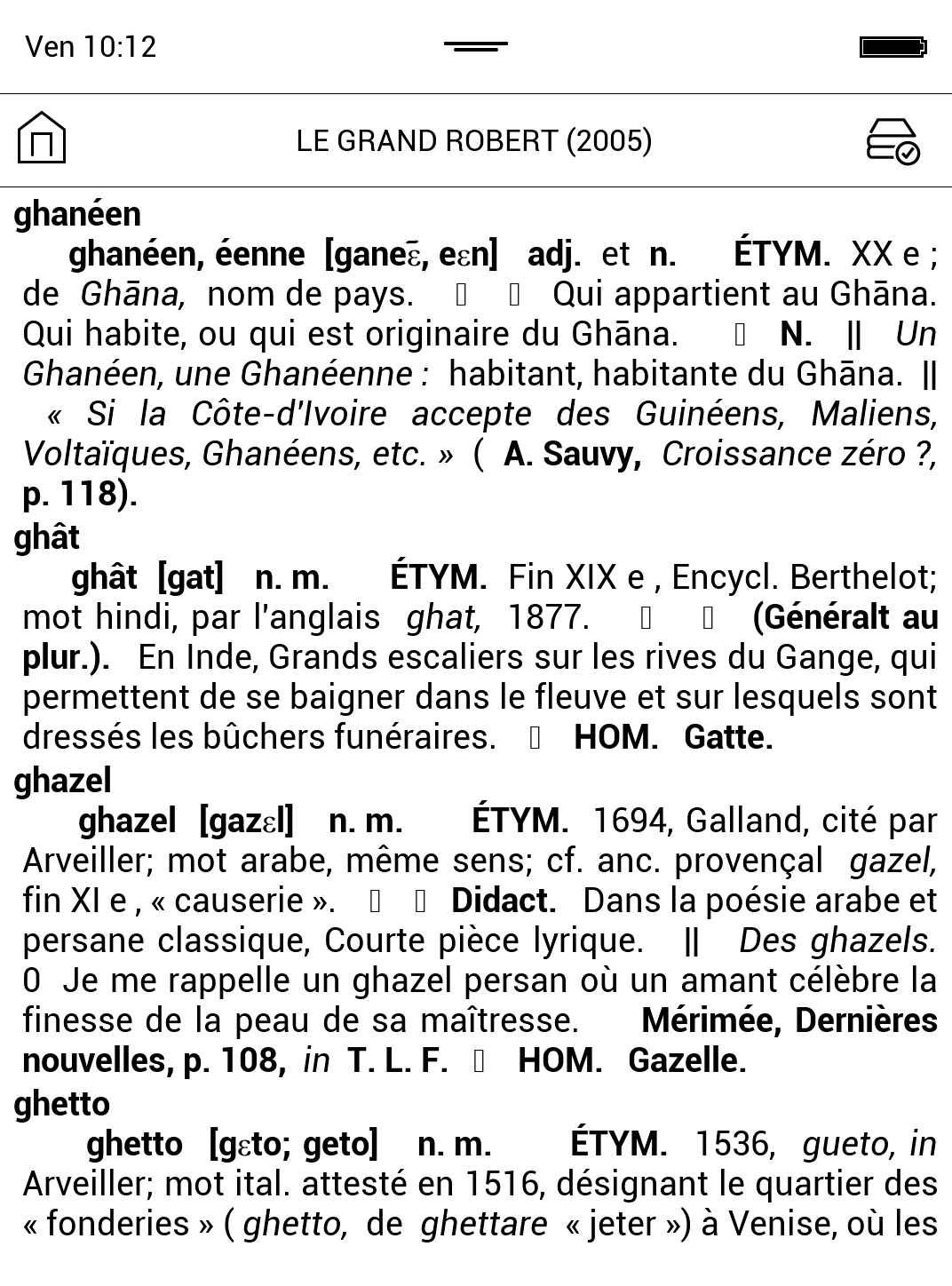

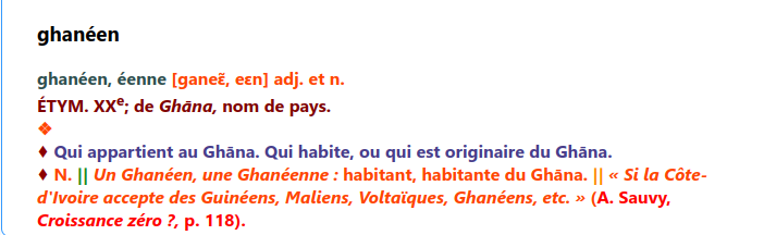

In this case the not displayed characters are UTF-8 characters, but they are availiable as ASCII characters.
❖: U+2756 : BLACK DIAMOND MINUS WHITE X
♦: U+2666 : BLACK DIAMOND SUIT -> ASCII value: 9830
But you're right that they're in the dingbats block.
So I am stipping too much. Seems like an identation difference. Could be that blockquotes are not stripped.
Name:	Screenshot From 2025-04-25 10-49-50.png
