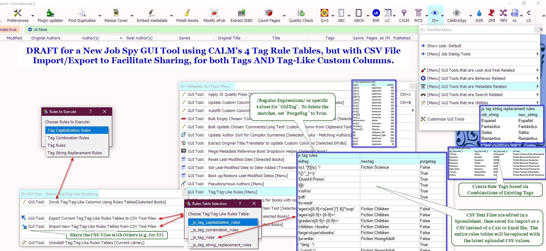

DRAFT for New GUI Tool to Scrub Tags & Tag-Like Custom Columns
This new tool (see the attached image) will add the best parts of the CALM plug-in functionality for standard Tags to Job Spy, but for both Tags and Tag-Like Custom Columns.
It will not use CALM's GUI-based maintenance of the various rules tables, since that does nothing to facilitate sharing huge numbers of rules (e.g. for FF). Instead, it will use the concept that I used with the Pseudonymous Authors GUI Tool: importing/exporting of CSV files (maintained in Calc or Excel) that can be shared with others.
Just started, so this is a work in progress.
DaltonST

Version 1.0.133 Scrub Tags/Tag-Like Columns
Version 1.0.133 - 2018-10-09 Scrub Tags/Tag-Like Columns
See all of the attachments.
The .zip that is attached contains an .xlsx file and its .ods version that have 7 "sheets". Please read the "Instructions" sheet.
DaltonST
