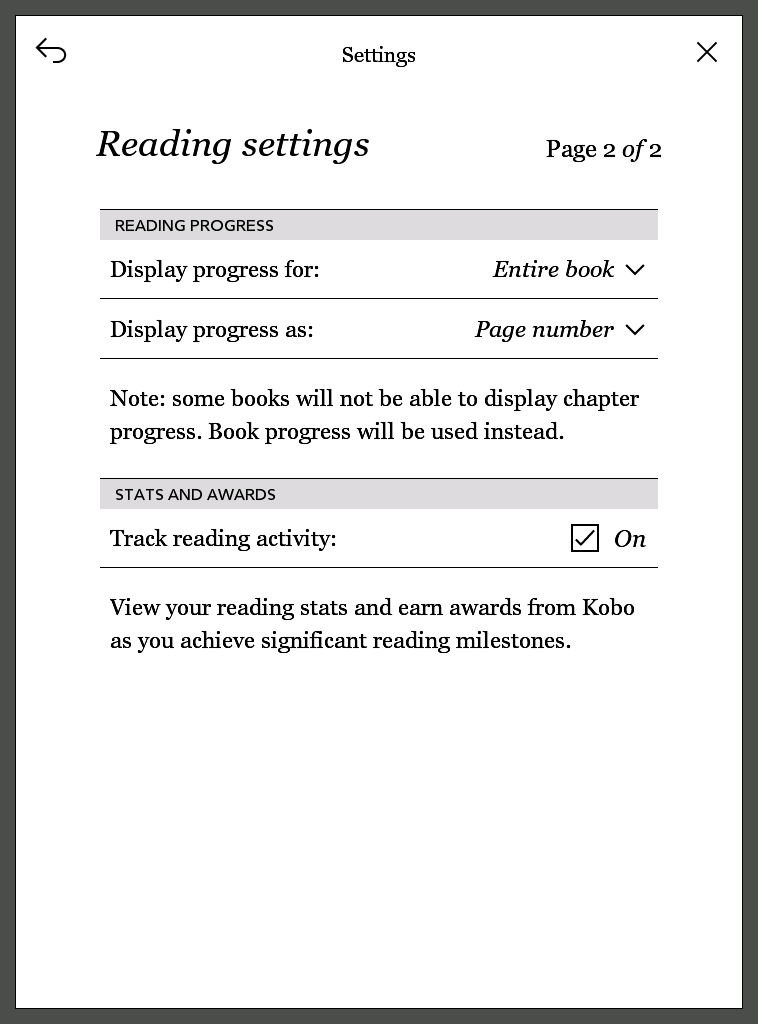

They are on the Glo (and other devices) too, swipe to turn to the second page of reading settings:
ID:	130794   Click image for larger version

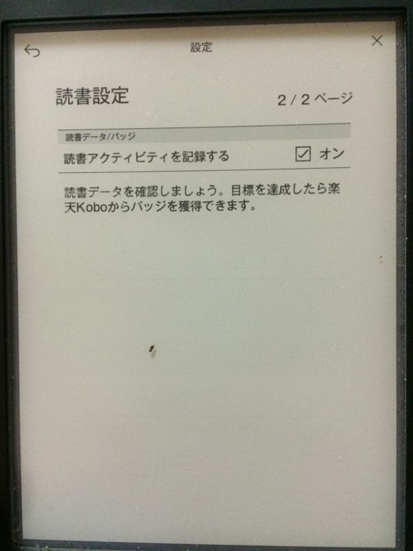

Thanks, that I have checked already many times, not there.
norbusan is offline   Reply With Quote

It may be that your affiliate has disabled some features. The usual suspects for this are Rakuten and FNAC.You could try to change your affiliate by editing the .kobo/affiliate.conf file and changing it to Kobo, but it might reset back to the original affiliate after a firmware upgrade.
Edit: It could also be that the UI is set to Japanese? There were some changes in this firmware that make the device behave differently when the UI or book is set to a locale for the Japanese language.
Last edited by GeoffR; 11-09-2014 at 03:33 AM. Reason: Japanese locale behaves differently in 3.11.0

Thanks,
Edit: It could also be that the US\I is set to Japanese? There were some changes in this firmware that make the device behave differently when the UI or book is set to a locale for the Japanese language.
Indeed indeed, I have changed the locale to English and now the options appear.
Interestingly, it is *only* the UI that changes. After adjusting the options, switching the language back to Japanese, the options are still in effect.
Thanks a lot - I didn't know that the UI language has effect on functionality - very strange.
