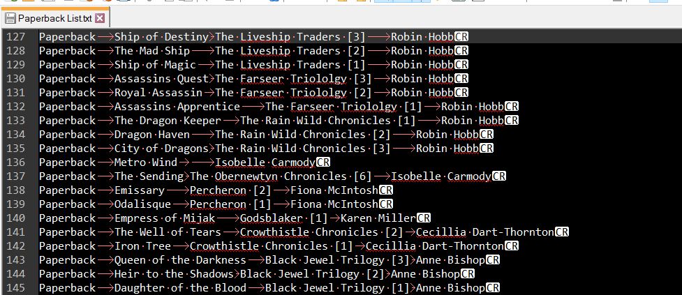

@theducks - IMO those Macintosh line endings (CR) are line endings, not separators. What would create such things in 2018, apart from Visicalc on one of these
@Inukami - I changed the Mac Line ends to Unix Line ends, give the attachment a try.
Attachment 162266
I realize they were not a 'proper' CSV separator. It almost looks like someone saved a PRINT FILE, rather than a spreadsheet CSV) export.

Notepad++ shows (many) 'Macintosh CR' used between columns (fields).
Not sure where you are seeing this. I only see "CR" at the end of the line. There is a "Macintosh CR" in the status bar, but that is indicating the line-ends used in the file.
Tab or comma are commonly used delimiters. The fact I could SEE columns in the fake CSV, means they are used as variable padding between fields. a true CSV looks like "","","",, when there is no data
The file is using tabs for the delimiters. And one of the reasons to do this is to avoid needing to enclose the data in quotes if one of the other delimiters it used in the data.
Much to my surprise, what @Inukami has done for the series works. It doesn't display correctly in the dialogs, but, when the books are created or updated, the series name and index are correct.
I am seeing this(repeated) between fields (appears as a gap) . I would have expected A Tab or the traditional comma
I don't think NP++ replaced a TAB with these. we are talking 4 or 5 in a row

@theducks - my screenshot is Notepad++, the pink arrows are tabs. I have View->Show symbols->Show all characters and Show indent guide checked, and Encoding set to UTF-8.

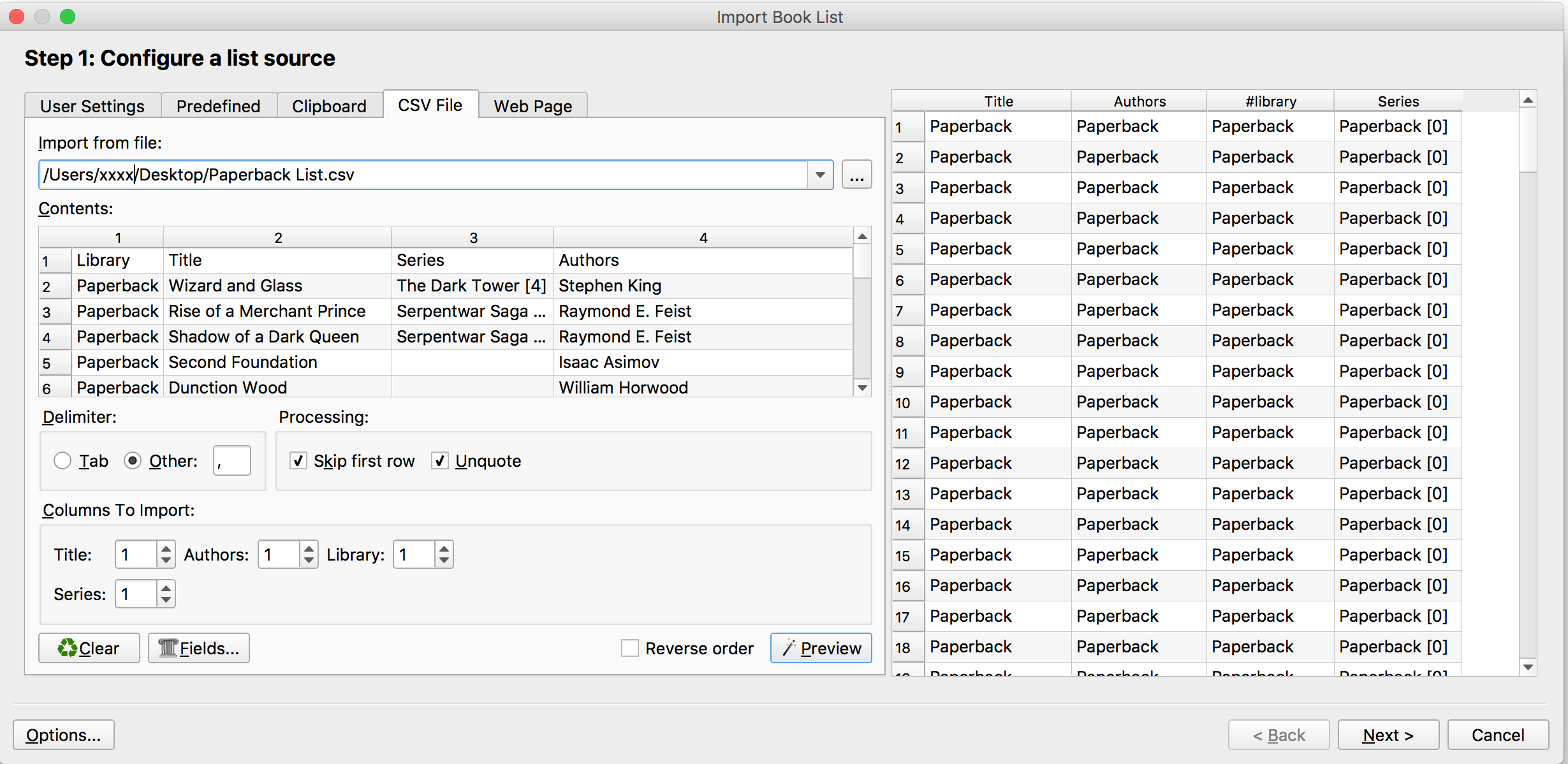

Attached is a beta that should fix the problem that @Inukami has reported. The problem is the mode the file was opened in. As noted, it has Mac style line ends which wasn't being handled by the way the plugin was opening the file. In the attached beta, I have changed this to "universal mode".
I haven't done much testing. I works with the posted file and is still working with several other test files I have.
@davidfor, @theducks & @BetterRed - Thanks for all your help. I think I downloaded the beta and the good news is that it now opens the CSV file but still not in the right format. Unfortunately all your discussion about CSV file formatting does not compute. I also tried @BetterRed attachment, but I also ran into a similar problem. When I try and import the list I get the following in the screenshot. As you can see on the left in contents it looks right but on the preview on the right, it looks very wrong. Am I doing something wrong? Or if I import will it look like the left and don't worry about the preview? Maybe I have set it up wrong...
The way I made the file was I originally had the list in Excel for Mac. I then changed/saved the file into a CSV. Nothing too weird I hope...
NO ISBN When I added my paperback collection, way back when. I used Add from ISBN. (I happened to use a barcode Wedge scanner, to input those to AFI in groups of 20, so I could deal with errors)
I thought that as I didn't have many that I would need to check cover and meta anyway so that was enough information for Calibre to recognise the books. These are also the last of my paperbacks as shifted to eBooks from 2012. I thought it wouldn't take that long to import, but as you can see I have run into problems with importing the file. It might have been easier to just put them straight into Calibre when I was putting them into the spreadsheet originally, not sure why I didn't do that.
I do also have a huge manga library which I think I'm just going to use an app on my phone (Bar-Code Reader seems to be okay) to scan and paste the ISBN into Add Books from ISBN as they are all in Japanese but haven't got to that project yet...Too bad Calibre doesn't allow you to enable the computer camera to scan in books (read the posts as to why Kovid doesn't want to do this).

The poor plugin is doing what you're telling to it. The configuration says:
  • Title: Column 1
  • Author: Column 1
  • Series: Column 1
  • Library: Column 1
It should say:
  • Title: Column 2
  • Author: Column 4
  • Series: Column 3
  • Library: Column 1
Old 02-14-2018, 09:00 AM   #330
  • Title: Column 1
  • Author: Column 1
  • Series: Column 1
  • Library: Column 1
It should say:
  • Title: Column 2
  • Author: Column 4
  • Series: Column 3
  • Library: Column 1
Whoops. Silly me. I obviously didn't know how to use it correctly. All perfectly imported now! Thank you very much @Terisa de morgan for getting me to the end point and @davidfor, @theducks & @BetterRed for everything before. :-)
