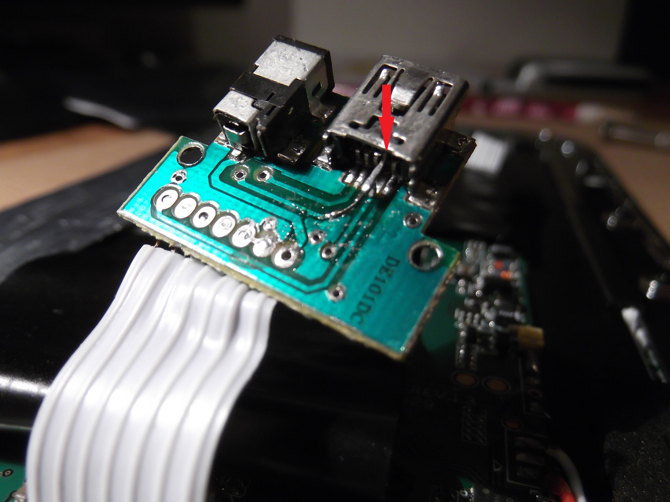

Mine has all 5 pins installed.
Dale
AHA! Thank you!!!!
Sooo, you are able to get PC to see your reader and have 5 pins (just confirming to myself here ), well, my project just began! Will update what will be!
Also, please post if your reader has 4 pins (like mine or so) and you can connect to a PC, just in case

I have the black Literati and it also has 5 pins and can connect both via USB and WiFi.
It looks like you are missing pin 2 which should be the data - pin and that would definitely keep you from connecting.

The usb standard only has 4 pins. The mini usb port has 5 pins but 1 of them is not connected. If you look at the plug with the large part on the bottom, it will be pin 4 starting from the left. If that is the one missing, it shouldn't matter.
Well, i opened and i found 1 pin was pushed in and broken (cheap soldering), so now i'm buying broken reader so i could replace all that small usb/power board(?). All pins have destination to a wires on white cable, so it matters. Do you have 4 pin usb and working one?
