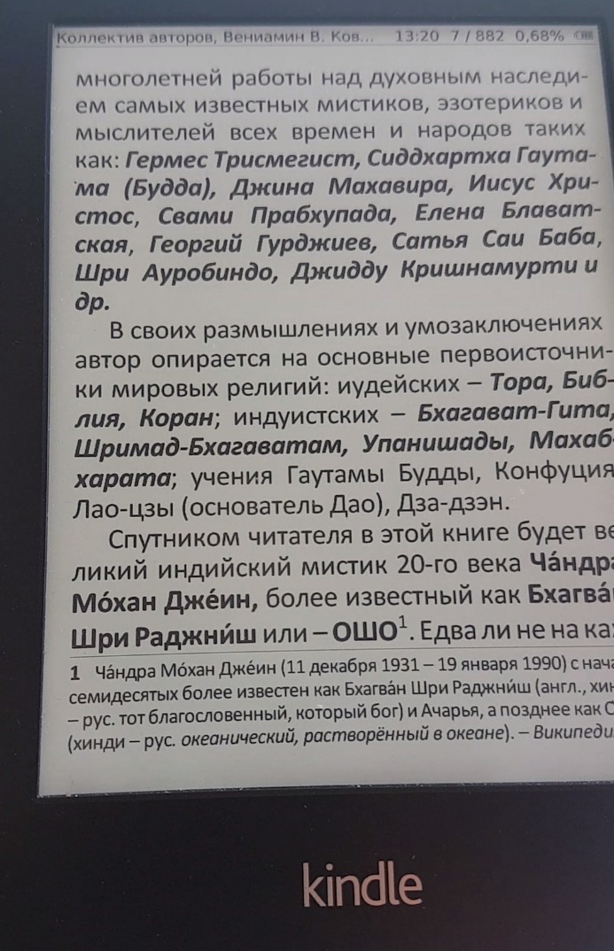

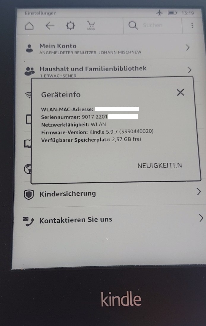

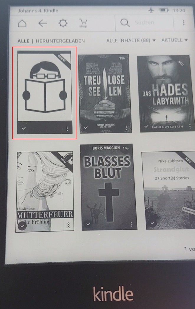

hius07 ought to be getting tired of karma fortunes by now.hius07 ought to be getting tired of karma fortunes by now.hius07 ought to be getting tired of karma fortunes by now.hius07 ought to be getting tired of karma fortunes by now.hius07 ought to be getting tired of karma fortunes by now.hius07 ought to be getting tired of karma fortunes by now.hius07 ought to be getting tired of karma fortunes by now.hius07 ought to be getting tired of karma fortunes by now.hius07 ought to be getting tired of karma fortunes by now.hius07 ought to be getting tired of karma fortunes by now.hius07 ought to be getting tired of karma fortunes by now.
Posts: 1,196
Karma: 3592927
Join Date: Sep 2014
Location: Ukraine
Originally Posted by Antinoos View Post
This should work, but I definitely recommend NOT to use any 5.9.x fw version for PW3.
I've just found out that the kindlets support on PW2 remains even in 5.9.7.
CoolReader is being started via azw2.
ID:	166035Click image for larger version
ID:	166036Click image for larger version
