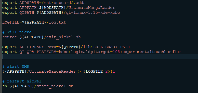

Originally Posted by lazybandgeek View Post
I got mine working by moving to the newer version of the software that Officer released. Then enabled the experimental touch stuff. Which mostly works, except for the keyboard issue others are seeing. But more than usable for me.
I've attached my current .sh for UMR can you tell me what I'm missing?
