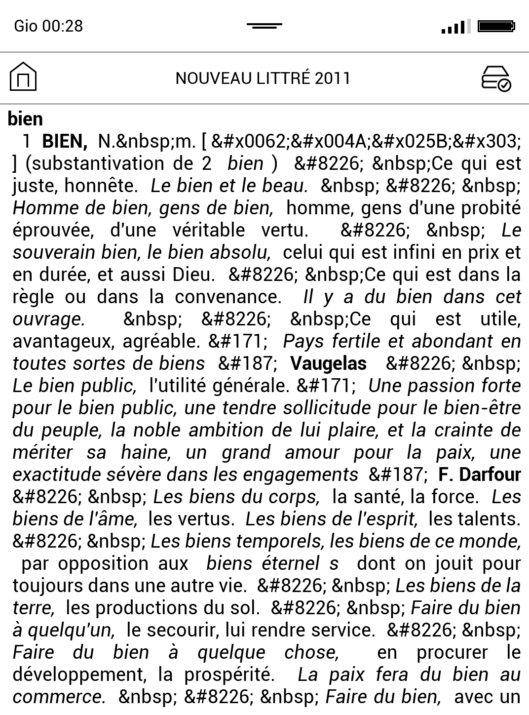

Uhm, appreciate, but still no joy. The stock Dictionary.app displays the codes literally, inside pbreader they are simply dropped. In CR3 I can't open the dictionary anymore (not necessarily because of this file).
ID:	176942   Click image for larger version
EastEriq is offline   Reply With Quote

Seems that your dictionary app can't handle html entities at all.
The last thing you could do is convert the numerical symbols to characters and expect modern day apps to be able to handle unicode directly.
When I posted the DOCTYPE within a code block, I found that some codes were automatically interpreted. So you'll want a low level parser, that only interprets the &#xXXXX; parts.
I had expected the lookup in reader to be working, though? Should expect to be better even because the <f>-tags are retained now. But apparently it can handle entity names, but not numbers?

Seems so. That's why I wrote "replace with unicode" Anyway, not tonight... Now what buggers me is why CR3 can't see dictionaries anymore (which most likely is unrelated to your file, now removed from PB)

Try this.
How done:
  1. Took Markismus last xdxf
  2. substituted xml entities with unicode characters with this script:
    cat Nouveau\ Littre\ 2011\ \(from\ Bookeen\ by\ Penelope\)_reconstructed.xdxf |\
      sed -e "s/&nbsp;/ /g" \
          -e "s/&apos;/'/g" \
          -e "s/<[/]*f>//g" \
          | perl -CS -pe 's/&#x([\dA-Fa-f]{3,4});/chr(hex($1))/eg' \
          | perl -CS -pe 's/&#(\d{3,4});/chr($1)/eg' \
    > N1.xdxf
  3. converted using DictionaryConverter-neu 171109, augmented with the locales found in this post (rather than using the converter Markismus used - for no reason, just ran into the others first).

Originally Posted by Markismus View Post
How do the results compare?
Uh, I don't know, byte-checking? At first sight on a few entries (on my one) the content seems about ok, I wouldn't go for an extensive check beyond that.
The appearance in the three (I manage to resurrect CR3 in the meantime) dictionary viewers I have varies a bit, each one has its formatting quirks, like adding spacing, using a font which misses some of the graphisms. None of the three dict viewers has really an impressing usability by itself, I once was aware of some configuration files to fiddle a bit with fonts in the one or the other, but that's all it is. This one .dic seems as good as others now.
