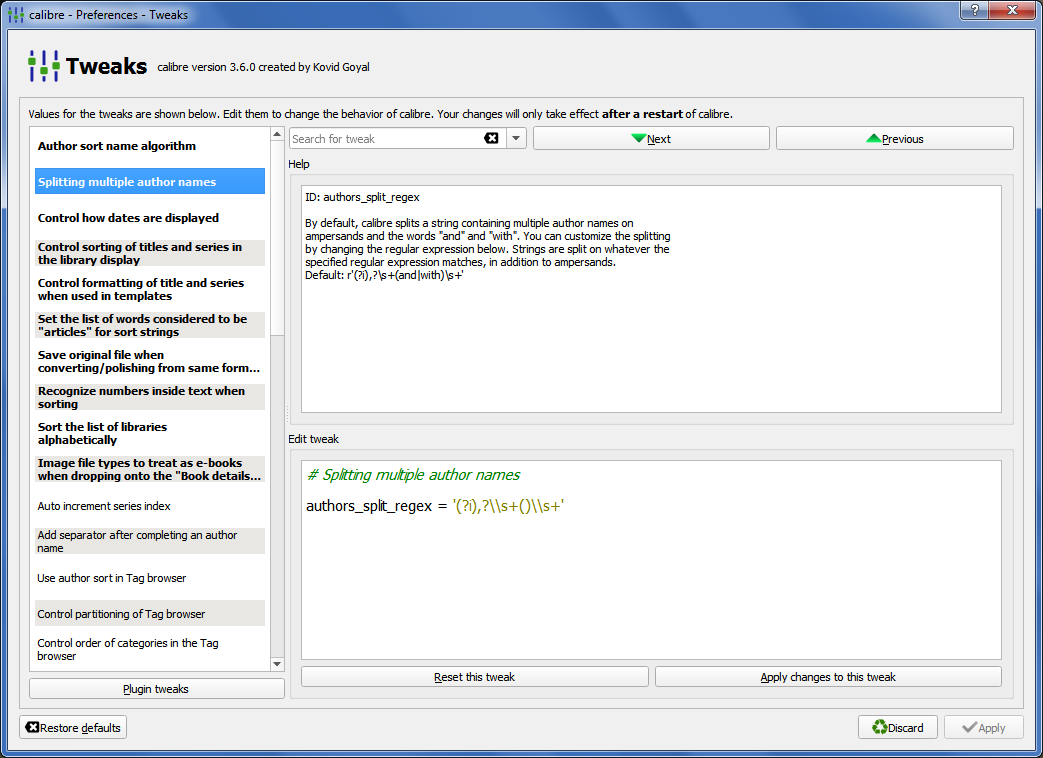

Is it possible to avoid the plugin changing and or with to & when I import a list?
When does it do that? If it is in the author, then it is probably standard calibre function when handling authors. There is a tweak to change what is treated as a separator for multiple authors.

I have removed both and and with in the Tweak.
You had already done that, or you have just done it? And I take it that means it is the handling of author.

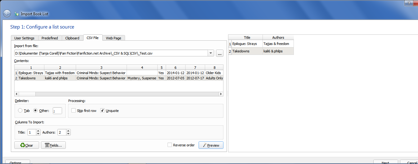

I did that months ago.
I've removed all the other information from the list than the author and title.
Name:	Skærmbillede 2017-11-10 08.47.03.png
Thanks, that made it clear. The problem was that the plugin has it's own method of parsing the authors. This didn't take into account the tweaks. I have made a change to use the calibre function for doing this. Try the attached beta and tell me how it goes.

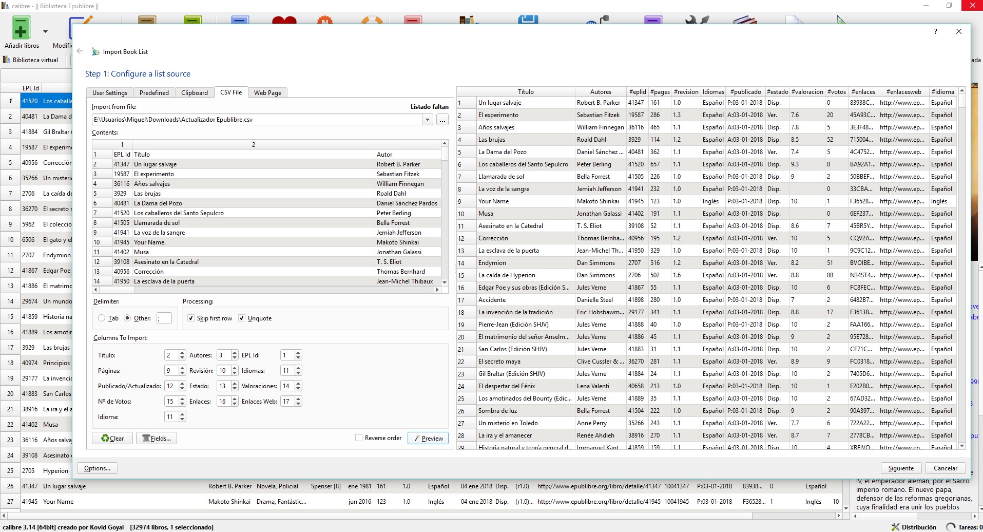

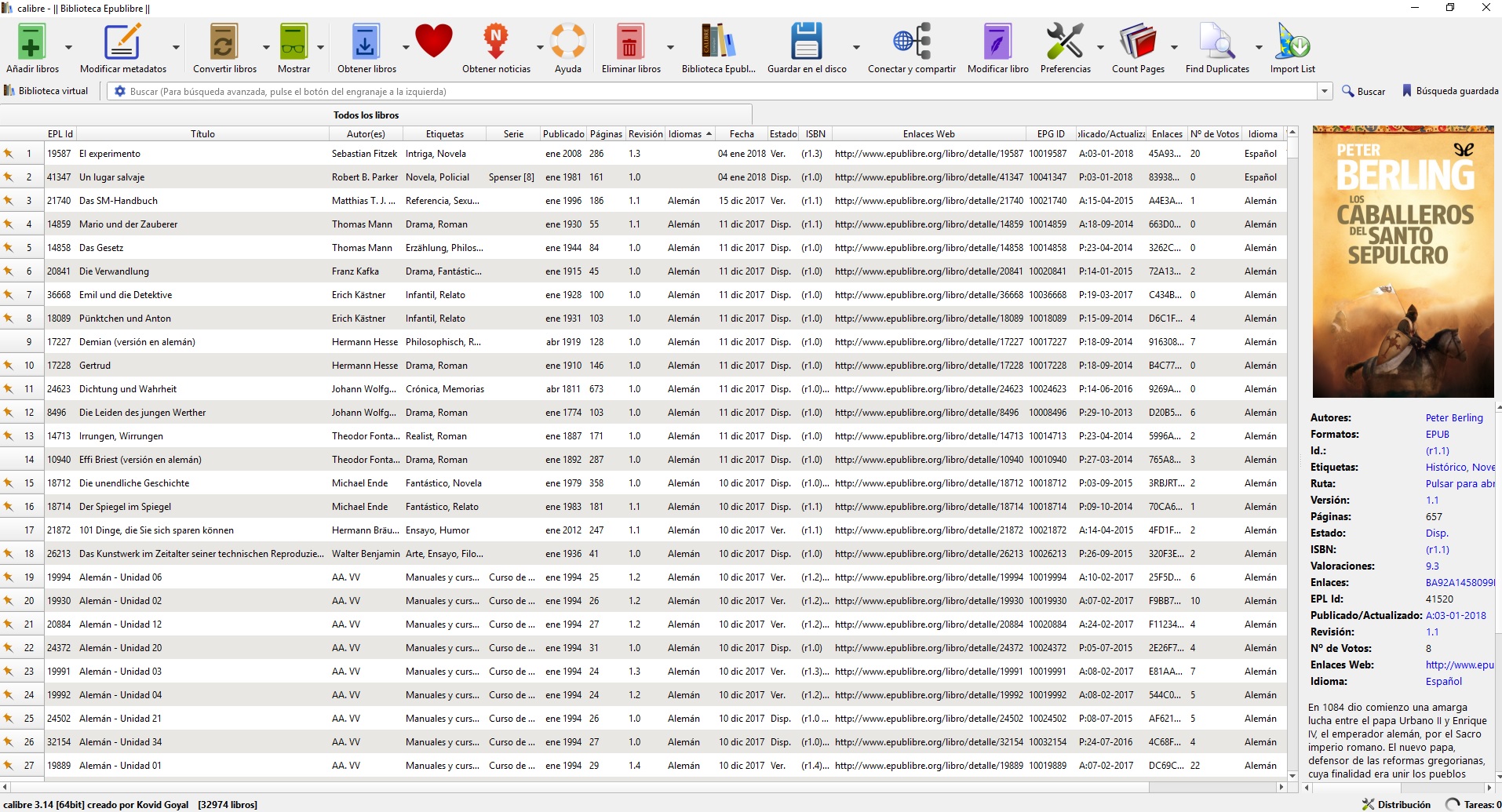

Are you selecting the language as a column to update but the input has no value? And where are you importing from? A web page or a CSV file? It would be goo to have an example to look at to work out what is happening. If you can post or PM a sample, then I'll look at that.
And what version of the plugin are you using? You linked to a post with a beta attached. Are you using it or the released version?

If I'm reading the images right, you have two columns: "languages" and "language", and the same field goes to both columns. One is updated (language) but not the other (languages). Am I right?
Sí. La columna Idiomas es de Calibre y en ella se añade automáticamente el idioma correspondiente al añadir un libro. El problema es que al usar el plugin Import list, la columna Idiomas se borra. Por eso creé la columna Idioma para incluir entre otros datos el idioma a través de un archivo CSV. He probado de todo. Incluso a no incluir Idioma para actualizar con el Import list. Pero aunque solo use las columnas título y autor, los datos de la columna Idiomas se eliminan. Es la única columna afectada, el resto de columnas no sufre alteración alguna.
