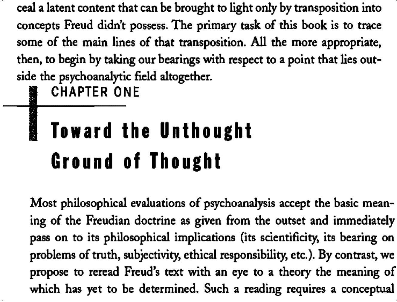

custom vertical space at page break
Hi, first let me tell your k2pdfopt is the greatest pdf modifier for mobile readers that can be
I don't know if this seems to be a useful feature (or implementable one), but could the vertical space between page breaks be made so that it would depend on the font size of the text after the break, compared to the font before the break (or, instead of font sizes - the height of those lines)? This would be very helpful when there is a page break between chapters, contents page etc. so that:
a) no unnecessary space would be added between normal text at page break (lines continue to be 'merged' so to speak in the output pdf)
b) some vertical space would be added when a new chapter starts, for example (otherwise, it looks pretty annoying)
Example for b)
lorem ipsum some text from chapter 1 ends here.
CHAPTER TWO. ANNOYING LACK OF SPACE ABOVE
And thus begins the new chapter with new text.
The default mode already does this. See the two attachments (I used the -c option to get a color conversion since the pages are color-coded to make the output easier to decipher). The spacing between contiguous text across pages needs a little work--it's not quite right. I'll have to look into that. But it does put a bigger space in front of "Chapter 2". Do you have an example where it's not working the way you expect?
Edit (9 Jan 2013): Okay, when I convert with "-mode fw", there is no gap put in front of "Chapter 2," so I see what you're talking about there. That is due to the setting of -vb -2 that is applied by -mode fw. That setting causes each page region to be treated as a "black box"--that is, I don't look inside of the page regions to try to determine font sizes, line spacing, etc., so I don't have any information on what spacing to put between regions. I'll think about ways to improve this.
Hi and thanks for answering! I'm not explicitly using this fw mode, but perhaps somehow that vb option gets activated. What i normally use to convert pdfs for my kindle (these settings seem to work for most pdfs, even poorly scanned) are these options: 1 column, landscape mode, no wrapping, 0 margin, 0 output margin (i eliminate page numbers etc. beforehand using another software); sometimes, if the original page width is small, i use portrait mode. I set the options from the menu (interactively), not from the command line, after dragging the pdf to the k2pdfopt icon (which has set the "-bpc 4" option only).
And an example:
I'll try to explicitly set the vb option, to see if changes the output. TY.
Hi and thanks for answering! I'm not explicitly using this fw mode, but perhaps somehow that vb option gets activated...
Any chance you can attach the source file, or attach just a couple pages from it (involving a chapter change)? Then I can try out your options with that file ane make sure I understand what's going on. K2pdfopt might be treating the "Chapter One" piece as a figure since it has that black bar which will prevent a line break. It's hard to tell without having the source.
Sure, here it is
(and i presume it's seen as image, but i think i saw the same behavior in other pdfs; also, perhaps some space before an image does no harm or even helps, at least if the image still fits the page):
sample.pdf
( Perhaps treating an image like a "tall line" i.e. no matter if it's text or not? Just speculating of course)

Made some more tests (on that sample) - basically, only when wrapping is enabled and effective (e.g. in portrait mode, when it actually splits the lines), there is some nice space before the chapter title.
