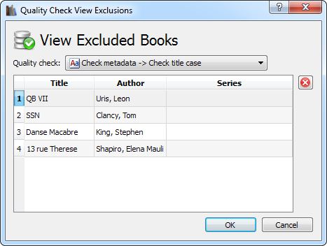

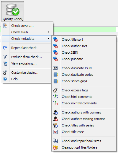

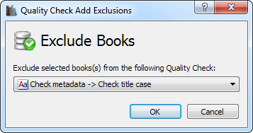

v1.7.0 Released
Changes in this release:
  • Move all the metadata based checks under a submenu, and reorder menus
  • Add a "Repeat last check" menu item to allow simply running the last check again
  • Add "Exclude from check..." menu item, to allow excluding books from repeatedly showing you want exempt
  • Add "View exclusions..." menu item, to allow viewing all excluded books per check and deleting if desired.
  • Fix missing images from menu for CSS based items
  • Remove configuration of the Author commas/no commas and titles with series menu items
The big ticket item in this release is the ability to add books to an exclusion list for a particular check, so they don't keep coming up again and again if you have a genuine reason. A prime example of usage for this is the "Check titlecase" check where there are always books that you would prefer to keep the published casing variation rather than what calibre's rules come up with. Other examples could be the author sorts and titles with series checks - but nearly every check in this plugin allows adding exemptions.
As you would hopefully expect, once you add such books to an exemption for that particular check, they will not appear the next time you run the check. I have also added a "Repeat last check" menu item for conveninece with re-running without digging back into the submenus.
I also took the opportunity to restructure the menus a bit for consistency. If you had keyboard shortcuts assigned to some of those moved menus they will need assigning again.
ID:	79602   Click image for larger version
ID:	79603   Click image for larger version
