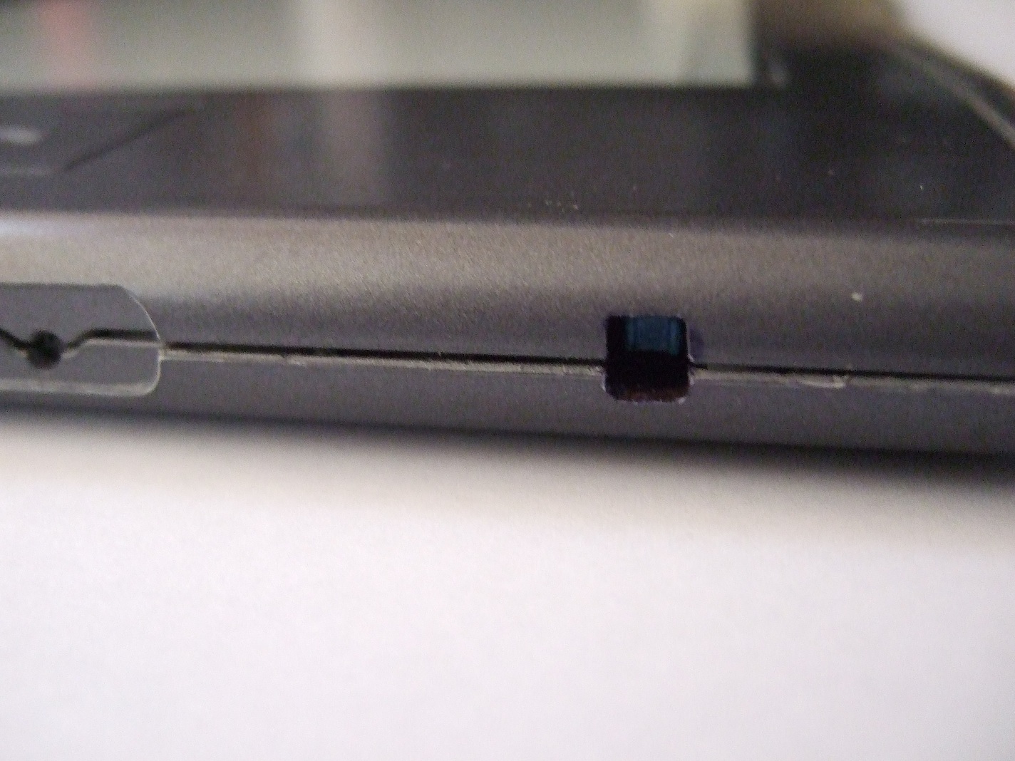

Don't know what type of connector the big one from batteryspace has. My Varta battery had a different one, so i had to use the original connector. The wires were already cut and connected to the on/off switch because i had that installed earlier. The switch i used, came out of an old 56k modem. It was quite small, but i had to dremel away some plastic nevertheless to make it fit. I used some 2-component glue to keep it in place. The switch is a little inside the case, so it can't be pushed on or off accidentally. I made a small opening at the bottom near the usb connectors and the reset-button and use my stylus to switch it on and off.
Until now the batterry-gauge is still not very reliable. The DR switches off even when the indicator shows its not empty at all. I suppose it'll take some time. When it shuts down while i think it's not empty yet, i use the on/off switch. After starting up this way, the indicator will show a fully charged battery again. This way i get some extra hours of reading time. I only charge the battery when the DR doesn't start up anymore.
