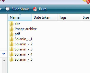

Here's what I meant about the folders. Basically, it tries to bind the first (5 in this case) folders it finds, hence cbz, pdf, images and Solanin 1 as the first one, then solanin 2 as the second volume (this is with autobind 4, converting 5 chapters).
Since there's no images in the first three, it only shows up as Solanin 1 in volume 1.
Oh, now I see the problem. Canti assumes that everything in output_folder was created by Canti, meaning that all folders located there are image folders. Since you created your own folders in output_folder, Canti doesn't know how to handle them. I'll see if I can add code to handle your case, but I'm not sure if it will be possible.
-Update-
I think I fixed the code, although I need to test it more.
