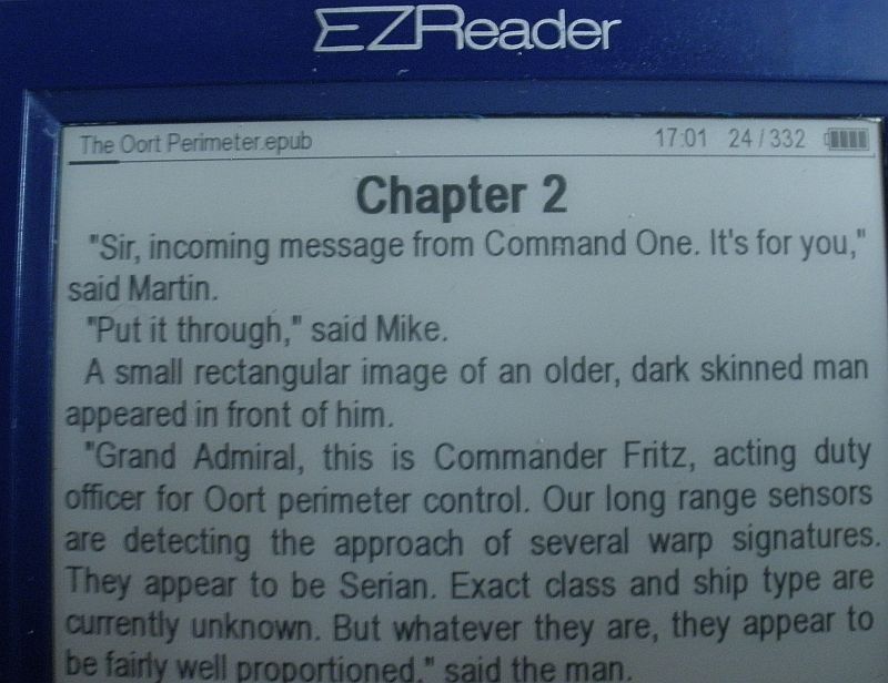

Originally Posted by Davimee View Post
I'm having the same trouble. I just downloaded the Lbook firmware today for the first time. I really like the formatting of books using ADE with the Astak firmware, but I like the fact that I can have the status bar in the top of CoolReader that shows the date and my progress, and the title of the book. So today I decided to try out the Lbook firmware. The Oort Perimeter opens just fine with ADE, but when I long press and open it in CoolReader, the formatting is gone,
This is what "The Oort Perimeter" looks like on my PocketPRO using the Lbook firmware and CoolReader. I have the /crengine folder populated with my default INI and CSS files, and I am using the IBOOKN font for this display. I have the paragraph indent set at 0.5em, and I have new chapters always start on a new page.
Well, that's what I'd like mine to look like. I'm guessing this may be way over my head, but... how do you make your own INI and CSS files? Is this something you need a special program for?
I need to apologize for the sample I posted, as I was half asleep when I posted last night. When I checked again this morning, I realized that "The Oort Perimeter" that I downloaded from Astak had multiple conflicting charset encoding definitions and other errors that caused it to fail epubcheck. The image that I posted was of "The Oort Perimeter" that I had reprocessed and corrected. When I checked the original "The Oort Perimeter" file this morning, I saw the same problems Davimee mentioned. I am sorry to have caused confusion.
