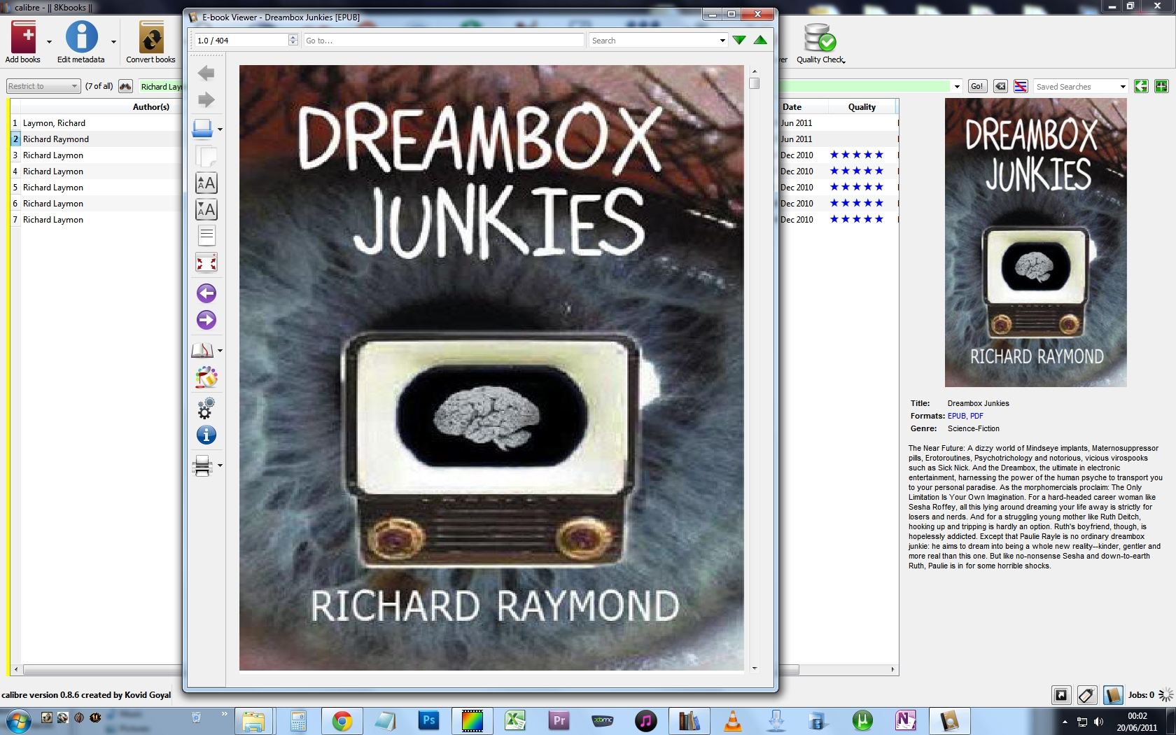

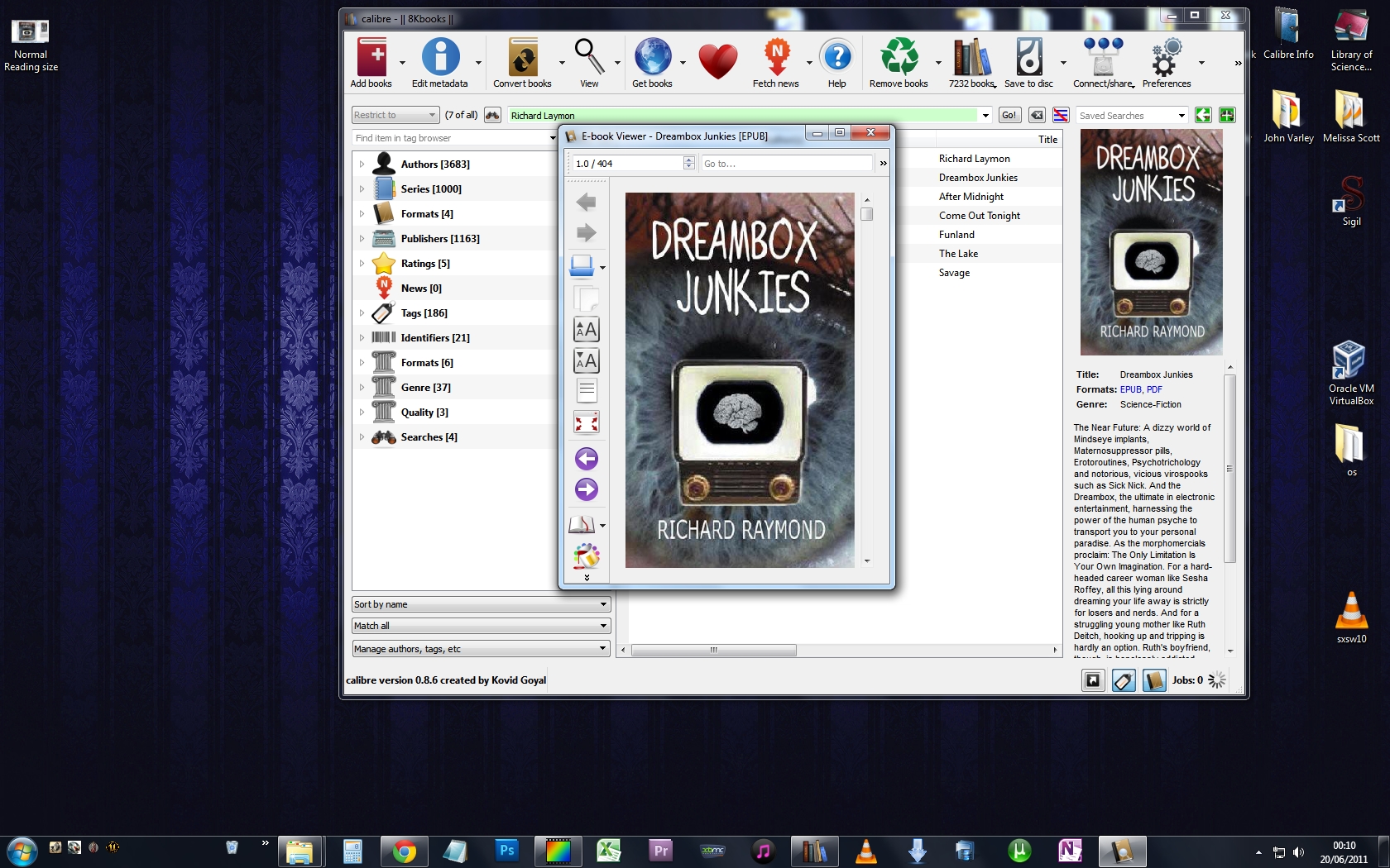

I know this is an old post, but didn't want to start another.
Is there a way to stop the Calibre ebook viewer stretching the cover image.
I'm talking specifically about when using this viewer on the PC, which I do to check ebups, and occasionally read.
I know the ebook viewer program itself is resizeable - , but my covers are only going to be around 500x700pixels which means on a PC screen with lots of space you have a pretty small reader, or if you resize it to a more usable dimension you get a distorted cover.
Its almost impossible to resize the reader program to the correct proportions to stop it changing the cover.
As a related side note, When moving from first page to second page, this is always the Cover just moving up a few mm.
I understand this resizing may be great for hardware readers of different dimensions.
but to have an option in Calibre's ebook reader to just leave the cover dimensions alone would be great for when on the PC
Attachments are just for refrence, in case above makes no sense
Edit I just noticed there is a user style sheet settings for the reader, would that be something that could change the scaling behavior on the covers?
Name:	Normal Reading size.jpg
ID:	73043   Click image for larger version
Name:	size it has to be to look right.jpg
transmitthis is offline   Reply With Quote

Talking about epubs
the viewer does not resize the cover, it follows instructions in the ebook file that tell it to resize the cover. and because covers are not identified unambiguously in epubs, there is no good way to override that behavior.

Talking about epubs
so it does resize the cover then
Not just Epub,but also PRC, Mobi and Lit any file that has a cover, when you resize the ereader application, the cover streaches warps and resizes along with the program.
Not saying its a problem, just want to make sure were on the same page (excues the pun).
If there is something that can be done, an option to not display the cover even.
Its just that everything looks great, then as soon as I open a book to read it I'm faced with a large distorted cover image - it, well it just looks lame.
I know its only really superficial asthetices, but if there is a workaround then I'm all ears.
Thanks anyway, even just for the reply

The problem is that your cover is being sized to fit the screen or the reading space. This makes the cover look awful in a lot of cases. There is an option in Calibre to keep the aspect ratio of the cover. Use that and yes, the cover will size for the screen. But it will also not distort due to an incorrect aspect ratio.
There is an option? - you couldn't point me to it could you JSWolf?
Having the Aspect ratio stay the same is def something worth having.
Note this is for the Reader Application when used on a PC only,
don't want to confuse it with the way book covers are displayed on devices
Old 06-20-2011, 11:35 AM   #30
Posts: 46,207
Karma: 29629502
Look in EPUB Output under conversion settings, and that will change the way it is displayed no the device as well, which is what I was saying before.
