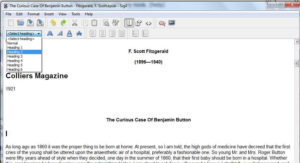

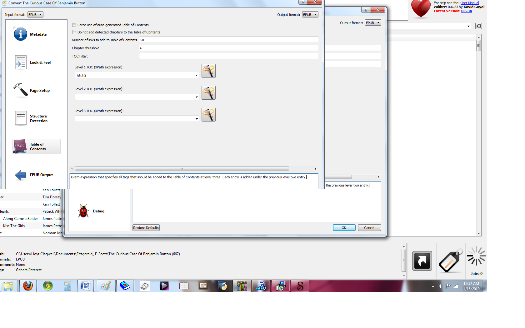

Originally Posted by daffy4u View Post
Maybe fixing your ePub with Sigil would work.
That is a good suggestion. Worked for me. I created an ePub with out any chapter tags. Imported the file into Sigil. Highlighted the Chapters I wanted tagged and selected heading 2. Saved the file and imported into Calibre. In Calibre selected Convert eBooks, selected ePub and in the Table of Contents Tab added //h:h2 into the Level 1 TOC section. Created the book and sent it to my nook and was able to go the the chapters.

Also , when you say you hightlight in Sigil, when I do that and then select heading 2, it stops for a moment then changes to <select heading>, but doesn't appear to be changing the file. Does something else have to be done?

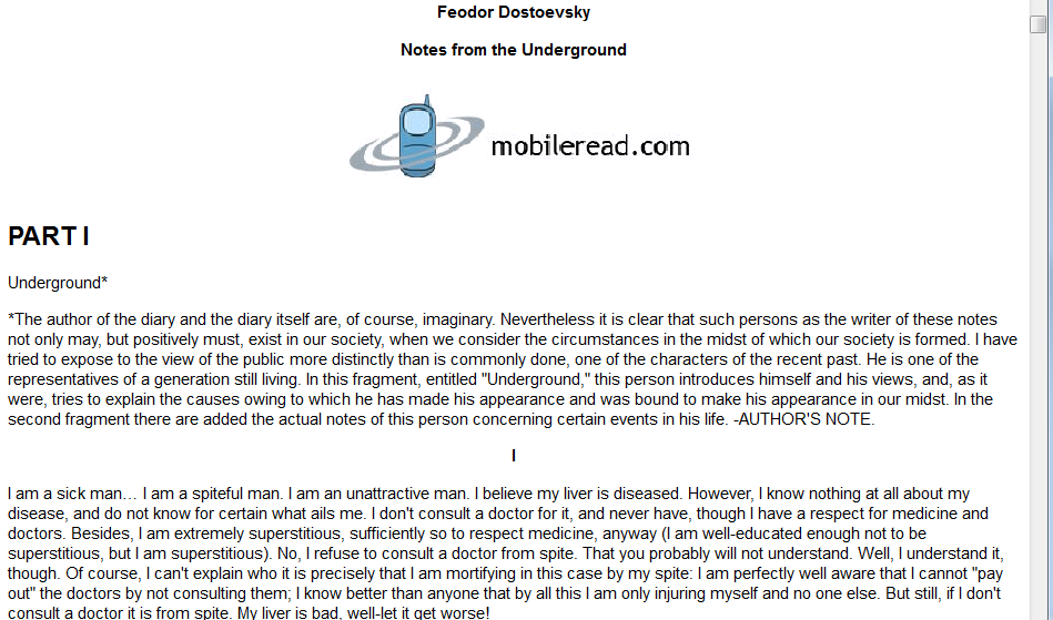

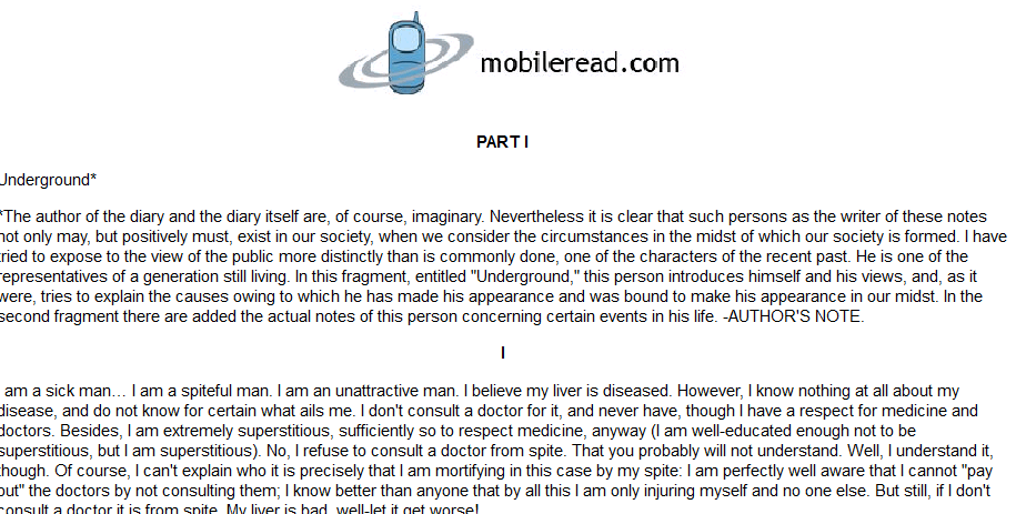

I have attached two pictures. The first is "Part 1" before I changed the tag. The second is "Part 2" after I changed the tag.
Hmmm, nothing changes in mine at all.

I was able to make it autogenerate chapter in calibre, with this though
//h:span[re:test(., "Chapter \d{0,4}", "")]
somehow, this bothers me that that's not even close to what it said I should be looking for.
