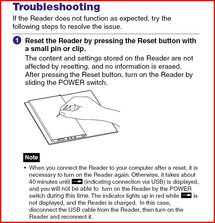

I got out both 505's and was checking the manual. Since you said that it started when you thought you were charging from the computer, it may have been that it ended up depleting the charge. Once that happens it takes a full mains charge to get it ready again (psp or Sony wall charger only)
The manual on page 72 states that it may take up to 40 minutes after a reset. Have you checked that page and page 28?
You can (after you are sure that it is fully charged) reconnect to the computer by USB and do another reset.
