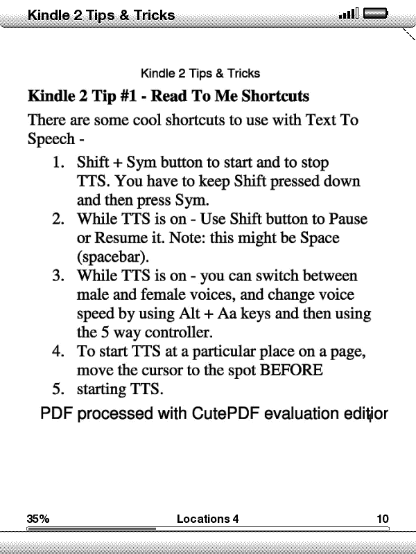

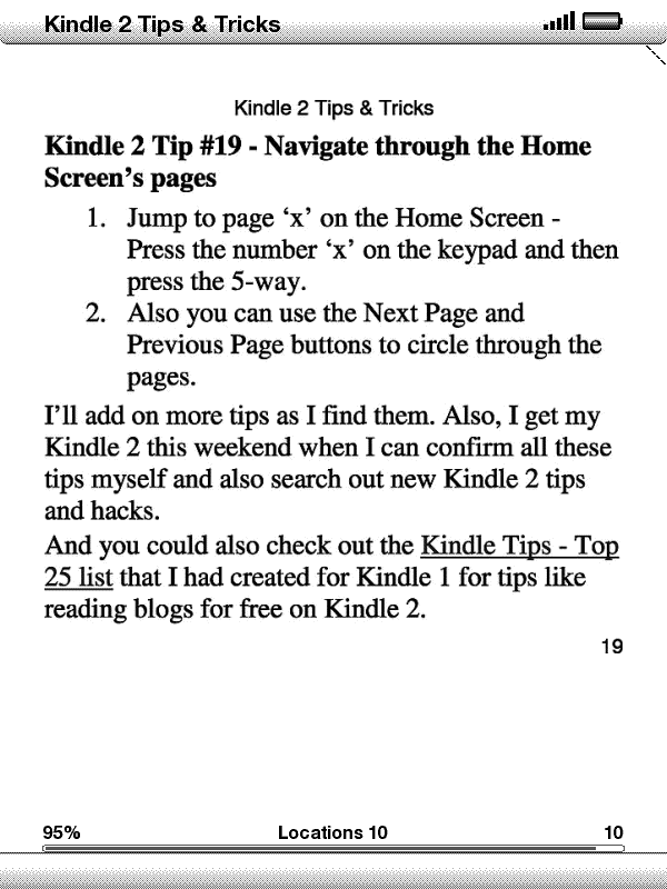

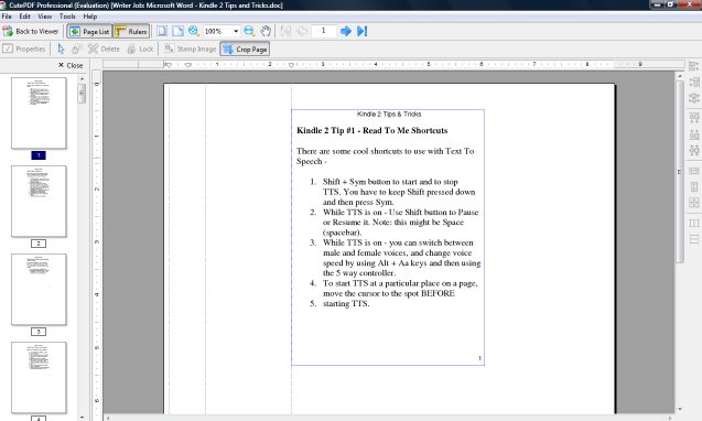

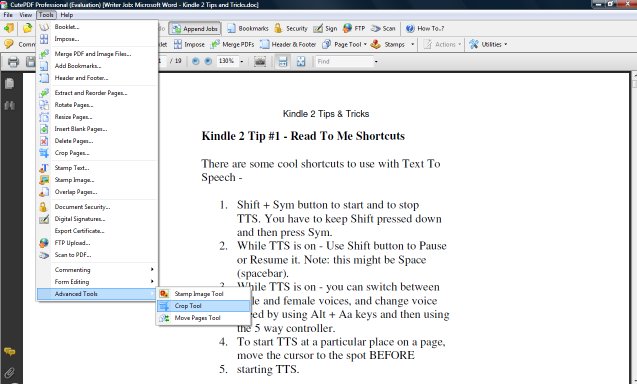

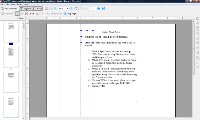

Today I was reading a Kindle Blog written by switch11 because it was all about Kindle 2 Tips and Hacks. I like to keep these tips on my Kindles, so I set out to create a little mobi book.
I copy and pasted the text into a Word Document. I set the page size to 4.5 inches by 5.75 inches. I added a header and page numbers (just because I could). I also used hard page breaks to get each tip on its own page (unless it was very short and then I'd put 2 on a page). The font was TimesNew Roman at 12pts.
First I tried running the Word file the MPC but wasn't happy with the results, so I decided to use PDFRead after creating a PDF file with CutePDF Pro 3.6 (the free version) using the same page dimension (4.5 inches by 5.75 inches). I've been using this software for years but never explored all the features available even in the free version.
The results were a pages sized to fit my Kindle but with a huge white border around it. I used the advanced crop tools to create a rectangle around the text on the first page that would be big enough to work for all pages in the PDF. Having that page number at the bottom of the page helped me to make the correct size rectangle. I now had a PDF with a very small border (there is a watermark at the bottom of the first page only which covers the page number - hey, for free what do you want).
I ran that PDF through PDFRead and got a nice sized and very readable pdf.
Edit: As I play more, it looks like this works best with PDFs you create yourself to fit a 6 inch screen. I'm not having much luck with PDFs created previously for 8.5 and 11 in pages (I'm still trying the script PDF in the first post to work).

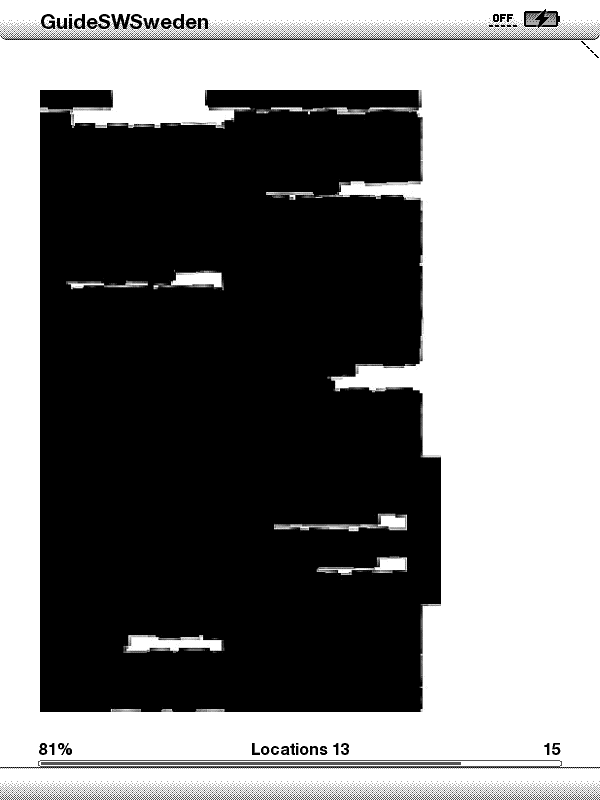

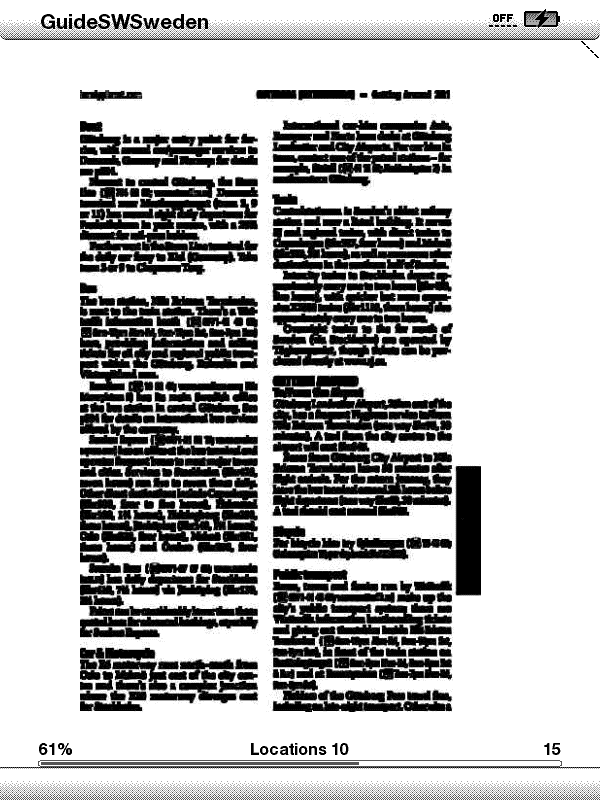

progressively darker text?
Perfect! This seems to by what I've been looking for to view Lonely Planet pdfs on the Kindle.
I'm just having one problem: Any idea why, on the document I processed with pdfread, the font gets progressively darker with each page. The last 10 or 15 pages are just black splotches. Am I doing something wrong? Settings? Other than this, the pdf reads beautifully on my Kindle II. Thanks!

Ok, here are three screen shots (an early page--nice and crisp although the settings need work and it should probably be half-page, landscape; a middle page where the text has become illegibly dark; and the last page, which is not recognizable as text). By the way, I tried various settings on pdfRead and they all had this problem of darkening text. I'm also attaching the .prc file and the original pdf file that I was trying to convert. Thanks for the help!
That .pdf is malformed. It has limitations where the second half of the .pdf was not properly decoded.
If you can extract the images, then you can try running it through PDFRead as In Format: ImgDir. I tried, but the last half of the file didn't extract well.
Or try printing the .pdf to another .pdf using a pdf driver and using the new .pdf as input to PDFRead.

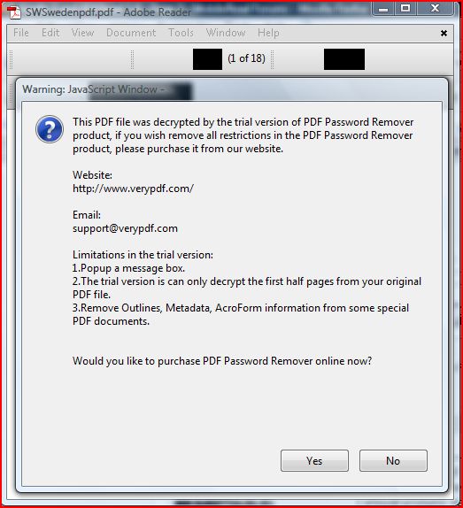

Wow erickson77, those images looks like the government got to your file and blocked out everything they considered top secret information.
As nrapallo says, there is something wacky going on with your pdf. It's encrypted. When I tried to open it, I saw this lovely little pop-up.
