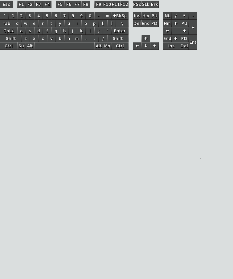

Antartica, your help is needed. Please check it. It seems that cellwriter won't work with xepdmgr. I always got "./xepdmgr: couldn't open display cellwriter" whether with or without "--show-window".

When I appended "--keyboard-only", I got a screen as attached. Now, the problem is: how to get this screen in text editor (such as LeafPad)?
The first parameter is the display in the version you are using, as in:
./xepdmgr :0 ./cellwriter
You are ommiting the :0, thus that error...

Ah! I forgot the parameter. Thanx.
To people who want to use cellwriter with xepdmgr, please insert the line in "run.sh":
./xepdmgr :0 ./bin/cellwriter --show-window
I should not forget the ":0 " parameter. What a shame of my memory.
