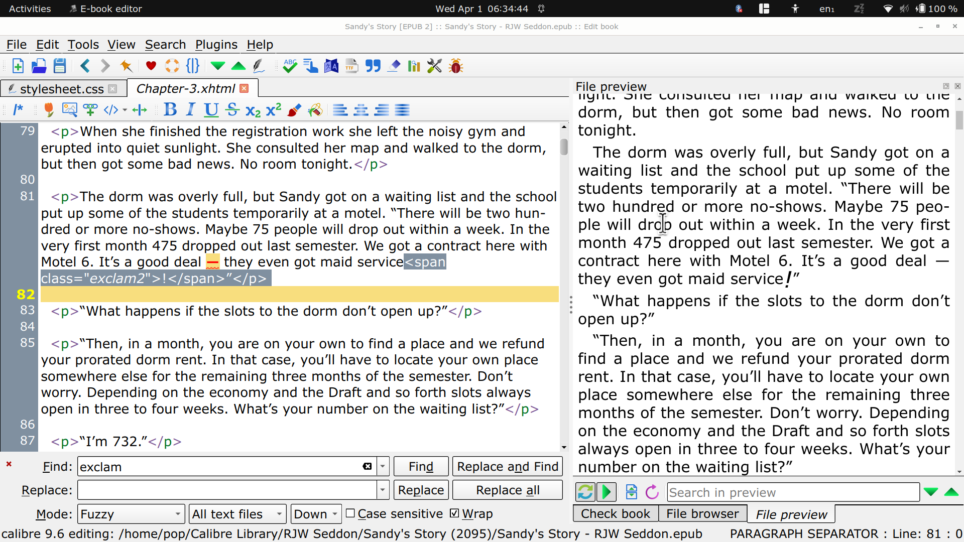

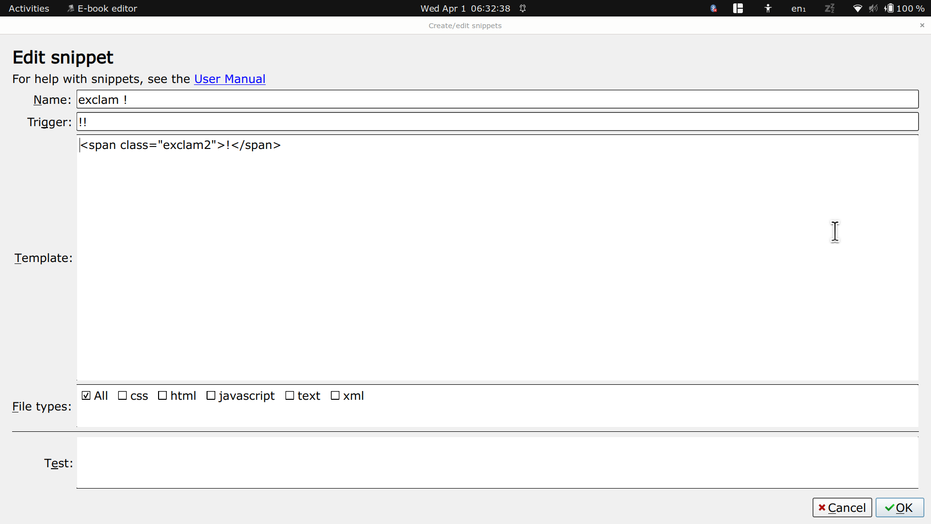

!! as a snippet equals <span class="exclam2">!</span>
I have been using a right-leaning extra-large exclamation mark which descends below the line and also extends upwards beyond normal height. It just looks good to me and seems to work well with Amazon Kindle and also PDF for printing. To use it I just type in the exclamation mark twice, then hit ctrl-J to make it function as a snippet. I amusing verdana font which has right- and left-leaning quotation marks and when the exclamation mark precedes an end quote I think it looks nice. Since the concept of ending a sentence with extreme emphasis is the basis of this mark I think that being a bit larger is all to the good. Even though it is descending and ascending beyond normal size I wanted to make sure it did not change line height for the single line it is on. I certainly do like the idea of putting in a unicode-range and did not know this could be done<span class="exclam2">!</span>
