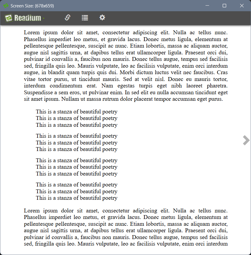

Try the following:
  <div class="center block">
      <p class="hindent">This is a stanza</p>
      <p class="hindent">This is a stanza of beautiful poetry and a very quite long one</p>
      <p class="hindent">This is a stanza of beautiful poetry and the most long stanza in this poetry</p>
      <p class="hindent1">This is a stanza of beautiful poetry</p>
      <p class="hindent">This is a stanza of beautiful poetry</p>
  </div>
and
.block {
    margin: 1em 0;
    display: block;
    width: fit-content;
    max-width: 85%;
    margin-left: auto;
    margin-right: auto;
    text-align: left;
ID:	221748 Click image for larger version
Of course, this "solution" is not working on ADE 2.x.

@RbnJrg — Okay. So. When do I just go out and buy a "RbnJrg" bat signal? And where are they sold?
Thank you. This is exactly "it".
Quick question (hopefully): do you know why when using your classes if I do <div class="center"><div class="block"> the bottom margin disappears when the text has to flow onto a second page (see image4 attached)? Whereas when it's coded exactly as you have (i.e. <div class="center block">), the bottom margin is preserved. Note, the <div><div> method work fine if the text isn't forced to reflow to a second page (see image5 attached).
Also, I tested it with class="center block" and class="block center" and it appears to be agnostic to order. Is that right?
EDIT: Re: ADE, of course not. What else is new? But also we're already on 4.5.something... when can we collectively forget about that trash application? Surely, those old nooks and kobos are on their last legs battery-wise....
