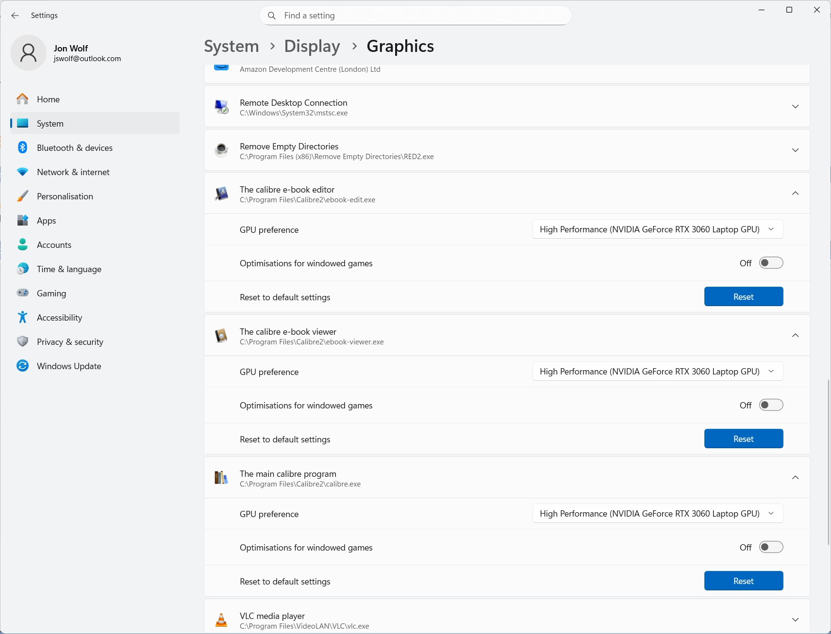

My laptop also runs an NVIDIA GeForce 3060 GPU as well as the Intel UHD Graphics.
Here is how to select which GPU an app uses...

Old 12-10-2025, 06:17 PM   #19
jenrar
jenrar began at the beginning.
Posts: 88
I tried both. Google just said restart Calibre. Should I try switching and restarting the laptop, not just Calibre?
Thank you so much for trying to help!
Attachment 219678
jenrar is offline   Reply With Quote

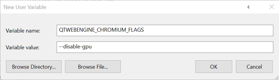

I was going to, but I don't know where to put that...

If you type 'set envir' in Start menu it should pop "Edit environment variables for your account" click Open and enter a new User environment variable.

Did that, looked just like the image you showed. Still not working.
Attachment 219679

Then you will have to do what several responders have already suggested.
Disable all startup tasks, confirm the problem has gone away. If it has re-enable the startup tasks one-by-one and do a restart between each until you find the culprit. BTW you do have a firewall - Fort.exe

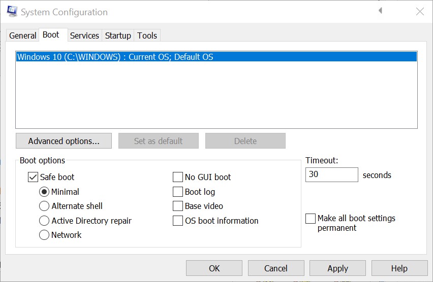

Let me recap my understanding of what you're telling us:
In Windows Safe mode you can read an epub that is in a calibre library, but in Windows "Normal" mode you can't read the same book in the same library - even after disabling all Start Up tasks and restarting Windows.
Did you use Safe Mode Minimal?

Yes, that's right. (Or was.) Yes, it was minimal.
But ALL ebooks open fine now. In the Calibre folder or not. I have no idea why. I didn't do anything else. Everything is reset to like it was (all the startup stuff is on, including my firewall), I'm not in safe mode, etc etc.
So I don't know. I mean, I'm THRILLED it's working again, but...it's also super frustrating! LOL
