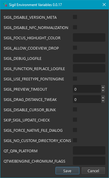

Great idea.
Here's a plugin for lazy users who don't want to manually edit env-vars.txt file.

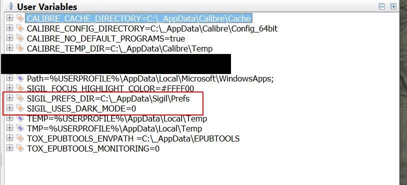

You seem to be missing a couple:
SIGIL_USES_DARK_MODE maybe defunct, but SIGIL_PREFS_DIR is definitely active, I occasionally swap in "_AppData/Sigil/Prefs_default".
PS: I assume use of the env-vars.txt file is optional.
SIGIL_PREFS_DIR is one you won't be able to set with the new env-vars.txt feature. You have to know the prefs dir to find the env-vars.txt file that will set variable to find the prefs dir to find the env-vars.txt file to set the variable to find the.... you get the picture.
Of course. The file does not exist by default.

Originally Posted by BeckyEbook View Post
Great idea.
Attachment 217583
Wow, nicely done! It was even smart enough to keep the custom env var names I was using for testing.
FWIW, I have tried to fix up the sigil-user-guide for future Sigil 2.6.2 release,
with info on the env-vars.txt file.
So if anyone is interested in vetting it and adding to it, please start by grabbing things from our sigil-user-guide repo master.
I tried to add in the force native dialogs env var that was previously missing, remove some duplication and add a second advanced topics chapter on python function replace.
Please take a peek and let me know if any changes are needed.
I hope to officially release it in sync with Sigil 2.6.2.

Thank you for your kind words.
SIGIL_PREFS_DIR is not Linux Only, although that is what the sigil-user-guide mentions.
I will add in the plugin a special support for this variable, which will not be read from env-vars.txt file but simply by os.getenv().
BeckyEbook is offline   Reply With Quote
