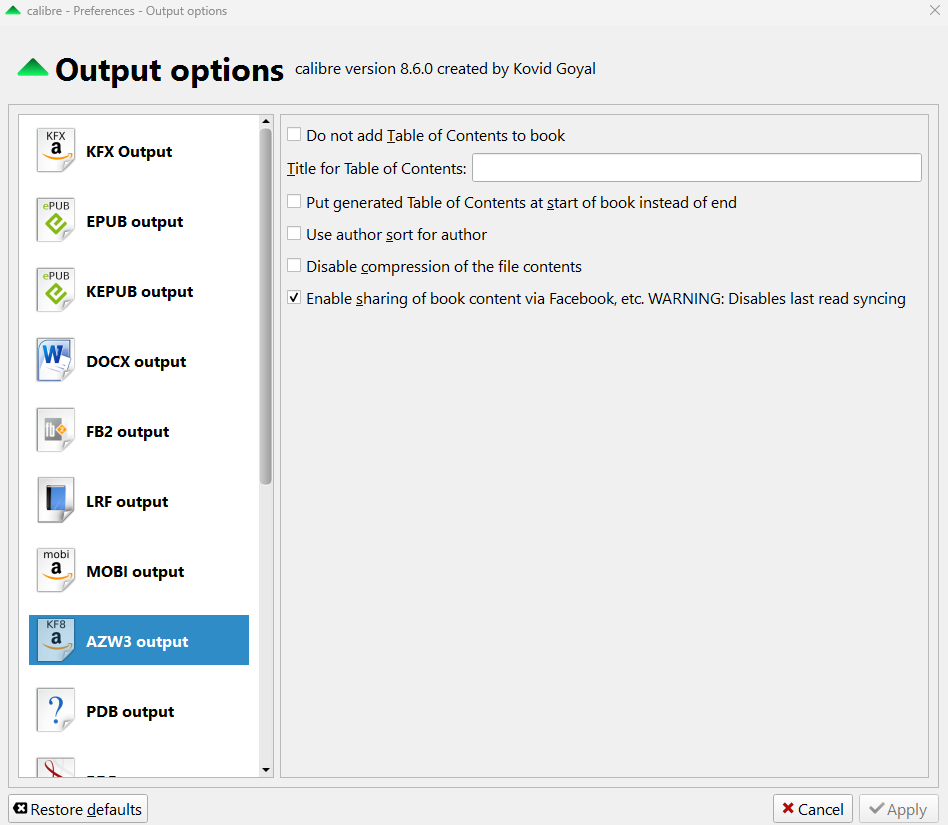

Originally Posted by tomsem View Post
By default, calibre converts to EBOK content type (for both AZW3 and MOBI). Those will not get a cover thumbnail. You need to check the 'Enable Sharing' output option to make it PDOC, then Kindle will generate a cover thumbnail.
It's confusing because 'Enable Sharing' does the opposite of what you might think it does (allow sharing to Goodreads). You can only do that with EBOK.

PDOC is an Amazon cdetype. It stands for Personal DOCument. The other possible cdetypes are EBOK (EBOoK) and EBSP (EBookSamPle).
Look in Preferences => Output Options => AZW3 Output for the Enable Sharing option. See the attached image.
