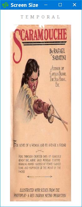

However, even though you can set a height of 100%, your code has the problem that the image width can be greater than 100%. If you set it to width: 100%, the image will be distorted. You can check that by opening the following epub anywhere and changing the width of the ereader window. By employing an svg wrapper that problem doesn't appear.
ID:	216143 Click image for larger version
Temporal.epub
The same problem occurs when setting the height using the alternative method (see the following epub):
Temporal2.epub

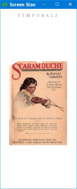

But by employing a svg wrapper all problems disappear:
ID:	216147 Click image for larger version
Temporal3.epub
Of course, you're free to continue using your own code (even if it's not the best), but you're leaving out more than half of e-readers.
