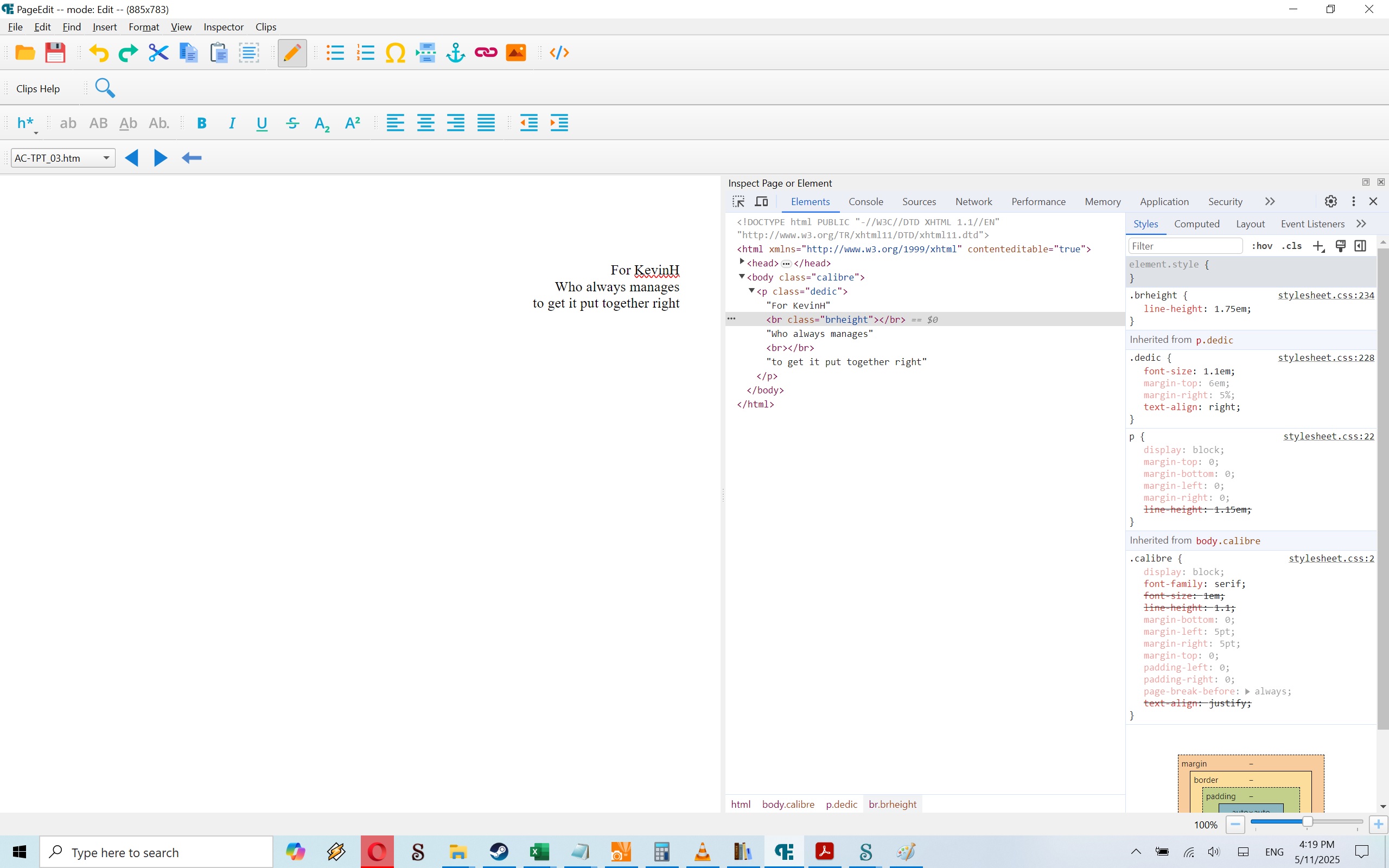

Is there some other inherited css that impacts it. Fire up PageEdit's Inspector and position your cursor on that br tag and look exactly at the style information in and around that tag. Perhaps the margins on the parent tag controls that?

That's a neat little function...
This is what I got:
element.style {
.brheight {
    line-height: 1.75em;
.dedic {
    font-size: 1.1em;
    margin-top: 6em;
    margin-right: 5%;
    text-align: right;
p {
    display: block;
    margin-top: 0;
    margin-bottom: 0;
    margin-left: 0;
    margin-right: 0;
    line-height: 1.15em;
.calibre {
    display: block;
    font-family: serif;
    font-size: 1em;
    line-height: 1.1;
    margin-bottom: 0;
    margin-left: 0;
    margin-right: 0;
    margin-top: 0;
    padding-left: 0;
    padding-right: 0;
    page-break-before: always;
    text-align: justify;
with the "line-height" values for ".calibre" and "p" overridden (correctly) by the "line-height" value in ".brheight".
Other properties that have strike-throughs (again, correctly, as far as I can tell) are "font-size" and "text-align" in ".calibre".
But still, no visual effect on the <br>'s line-height
The code itself is:
<body class="calibre">
  <p class="dedic">For KevinH<br class="brheight"/>Who always manages<br/>to get it put together right</p>
(in PageEdit, the code looks slightly different since the <br> isn't displayed as self-closing.)

PageEdit and Preview do not keep end tags. They are a tree of nodes of different types with a single parent link and multiple children links. End tags only exist in xml/xhtml/html to make it clear where siblings and children end a new node begins so that the tree of nodes can be formed. This tree is often referred to as the DOM or DOM tree.
If you look in the Inspector and have it show the code and find the br tag please take a screen shot of it styles and post it here.
If there is a bug, it is in Chrome's layout engine which is used by the graphics library Qt, that both PageEdit and Preview use.
Just to test, cause I know it looks terrible, but please try applying an inline style attribute with the line height right inside the br tag itself (which should have highest priority in css) Did that impact anything?

I assume you mean something like:
<br style="line-height:1.5em;"/>
If so, that also yielded a whole lotta nothin'.
I also tried adding
display: inline;
to the css, in case that's what you were driving at, but that didn't do anything.
However, if i create a <span> around the <br> and add the "line-height: 1.5em;" property to the css for the <span> it does work.
Not that this is an actual solution; that's super duct-tape-and-super-glue-style coding.
Also, please see the screengrab for "<br />" being displayed as "<br></br>" in PageEdit.
EDIT: Ha! I just realized that PageEdit's prettification inserts a line-break after <br> tags...
EDIT2: FWIW, I opened the file in Sigil 0.7.2, and the preview (and ye olde Book View) correctly renders the line-height property.

Sigil 0.7.2 does not use Qt Webengine it uses the very old QWebKit version and that is now full of security holes since it was never updated and eventually dropped in favour of QtWebEngine which is Chrome.
I am surprised that a br tag can not seem to have a line-height property but a span wrapping that tag can.
Did a web search ...
Ah this is a known thing ... inline tags line height are ignored. It is controlled by the parent block tag.
See this link for more info.
https://stackoverflow.com/questions/...s-not-work-why
Lots of things changed since the old html4 epub2 days. You can of course use css to make your br tag a block tag so that line-heights will work like the old days. See the bottom of that link for another link to more info.

Thanks, KevinH... Serves me right for waiting so long. That's going to be a drag to go back and fix across the library...
Looks like the closest thing to a working solution is:
    content: " ";
    display: block;
    margin: 0.5em 0;
...though I worry about these kinds of "tricks" creating problems down the line.
