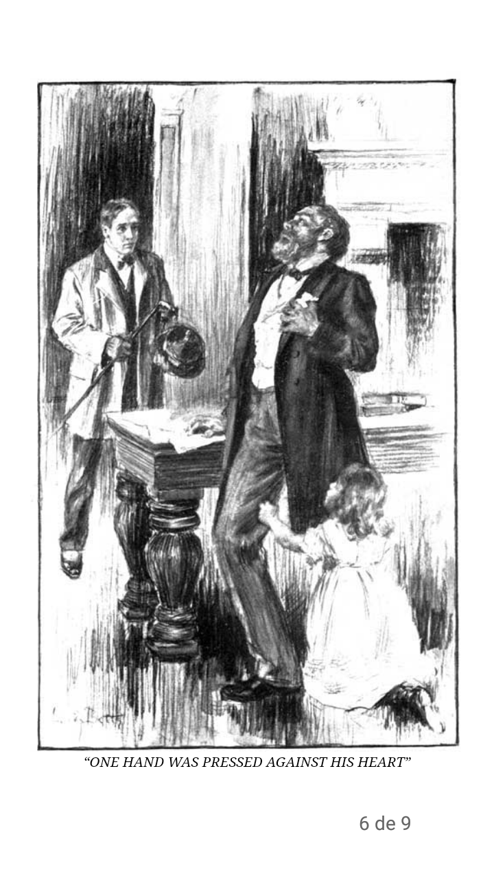

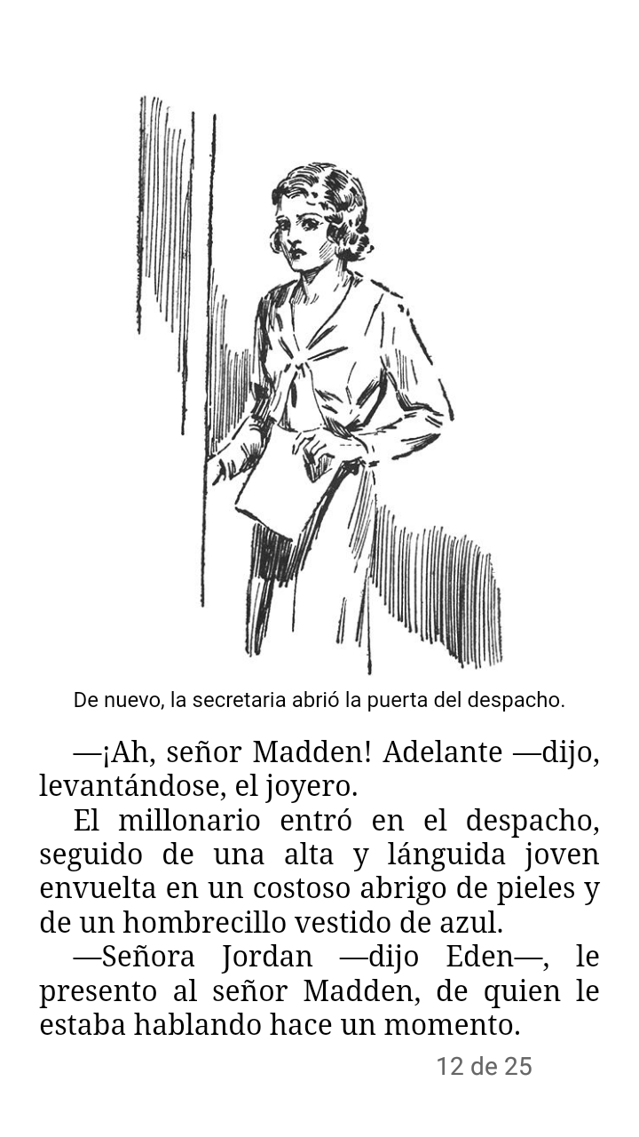

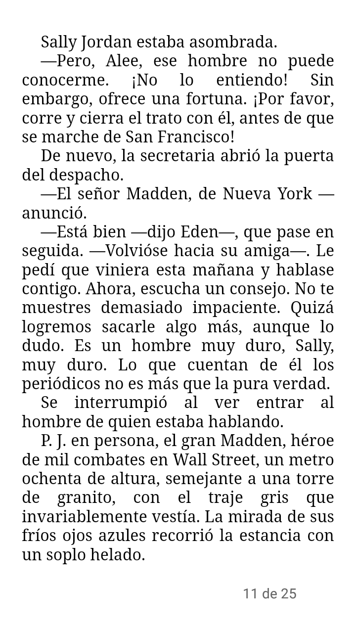

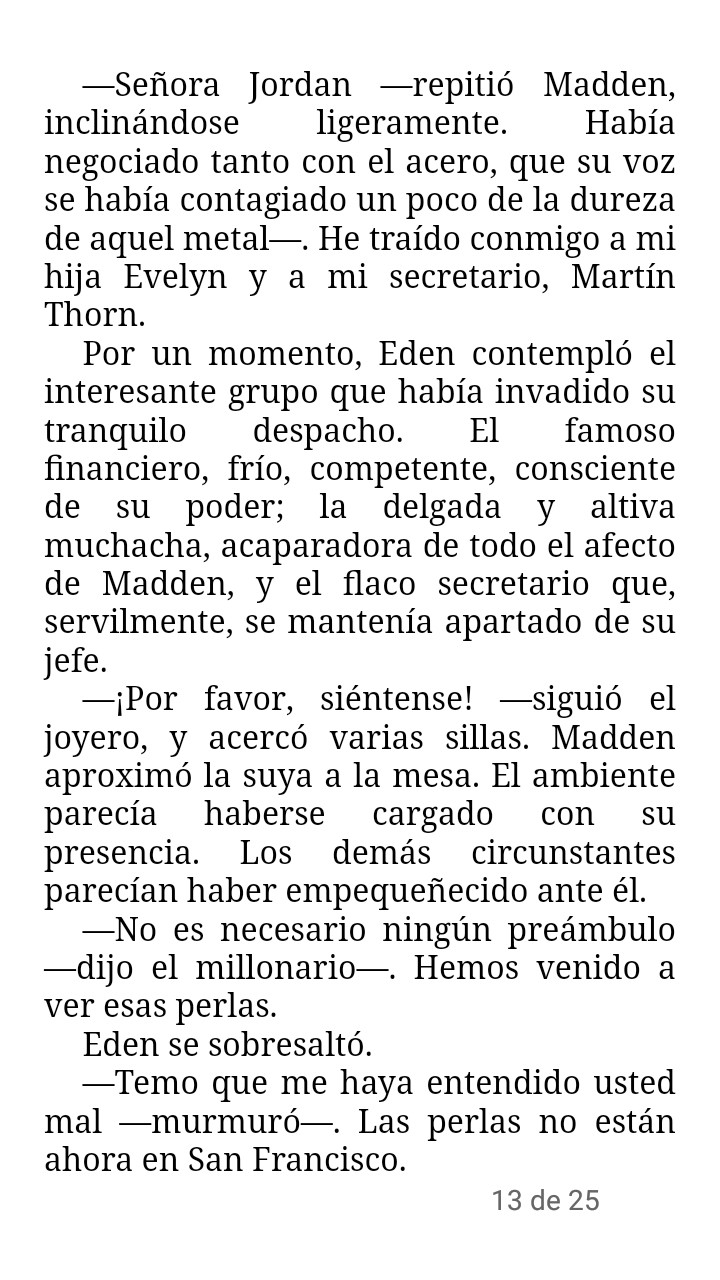

Aren't you assuming a screen in portrait orientation? What if someone wants to read in landscape orientation (and I know someone who does)?
Under epub3, no problem:
ID:	215384 Click image for larger version
ID:	215385 Click image for larger version
ID:	215387 Click image for larger version
ID:	215388 Click image for larger version
The above screenshots show full page images (and no blank spaces generated by them) but is possible to do the same with any size of image. The problem is under epub2; you can't avoid blank spaces on ereaders based on RMSDK and the size is an issue (because you have to define a height and that is a problem with RMSDK).

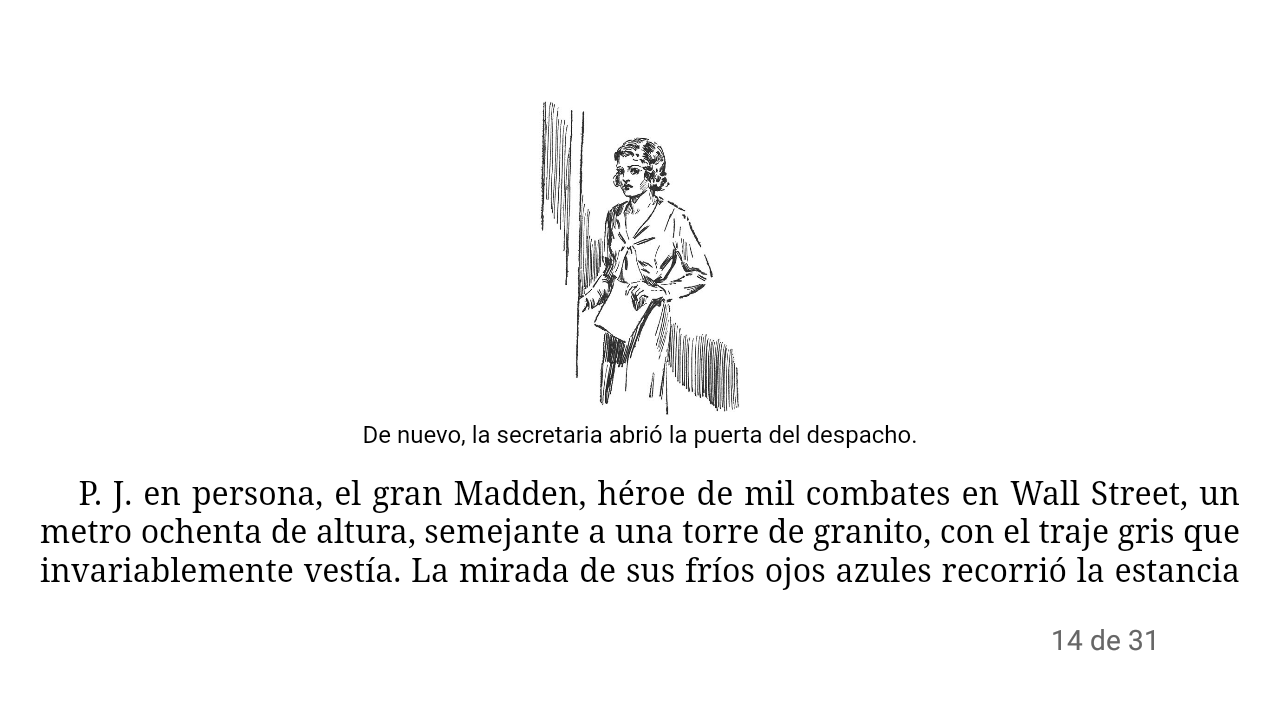

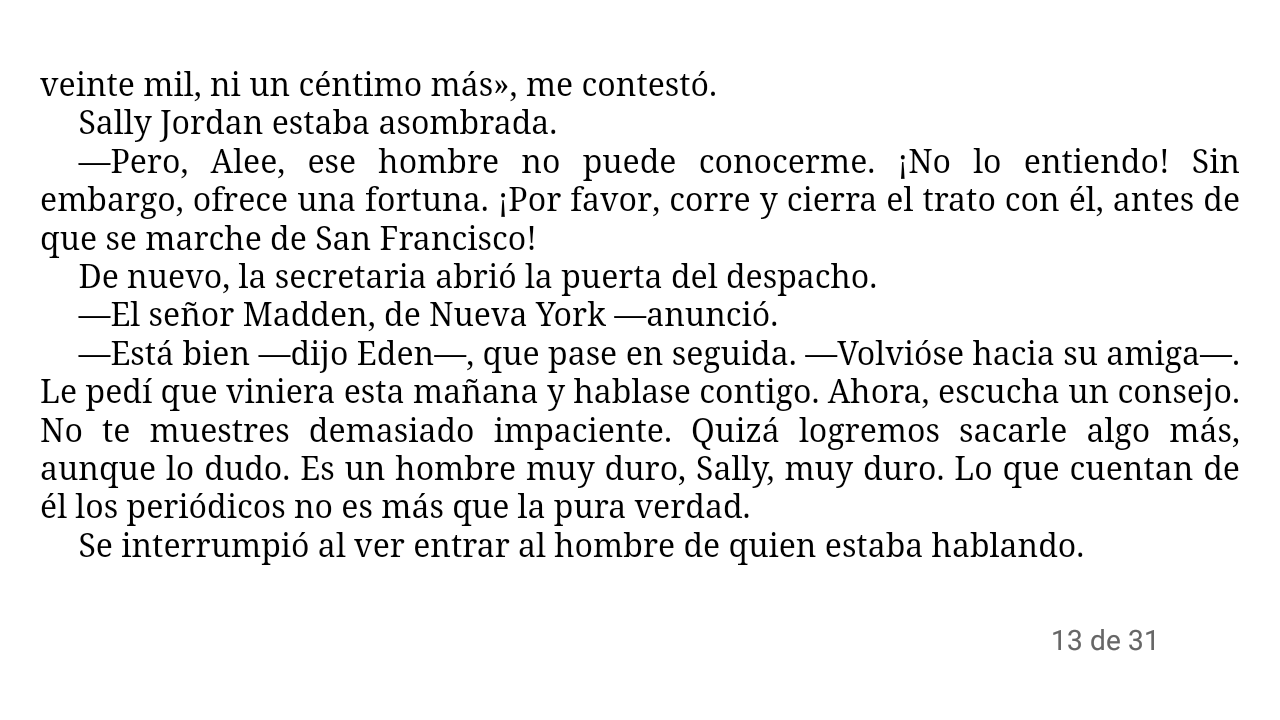

Since you Jellby speak spanish, here you have an example with images at half size (of course, all under epub3):
ID:	215391 Click image for larger version
ID:	215392 Click image for larger version
ID:	215394 Click image for larger version
ID:	215395 Click image for larger version
As you can see, there is no fragmentation (no blank space) and the caption remains with the image in both, portrait and landscape mode (the caption is live text). With epub2 and ereaders based on ADE, is not possible to get that.
