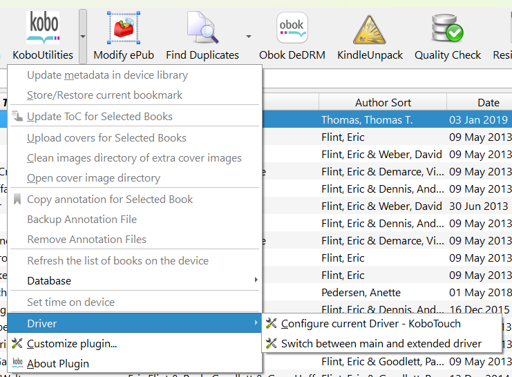

Would that screenshot be from a pre-8.0.1 version of calibre as the extended driver is no longer?
No, it's 8.0.1.

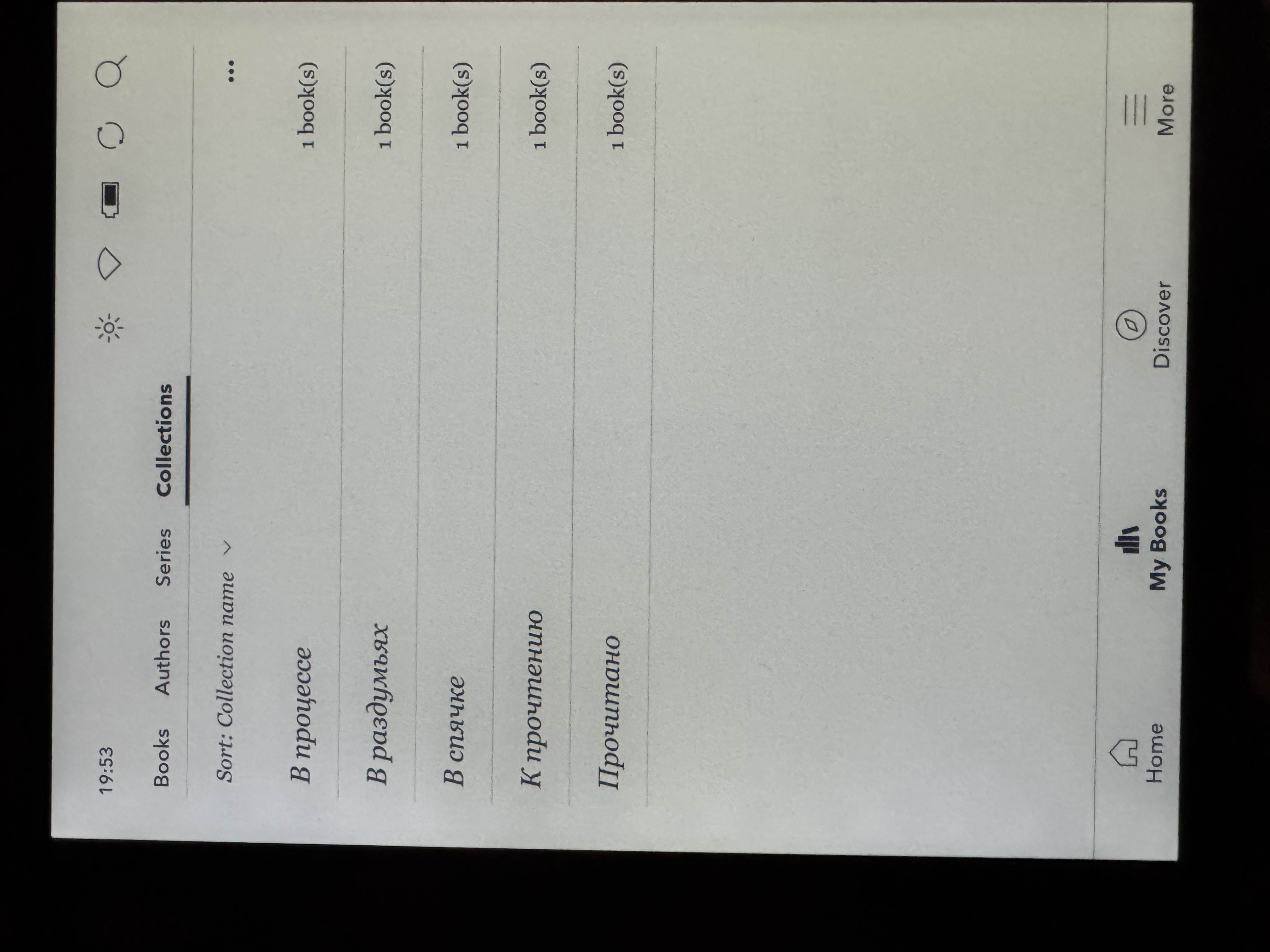

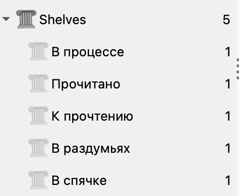

Originally Posted by baursak View Post
1. I set KoboTouch driver
2. I add a custom column
3. I mark 5 books with 5 different values and sync with Kobo
4. I get 5 Collections in Calibre
5. I get 9 (2+2+2+2+1) Collections on Kobo
So, it didn't work on my side, alas

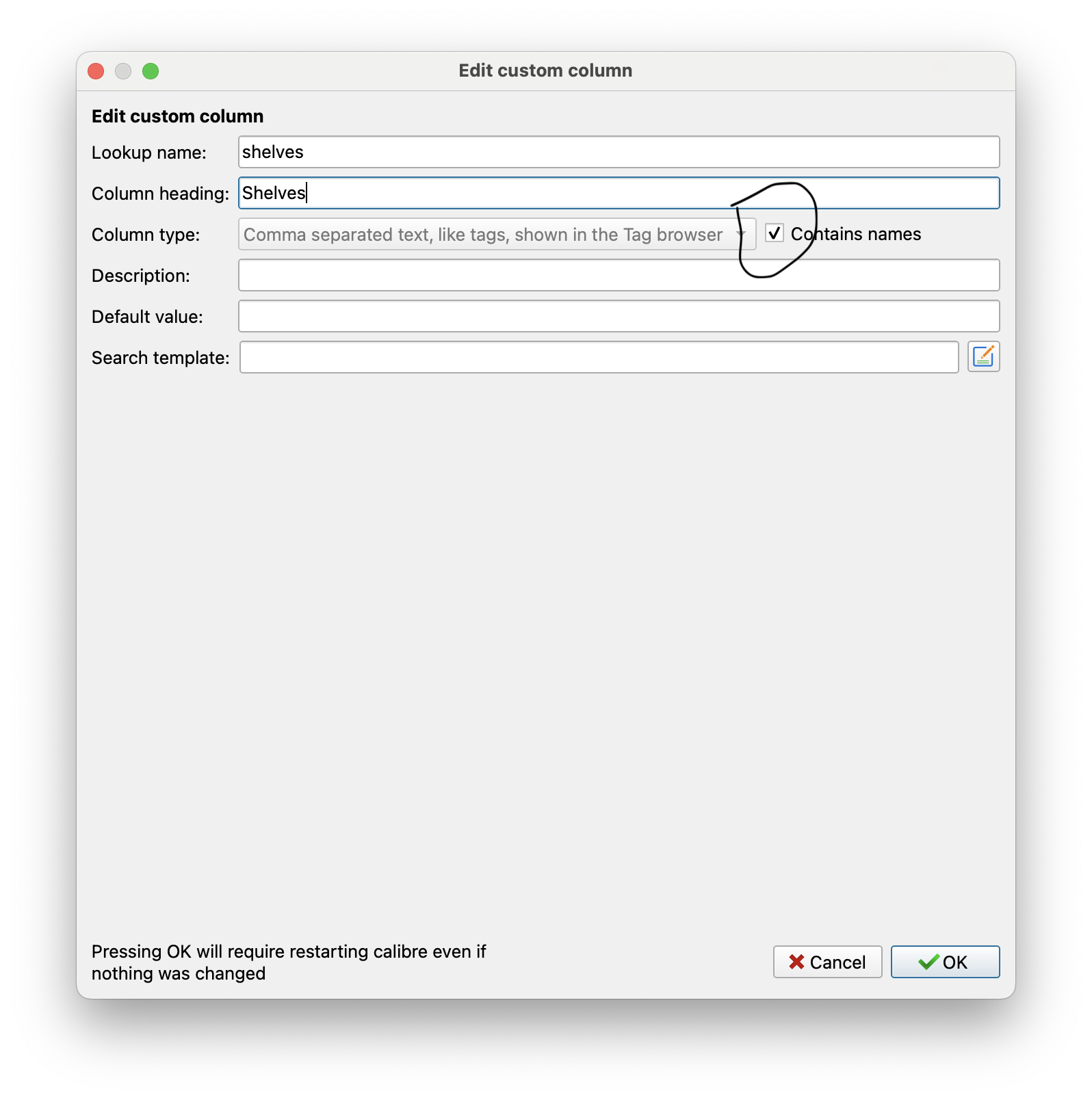

One check mark solved the problem. Now everything is OK.
I am no more afraid of factory resets, since thanks to you I know how to restore Collections and Reading positions.
Thank you ever so much again. God bless you

Posts: 56,060
Karma: 182882152
Nope. The Use Kobo viewer for EPUB books is the calibre 8+ equivalent of send kepubs for the KTE driver.
Old 03-25-2025, 09:00 AM   #21
Posts: 85,874
Karma: 154365287
No, it's 8.0.1.
Then it's a bug in 8.0.1 as there is no longer an extended driver.
Old 03-25-2025, 09:02 AM   #22
Posts: 85,874
Karma: 154365287
If you look at the first image, you'll see the option to switch between KoboTouch and KoboTouchExtended. That's wrong as the extended driver is no more.
Sadly, that came from the Kobo Utilities plugin. The plugin required an update for calibre 8+ so now the plugin will show Configure driver instead of the selection option. If you revert to an earlier KoboUtilities, you will see the Driver item but trying to select the KTE driver gives a non installed message.
A PEBKAC bug so to speak.

Posts: 85,874
Karma: 154365287
Thanks for that. I've never used that feature of Kobo Utilities.
