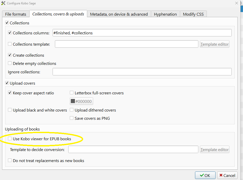

There are two icons: "Device" and "Send to Device"
I selected "Configure this device"; under "File formats" I deselected kepub.
Under "Send to Device" I clicked "Send specific format to main memory and selected epub, but it still uploaded the book as kepub

From the Device icon, you click on Configure this device or even if your device is not connected, you can still open Kobo Utilities, click on Configure driver to open the KoboTouch driver configuration dialog. On the second tab ( Collections, covers & uploads ) and remove the checkmark from Use Kobo viewer for EPUB books. See attached image.
So desu ka!
It worked ... many many thanks for your help. This was driving me nuts. I was just about to pull the remainder of my much thinned-out hair out.
