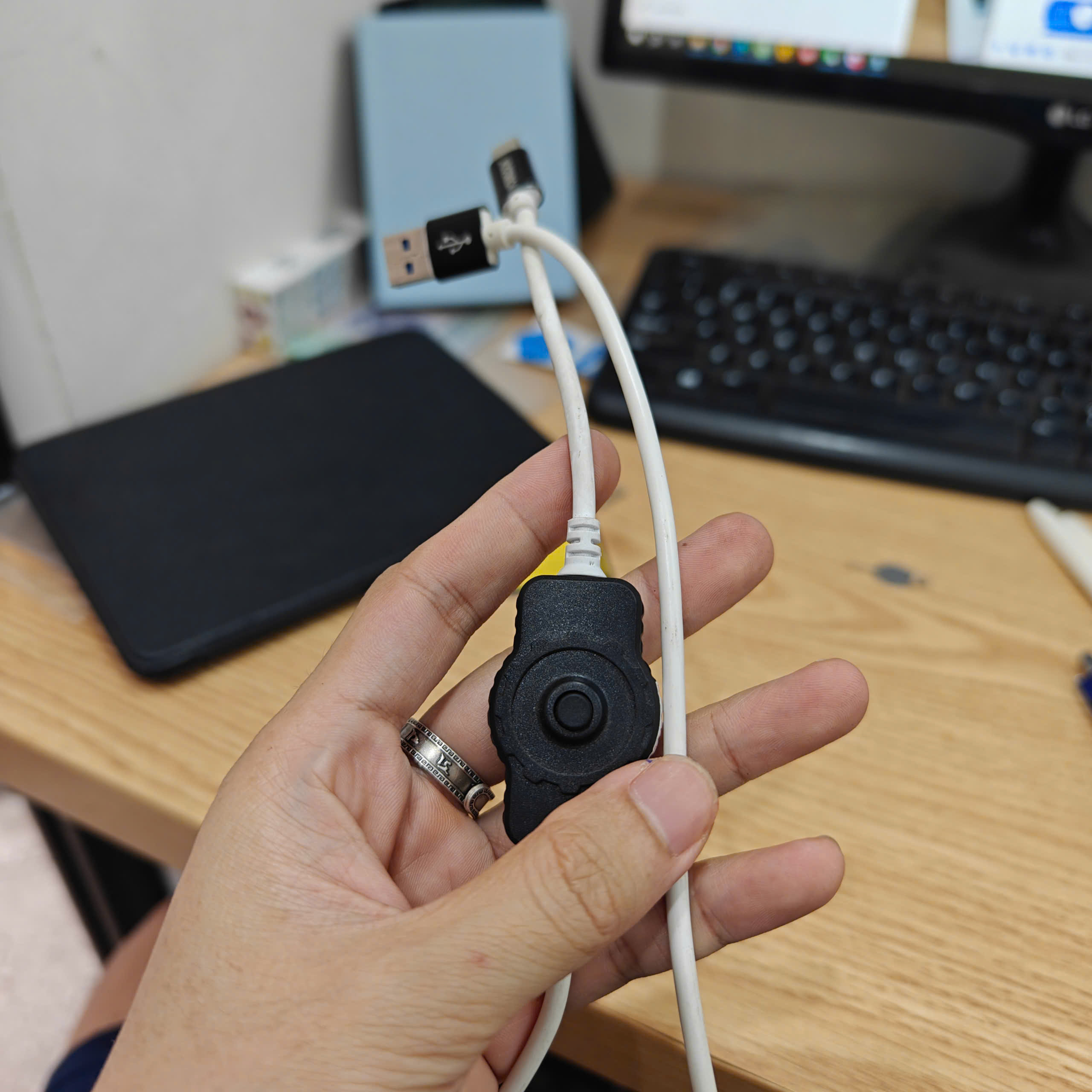

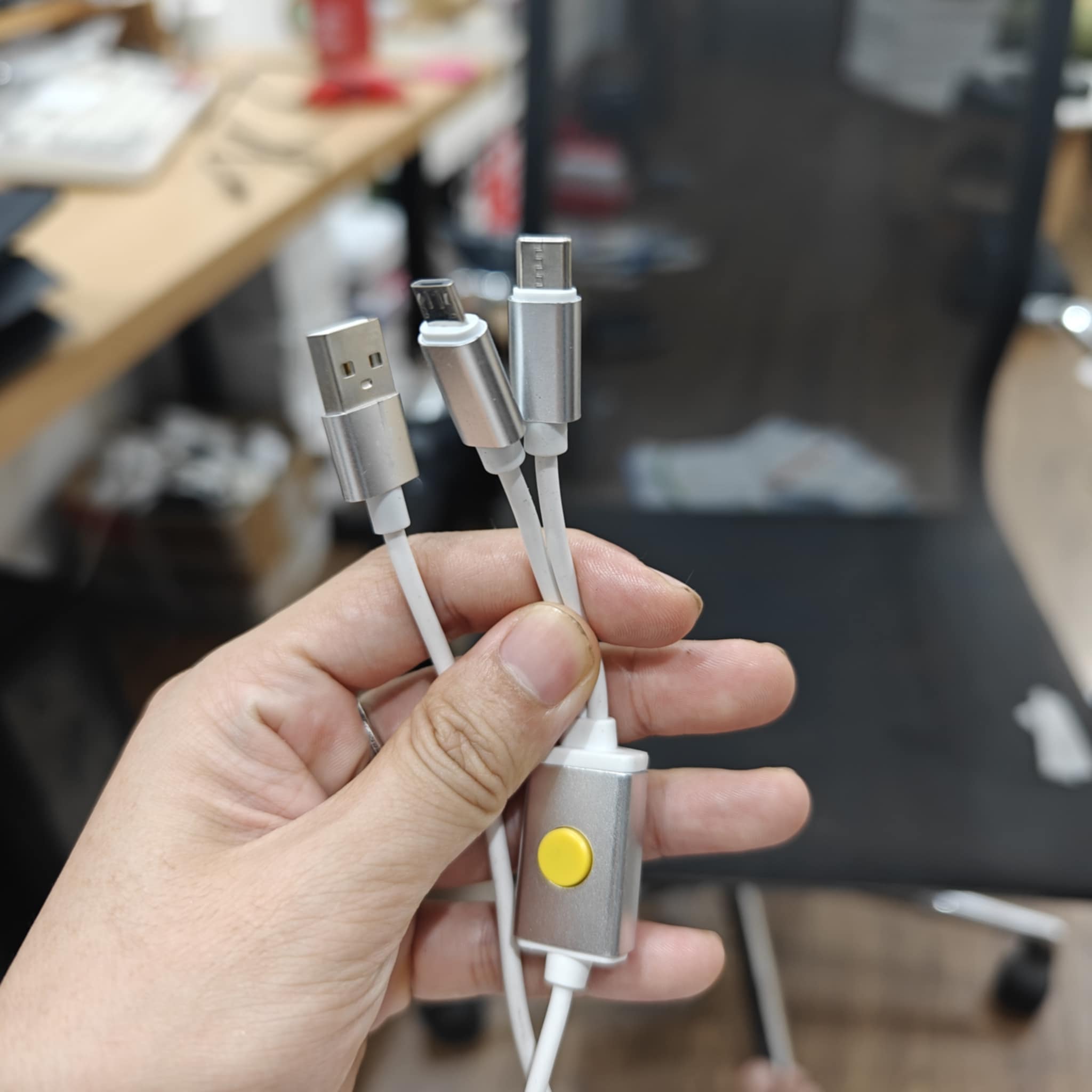

Yeah. But the problem is i dont know how to put my device to edl using edl cable. I have 2 type of edl cable (working, coz i have no problem using it to put my Xiaomi phone and tablet to edl)
I follow this instruction, but didnt success with any of my Boox devices
Boot to edl mode with edl cable:
The easiest usage is if the device is off already.
Plug the cable into the desktop, push the shorting button,
plug the cable into the device, wait a second, release the shorting button.
More awkward with a powered device.
Plug both cable ends in, push shorting button, push power button 10+ seconds,
release power button, wait a second, release the shorting button.

There could be any number of problems.
It could be going to 9008 and you're not seeing it.
I would trust the cable with the micro USB tail on it because it must be V1.
But I don't know for a fact that the TabMiniC does do D+ (V1) detection.
Onyx could have pulled it.

Originally Posted by vuanh1408 View Post
But the way to enter edl that I quoted is no problem?
Well, that's what I wrote so I am unanimous in it.
If your device has buttons there is also holding down buttons while it reboots.
A manufacturer can put whatever trickery they like in.
I've seem where you have to tap the top left and top right corners alternately.
I've seen where you have to send more than 50 (but less than 100) VT-100 backspaces to a UART.
They can also remove any shortcuts.
If you're really getting nowhere, you can open the case.
But I've seen both trivially easy and very sneaky EDL test points.
