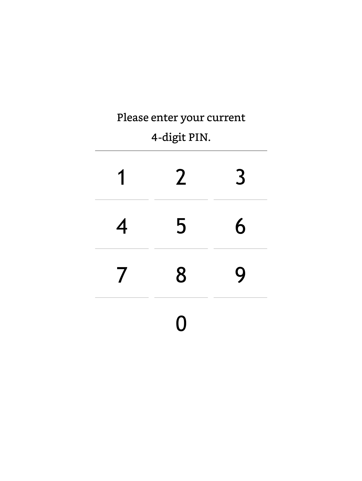

If BaseAddress: 0x19A24ED isn't working for patch Remove forgot pin button from lock screen, try this offset instead:
BaseAddress: 0x1999992
Nickel has 2 CSS resources, ParentalControlPinCodeVerifyView.qss & PinCodeInputDialog.qss, which contain identical CSS code. This patch is aimed at the latter. It's easy to confuse which offset is which.
Originally Posted by Semwize View Post
Yes, I saw it. Even check it out, although it's wrong. Does not work.
It's not clear what it doesn't work, I don't see any reason.
@Semwize, I'm not sure why you think BaseAddress: 0x1999992 isn't working for this patch.
This is what I see on a Libra2 when I wake it up from sleep after I've set a PIN code. That's working, isn't it, i.e. absence of "Forgot your PIN? Sign Out" message at the bottom of the screen.

Thanks @jackie_w: 0x1999992 as Base Address is working!

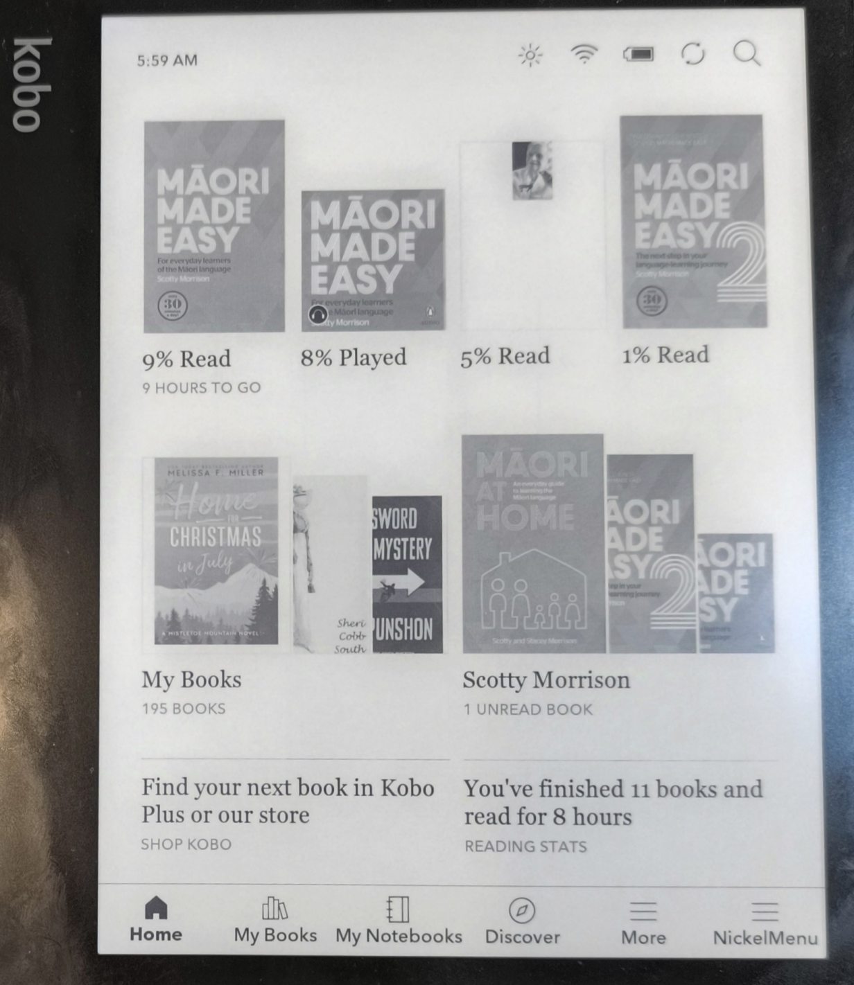

One patch would appear to be not working on my Sage:
Remove footer (row3) and increase cover size on new home screen: yes
I first tried the two separate patches, and then the combined one, but the end result is the same, as shown in the attached image. kobopatch doesn't fail, and the other patches I enabled all seem to be working, how do I get this one to work?

All of the patches I use worked.
Did this patch work on your Sage? As I posted above, I can't get it to work on mine, I'd love to know why
