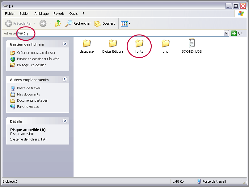

since i've had a few questions about this procedure i decided to add some screen caps to make the process clearer to people who are less experienced. detailed instructions (including all the css code needed) are in post 9 of this thread (thanks llasram !!).
(click three times in a row on the image to see it at full size)
1. connect the 505 / 700, and open the folder

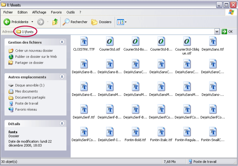

2. create a new folder called "fonts"
3. put the font files inside this folder
