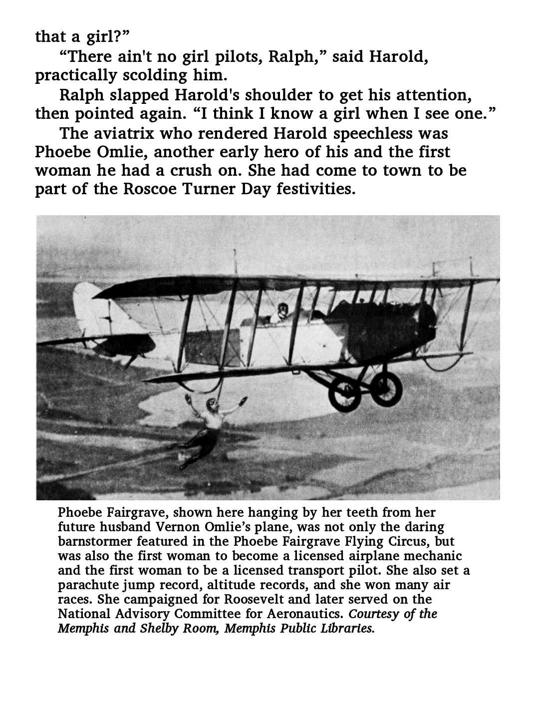

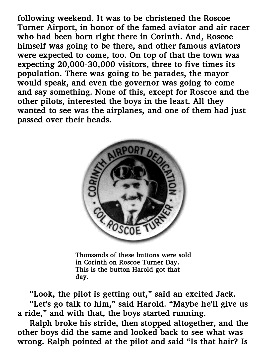

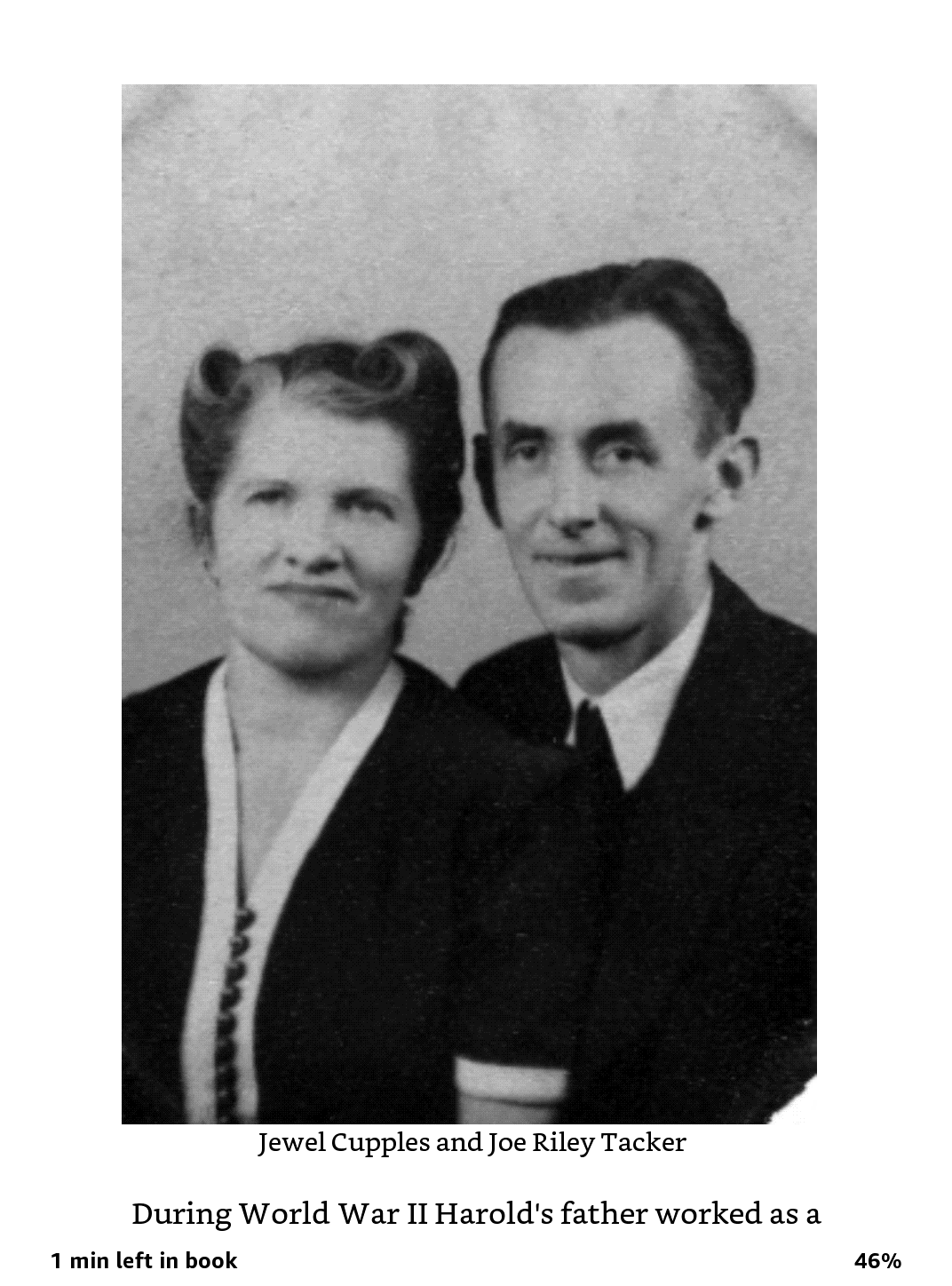

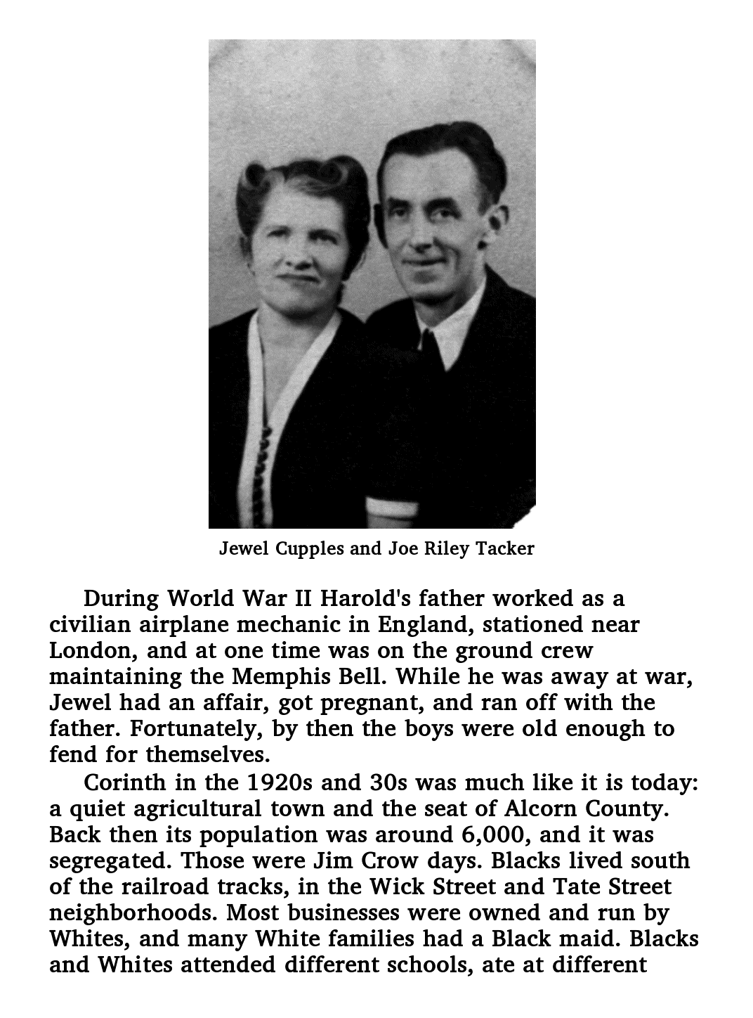

When I generated an azw3 in calibre and sent it to my Kindle PW4, the header font showed. The images sized properly. I also tried using Kindle previewer to generate it's dual mobi output (a mobi and a azw3 in the same file). I split the mobi and azw3 in calibre using KindleUnpack. The azw3 worked okay on my PW4 but the mobi showed the image oddities and lack of fonts that you were mentioning.
Vertical centering text generally ends up needing to use a table. To vertical center an image alone on a page, you can use a svg wrapper. There are other techniques but they depend on having the renderer support that code.

The first two thumbnails show the photos correctly sized, but the other two, not so much. The left margin of the airplane photo should line up with the caption below it, for example. Again, the problem is only for photos displayed over 50% width. I did an experiment earlier using 10, 25, 40, 50 60, 70, and 90% widths and only those 50% and smaller displayed correctly.
I'm using a Kindle 11, and I've began to think that it is the problem with fonts and photo sizes. One would think that being this far along in the ebook universe that the various incompatibilities people are constantly pointing out would be a thing of the past by now.
