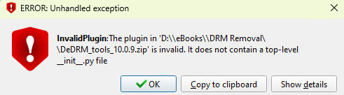

Found out how to get the plugin but I get this

OK, had to unzip and use the zip in the unzipped folder

And able to convert, thank you for your help everyone..

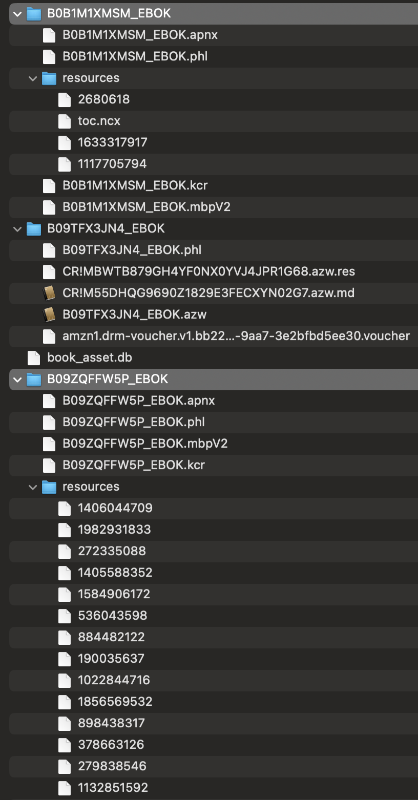

Hello! New here and would appreciate your help. I'm not very tech savvy, so sorry in advance. I've been following people's recs, and using the appropriate versions of Kindle for Mac and Calibre. I've managed to remove DRM on all of my e-books, except 2, which did not include the azw file for some reason. I've tried removing and redownloading the ebook to no avail.
The two books I've highlighted are the two that are missing this file, but as you can see the middle book contains the file.

Unfortunately, those two books are downloading as .kcr instead of .azw, and .kcr doesn't work with DeDRM. You'll need to use a different method. Do you have an eink Kindle or access to Kindle for PC?
I'm curious, though, why these two books are downloading as .kcr. There have been reports of Japanese language books downloading as .kcr on Kindle for Mac because of the vertical text, but these titles appear to be in English. Perhaps they have some vertical text inside or something else that causes Kindle for Mac to use .kcr
I wish I could tell you. I've completed over 800 book conversions - I used "manage my content" and had the books mass dl'd to my Mac. Just tested it out on my phone and they look like standard books.
I do have a Kindle PWSE, just got it last month, but no PC. I'd have to ask and see if a friend would let me use their personal PC.
Thank you for your time. Much appreciated!

If you have Kindle PWSE, this is much easier. Use Method 1: Download & transfer via USB from here: https://www.mobileread.com/forums/sh...d.php?t=361503
Be sure to enter the serial number of your Kindle into the DeDRM plugin. You can find and copy & paste your Kindle serial number on Amazon website under your Devices.
