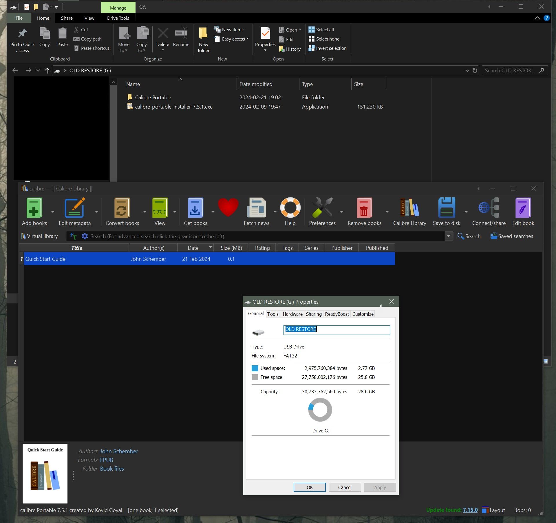

AFAIK a calibre library can be on any file system that the host OS supports, and Calibre for Windows (Portable) is the same, here it is on a FAT32 drive:
Name:	Screenshot 2024-07-21 085604.jpg
Would I recommend it? Only as a one off short term solution to address a specific issue.
