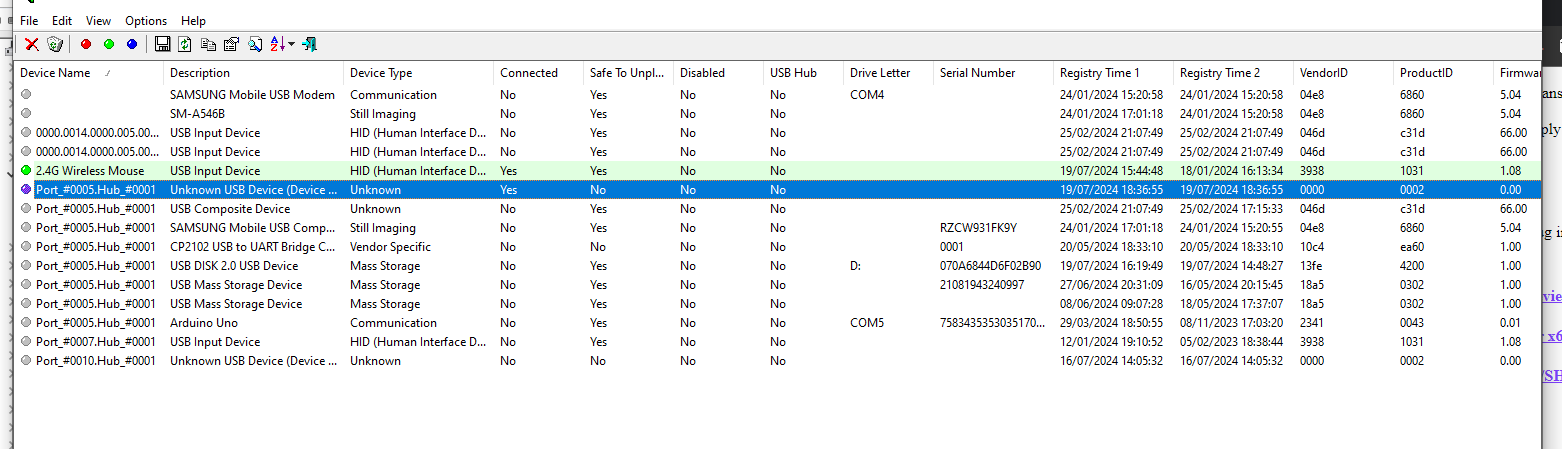

You might want to check if you have any devices in Device Manager that are in an error state or listed as an unknown device. You will likely need to enable show hidden devices to see most of them. You may also want to check out NirSoft's USBDeview.

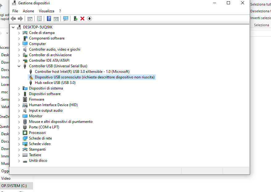

when I plug it in it gives me this error (see attached photo)

I would suggest uninstalling the error device and then restarting your computer.
now it doesn't even show me the error, it doesn't work.
