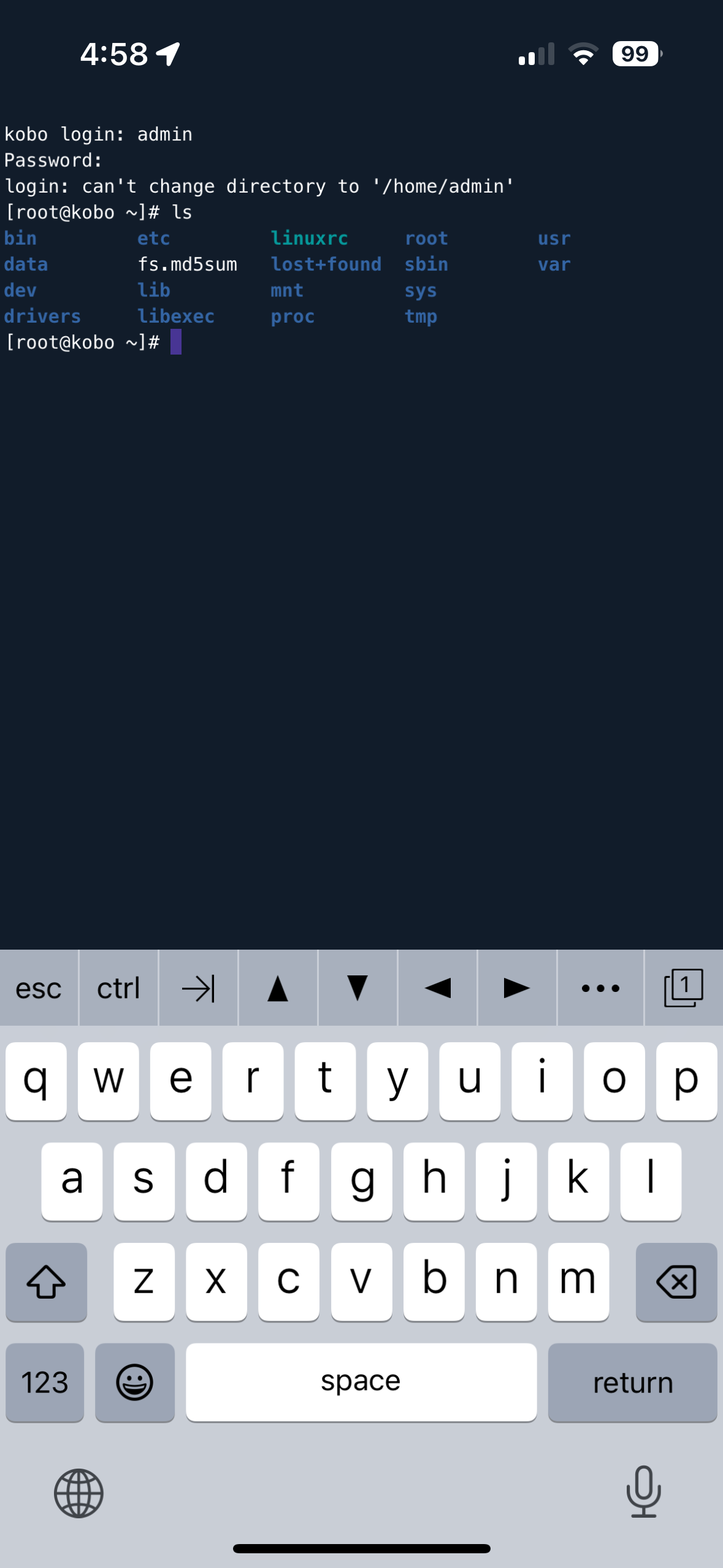

Try using 'admin/admin' instead of 'root/.'.
Thank you. That did the trick. When you first login, you get the warning that you see at the top of the screenshot. Since I’m finally in, I’m going to look into the Wi-Fi card issue first before worrying about the warning.

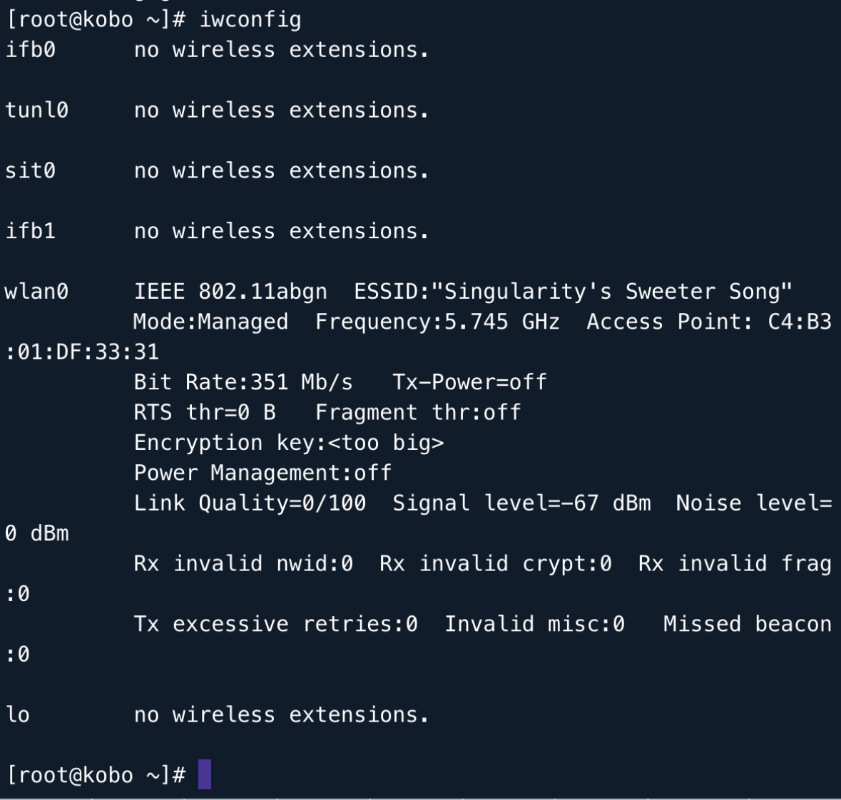

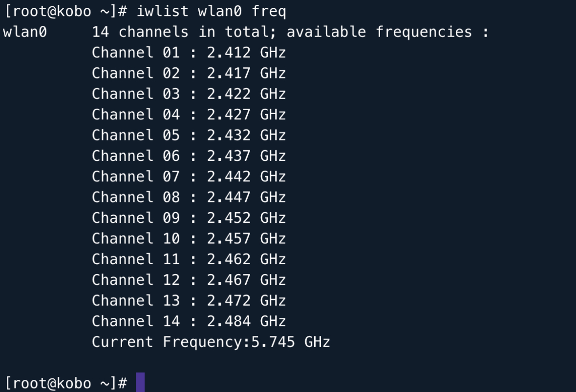

To get back on track to your original suggestion after quite the journey, I can report the following:

According to comments in that article from 2014, iwlist is considered old and has been replaced with iw, which is not installed on the Kobo. I’ll put a pin in that one for now, but you can clearly see that I’ve connected at 5 GHz.
The question is, what did I do to fix it? All I did was reboot a few times as I removed nickelmenu, and then I added nm back. I also did a database repair. None of those are related to Wi-Fi. Initially, I blamed the correlation of sluggish and forgetful Wi-Fi troubles to nm because the problems went away when I removed nm. I also had troubles with the Libra Colour intermittently not mounting on my iMac. That has also cleared up. Perhaps the several cold power cycles that I did repaired whatever issue was at fault.
I appreciate everybody’s detailed feedback, as well as your willingness to educate me on new aspects of Linux without being snide. I wish I could definitively point to what I did to fix this issue to be of use for others who come upon this thread.

Interesting! I wonder why the channel list does not contain any 5 GHz entries. If you're really connected at 5 GHz, you'd think that there would be a 5 GHz channel in the list. Are you running both 2.4 and 5 GHz, or did you disable 2.4 GHz for testing purposes?
As far as commands go, Kobo uses BusyBox, so you're limited to the commands it supports, unlike with a full Linux distro. Thankfully, at least iwlist is available for diagnosing this.

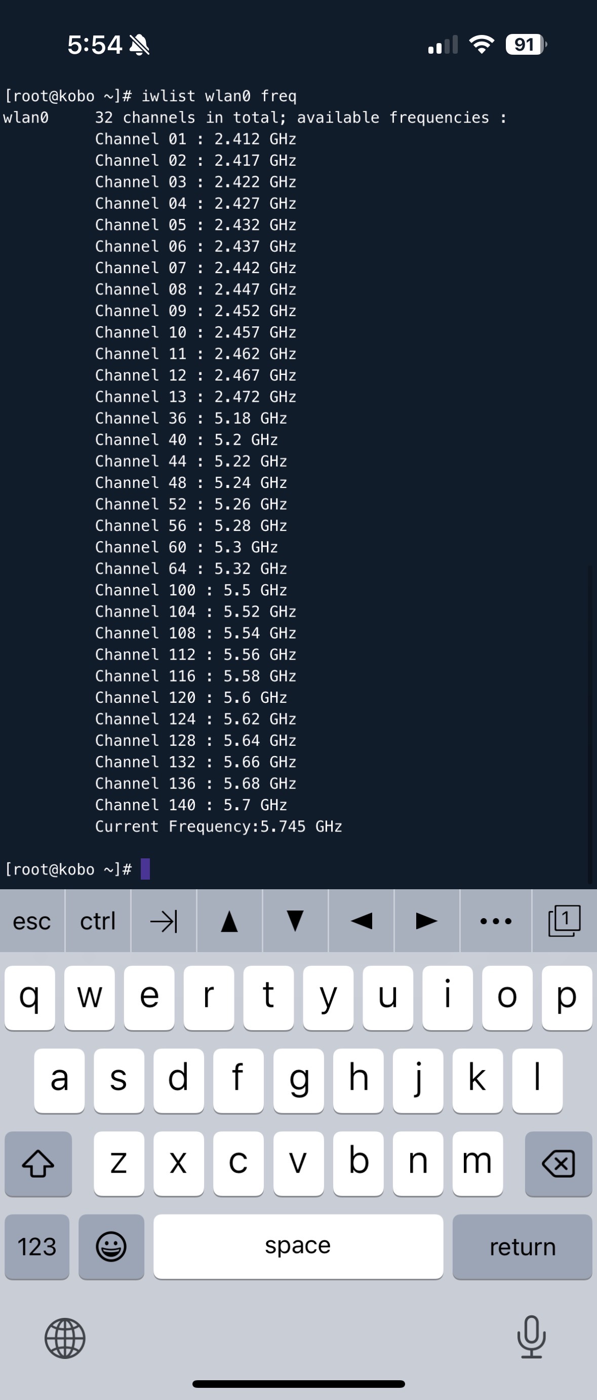

Now that I provided the information you originally suggested that I look for, I turned my attention to my Kobo Elipsa to see if I could login via telnet. I had recently logged back into my main account on it after using my Japanese account, so dev mode had not been reenabled yet. The nm installation had persisted between accounts, however.
1) Attempting to telnet into the Elipsa with neither dev mode nor telnet through nm enabled failed, as expected.
2) Turning dev mode on did not allow me to telnet into the Elipsa. As far as I know, this has always been the case for me. That’s why I looked into nm in the first place years ago. I am running firmware 4.38.21908
3) Enabling telnet via nm allowed me to successfully telnet into the Elipsa
Then for giggles, I enabled sideloaded mode. After successfully entering that mode, and with devmode enabled, I still could not telnet unless I enabled telnet via nm. I don’t have a Kobo with the earlier firmware installed on it, and I have saturated on this particular problem, so I’m unlikely to downgrade my Elipsa’s firmware to compare. at least not today.
I hope my descriptions were thorough enough for you to follow along.

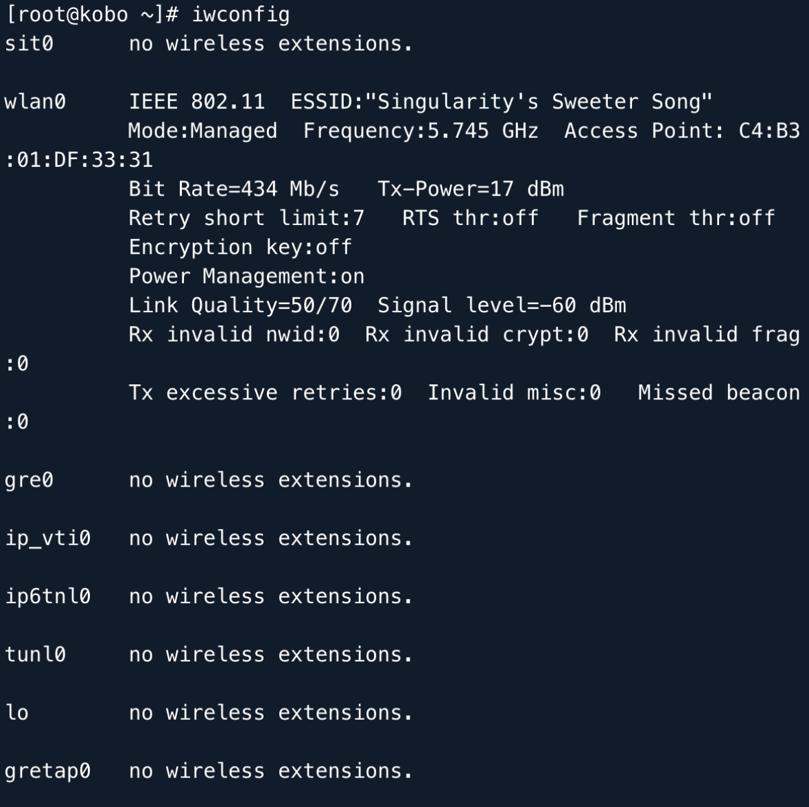

Now, to get this back on topic, here are the iwconfig & iwlist results for my Elipsa.

Notice the full list of channels compared to the Libra Colour’s results. I wonder if there is something here to point to this intermittent WiFi connectivity issue.

I didn’t see your reply because I was busy working up my Elipsa entry. As you see above, I also wonder about why there are no 5 GHz channels showing up in the Kobo Libra Colour list. I can’t help but think that this is related, but it’s a bit outside of my skill set.
No, I didn’t. Could you tell me how to do that? If you mean on the router, I can figure that out. I have an older apple airport on a subnet from a Netgear Wi-Fi six network which is upstairs. The Netgear multi broadcasts one channel which is capable of both 2.4 and 5 GHz. The Apple airport has two separate networks for 2.4 GHz and 5 GHz. Initially, the Libra Colour couldn’t even see the 5Ghz network, nor could it join manually. I haven’t tested with the Netgear network bc it’s spotty from my bedroom.
If you mean on the Kobo, I’ll need a bit of guidance.
