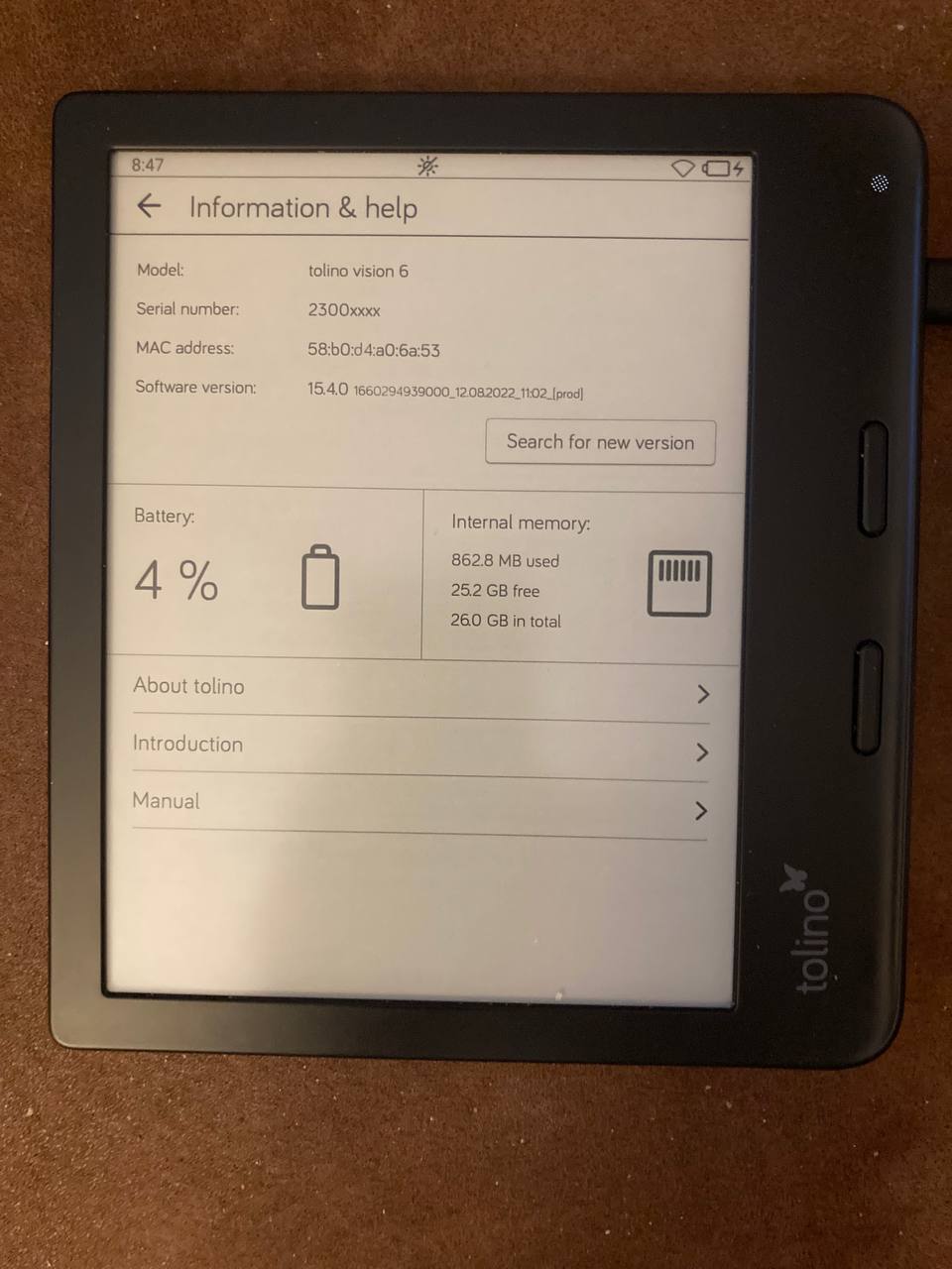

Hi everyone
I've got a bootloop after updating to 16.2.1.
Previously, I've installed twrp. Image on screen is freezed.
LED is periodically blinking.
It's possible to boot in fastboot.
On windows it's recognized as Kedacom USB device (KDB composite interface).
Reverted back to stock recovery, but can't boot there.
Could someone send my an SD-Card image for 37NB-E70P1M+6B2 ?
Thanks !)

Old 01-02-2025, 08:05 AM   #25
Waldy
Waldy ought to be getting tired of karma fortunes by now.Waldy ought to be getting tired of karma fortunes by now.Waldy ought to be getting tired of karma fortunes by now.Waldy ought to be getting tired of karma fortunes by now.Waldy ought to be getting tired of karma fortunes by now.Waldy ought to be getting tired of karma fortunes by now.Waldy ought to be getting tired of karma fortunes by now.Waldy ought to be getting tired of karma fortunes by now.Waldy ought to be getting tired of karma fortunes by now.Waldy ought to be getting tired of karma fortunes by now.Waldy ought to be getting tired of karma fortunes by now.
Waldy's Avatar
Posts: 269
Karma: 267515
Join Date: Jun 2017
Device: Tolino,Kobo,Onyx,Kindle,BN,PB,Likebook...
Originally Posted by Yuriy View Post
Hi everyone
Thanks !)
I can't send you a private message.
https://www.mobileread.com/forums/sh...d.php?t=319819
Waldy is offline   Reply With Quote

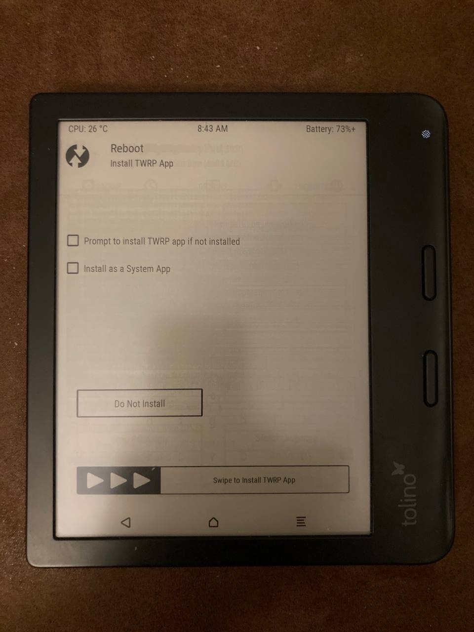

Device: Tolino Vision 6
It worked, thanks !)
The only issue - serial number.
I've also tried images for Kobo N418 Libra 2 vE - no success, even no led.

Old 01-03-2025, 08:14 AM   #28
Waldy
Waldy's Avatar
Posts: 269
Karma: 267515
Join Date: Jun 2017
Before flashing the card, edit the image, for example, HxD editor, entering your serial number, if this is important to you.
https://mega.nz/file/2BsV2abK#T2KpTX...sxAtZW6IRHLrzQ
From Kobo, a similar device in hardware is Sage. I created an image from it, but it also does not work on either Vision 6 or Shine 4.
