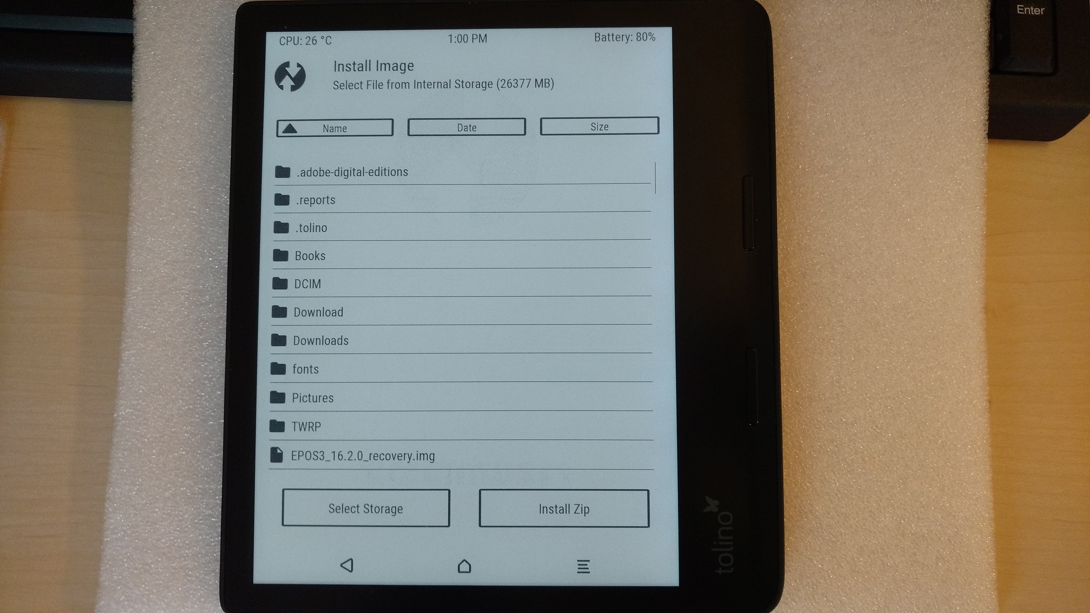

I tested twrp-epos3.img briefly on Epos 3 and it seems to work.
However, when Epos 3 is connected to a PC, it exits TWRP and boots the system.
(The same thing will happen with Shine 4 + TWRP for Vision 6, I didn’t immediately pay attention then.)
I would like to thank you for your work and really appreciate you devoting your personal time to solving problems.
OK that's at least something
Great... but the Vision 6 is fine?
So you mean you start recovery without the tolino being plugged in to the PC (btw how do you even do that??) and then later you plug it in to the PC and then it basically crashes and reboots? That sounds really bizarre...
Can you send me the contents of /sys/fs/pstore/console-ramoops-0 (or basically all the files in /sys/fs/pstore/) right after the reboot? Maybe there will be something useful there.
Also /cache/recovery/last_log.gz and /cache/recovery/log.gz (if there's anything else there that looks interesting...)
The kernel is identical for the Vision 6 and Epos 3 (at least in recovery based on what you sent me)... so unless it has something to do with MTP mode or something barfing over that I'm stumped... does the crash happen immediately? What happens if you keep the tolino plugged in the whole time? works ok? crashes right away?

iscilyas began at the beginning.
Posts: 17
Join Date: Mar 2024
Device: Tolino Vision 6, Kobo Aura H2O
Originally Posted by litrpguy View Post
I can try it on my wife's GL 4 if you're still looking for a tester
hey @litrpguy
that's great! thanks!
you can get it from here
https://github.com/iscilyas/tolino_b...3.0-glowlight4
(flashing should be the same as what @waldy explained before)
if you're already using @Ryogo-X's twrp release, the main difference with mine should be that MTP works (device storage shows up as "disk" on windows)
BTW, if you haven't done so already (since you were one of the earliest testers... and i should have tagged my releases "alpha" etc) you really ought to flash a newer release of twrp for the vision6 (latest v0.3).. if you're still at 0.1 that's broken and might crash when plugging in
iscilyas is offline   Reply With Quote
